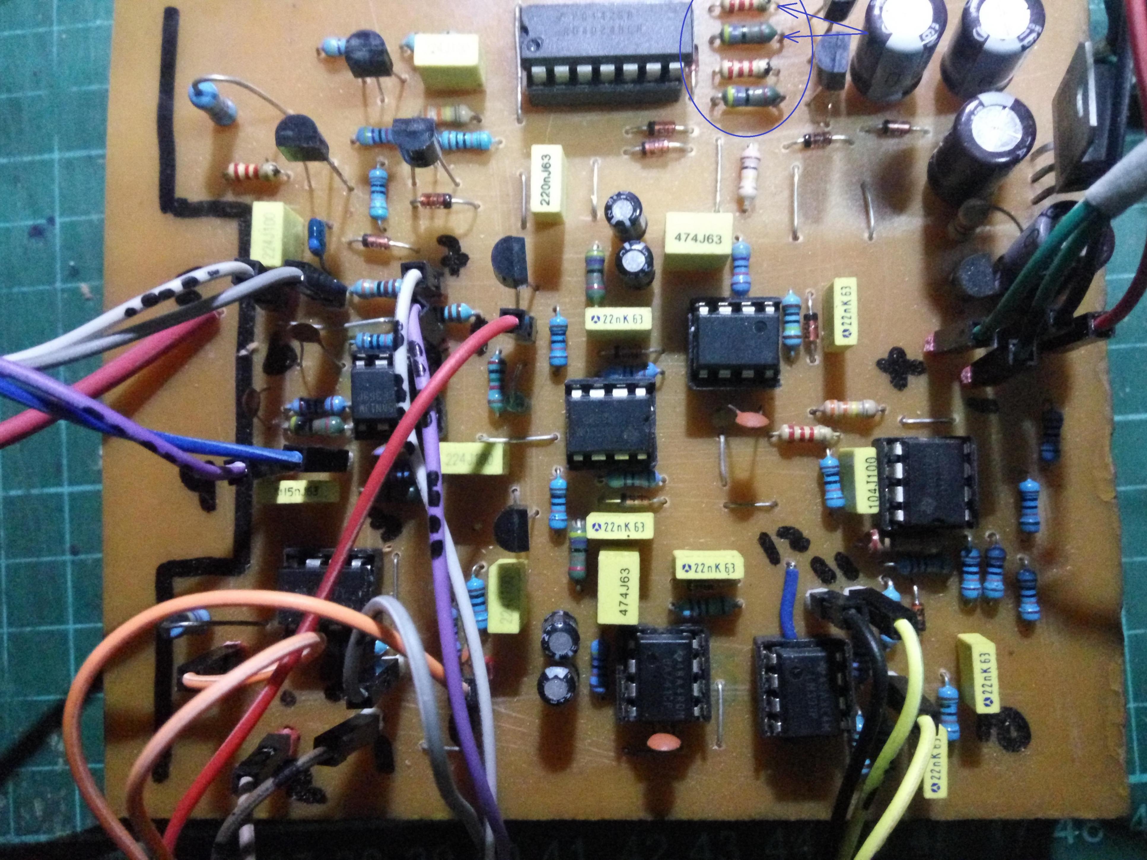

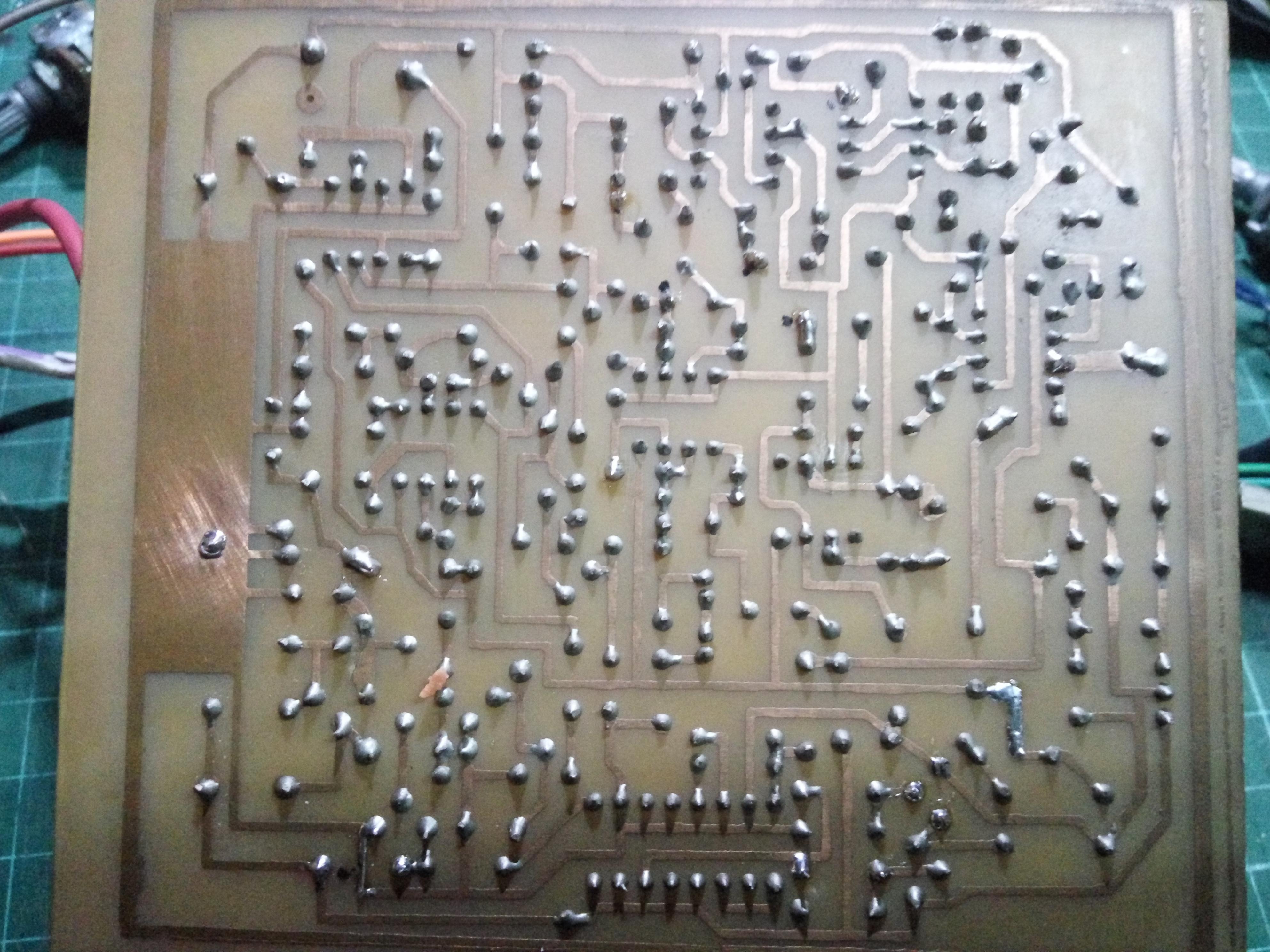

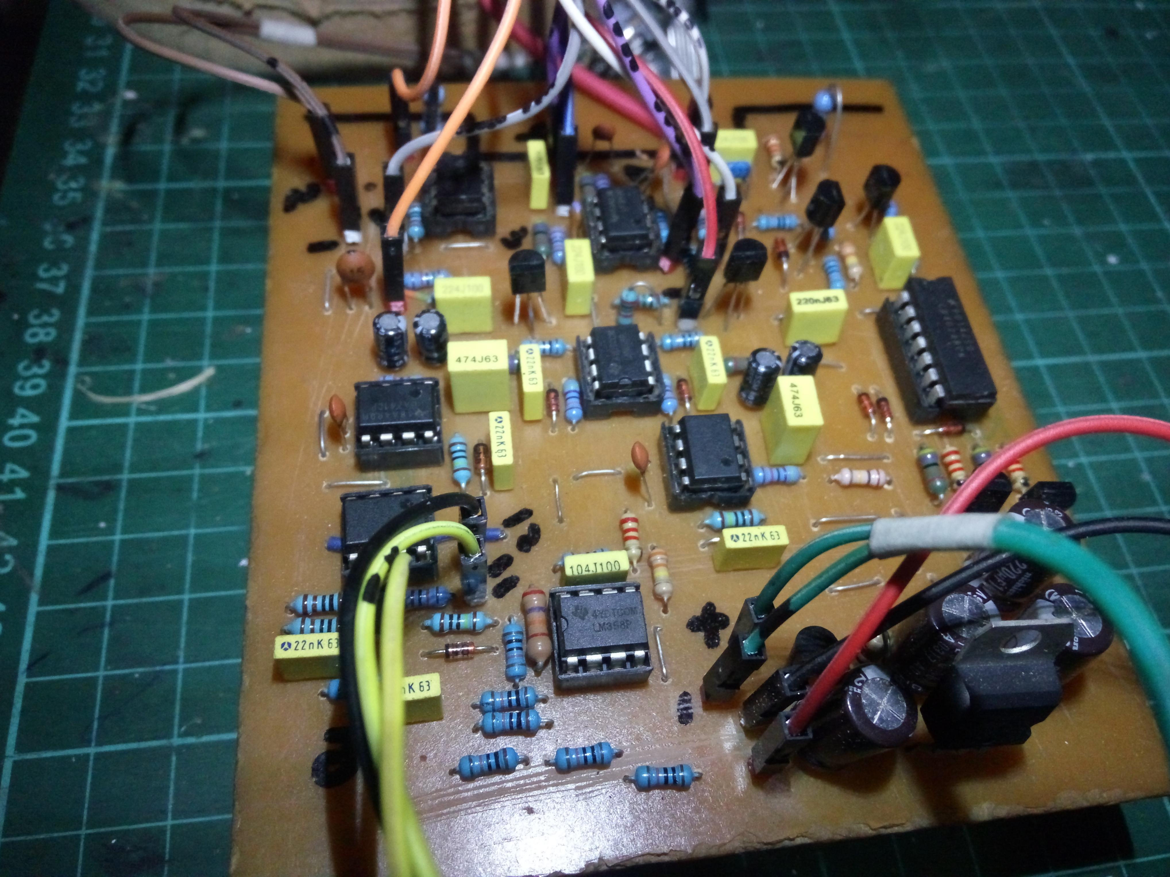

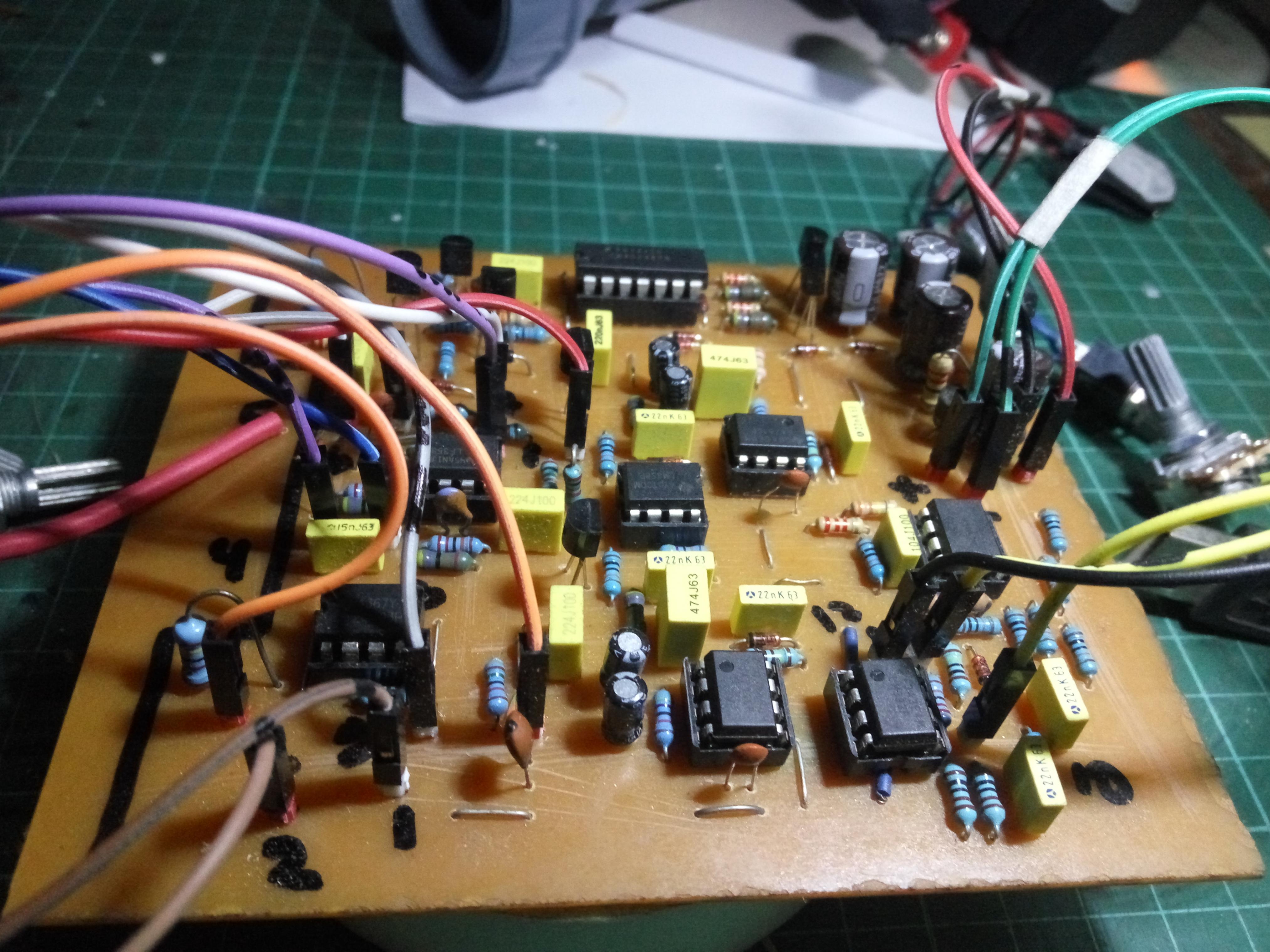

    Can make 2 - 3 pictures from bottom and top sides, maybe u have some stupid mistake?
    • #62
      Not yet change anything, I dont have long ferite, 5cm ok?
      PCB
      Top
      Side
      Bottom

        No its not reject ferrite rod, reduce geb, now its reject it

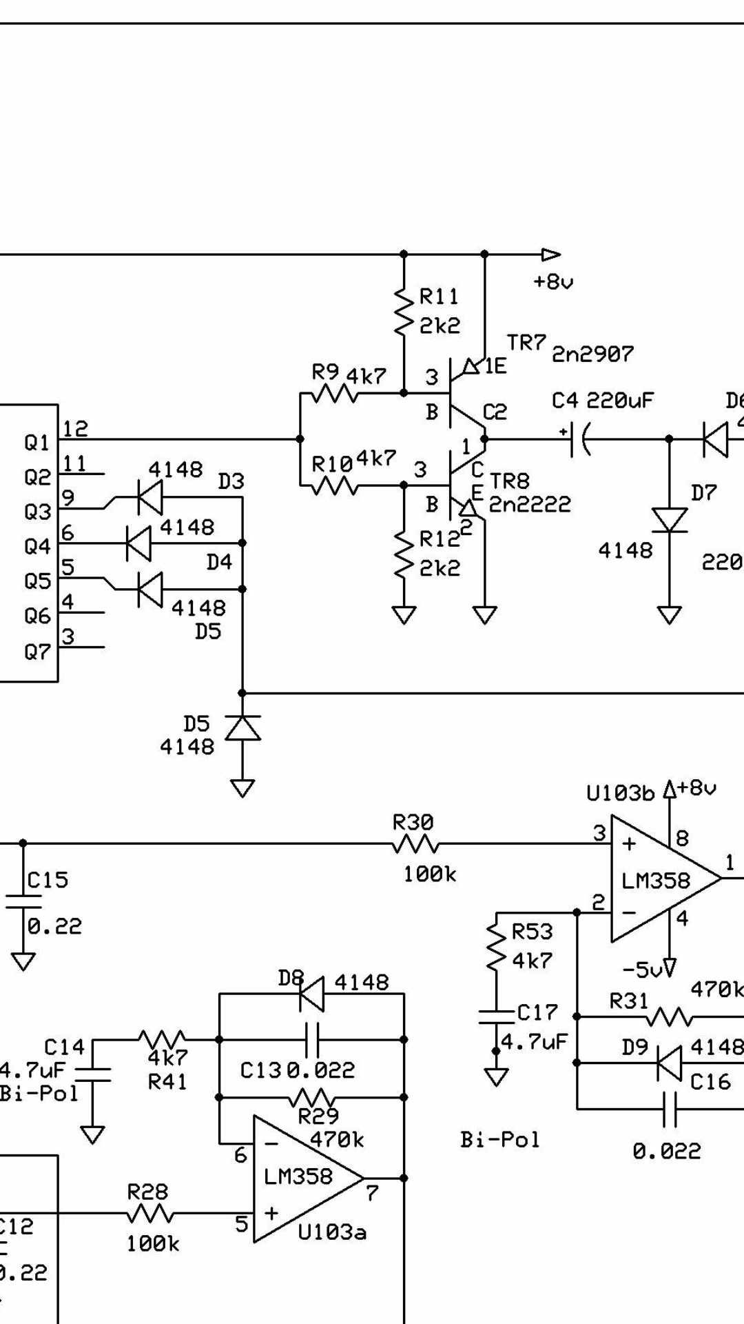

        • #64

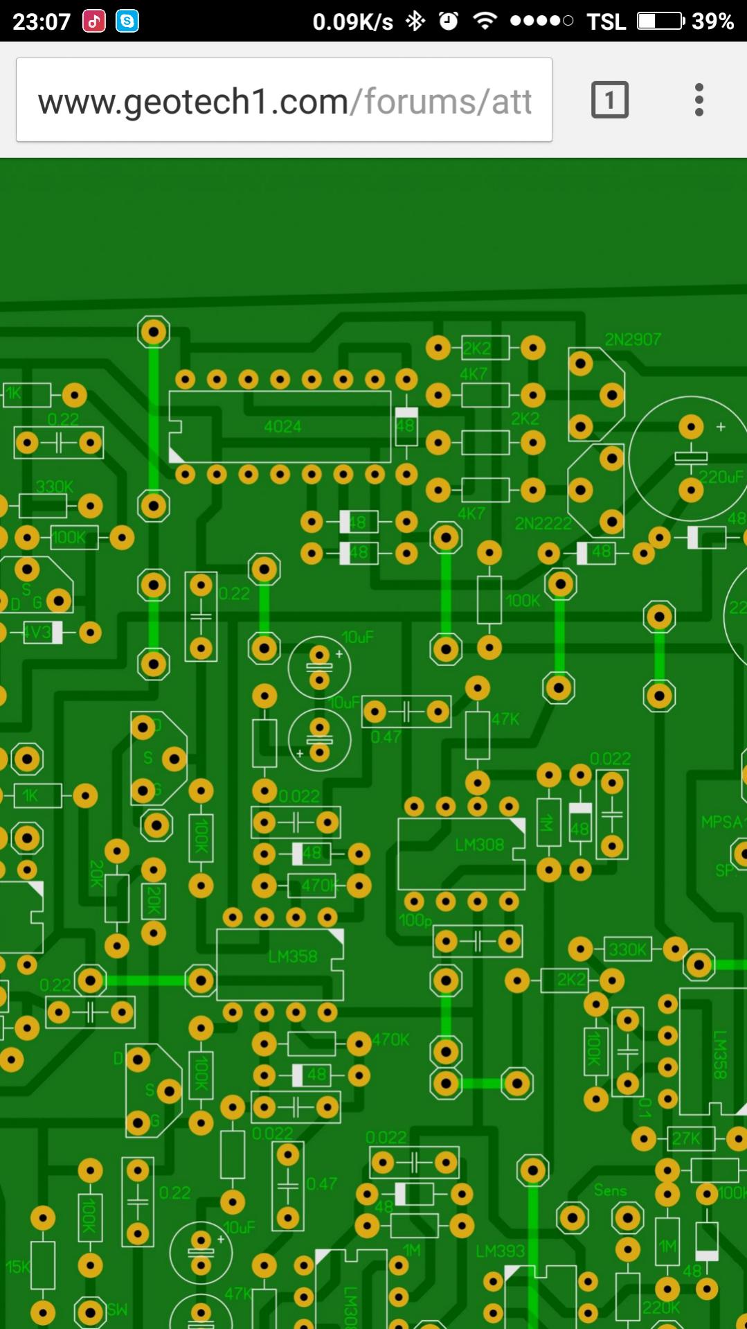

          This is one mistake for now:
          Reverse places.
          • #65
            Let me change that...
            • #66
              [ATTACH]36814[/ATTACH]
              Reverse places.
              Nothing changes..

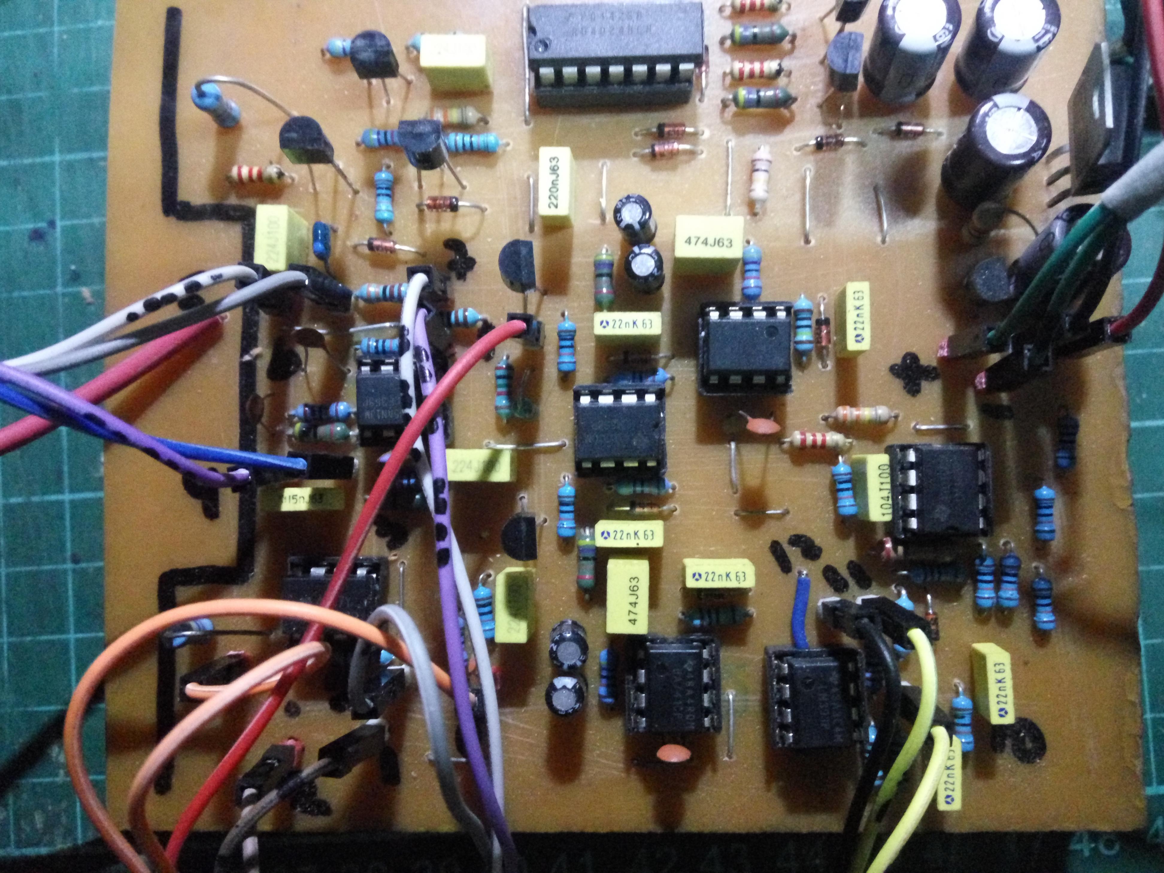

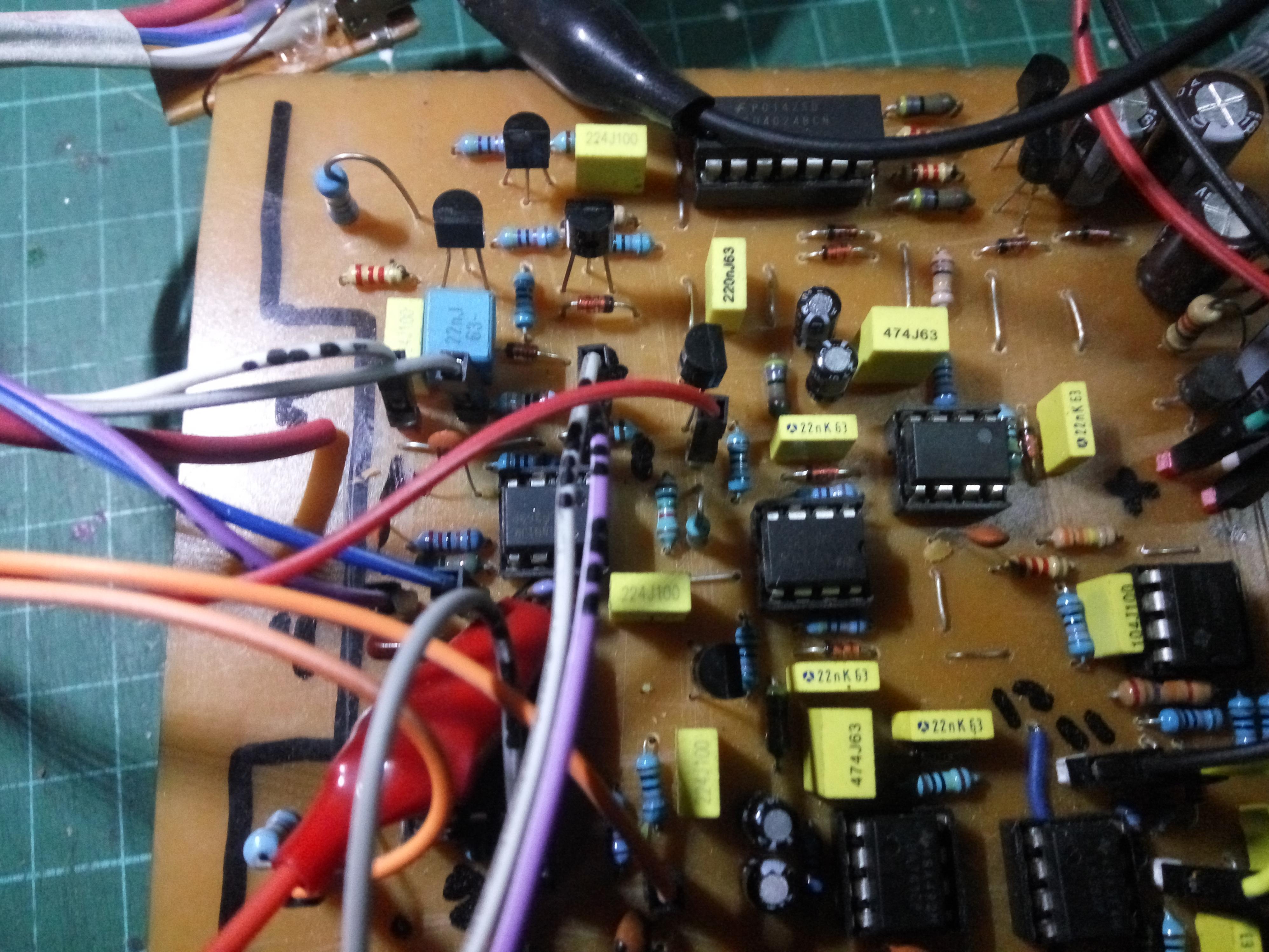

              • #67
                Can u tell me about blue multilayer capacitor in TX stage, what value is? And try to replace that capacitor with some polyester type.
                • #68
                  Just change 15n Rx capacitor to 10n nothing change.
                  Blue caps is 223 = 22n.... poly ok
                  • #69
                    Done... nothing changes
                    Info: my alkaline batt when turn on tgsl is 10.9v
                    Its already late here 00.00, I will go to bed now, thanks for the support CDI
                    • #70
                      Dont thank me, i had those problems since i begin to build my first md, and that first was exactly tgsl which didn't worked first time. It has constantly beep sound. As beginer lived that and tried to make surf pi. After 4 surf pi machines i back to find my problem with tgsl. Guess what i did wrong? Bad solder on RX minus wire, only that.
                      Btw, about battery. As i said find some stronger aku from motorcycle or UPS for pc. Should be perfect for testing purposes.
                      U didn't say at all do have now double beep when moving coin across the coil?

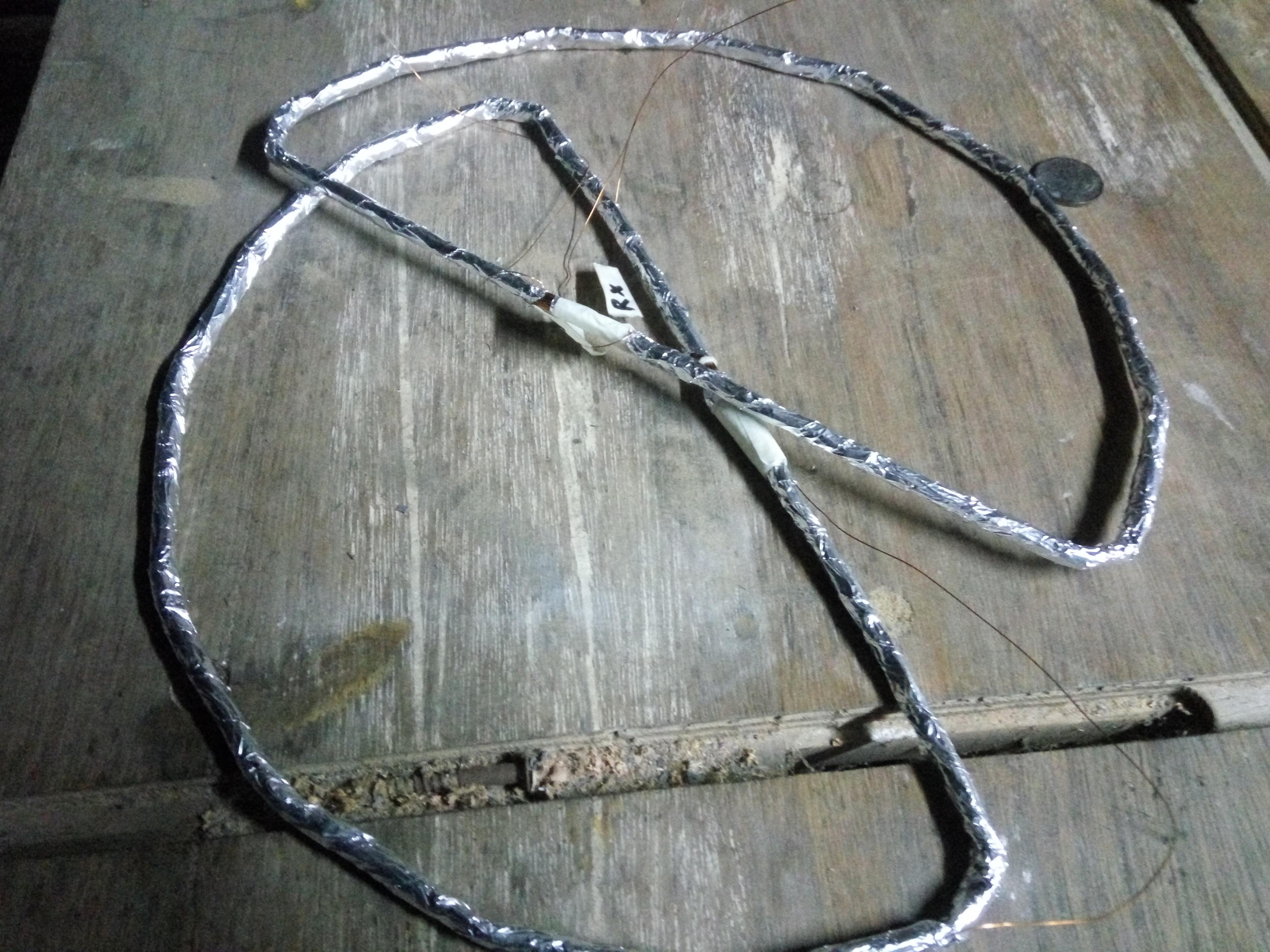

                        Good day all,
                        Continue my progress, now i change a 10x AA fresh battery 15.9v.
                        Double beep is gone after make ground to j1-2 coil
                        Still get 15cm, any sugestion?
                        - i think i will make a new coil to compare..
                        • #72
                          That's my sugestion too. Make another coil.
                          • #73
                            Mehh... im short of wire, only made RX, let me buy some
                            • #74
                              Use old TX coil and try with new RX before u buy new wire.
                              • #75
                                Too late... already make a pair
