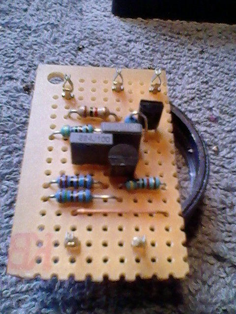

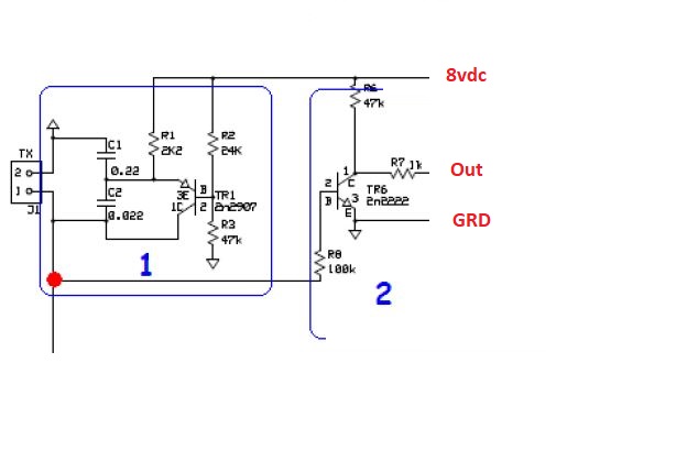

    Built copy of the Tx oscillator in order to mess with some coils prior to my build.
    The thing refuses to Sing. How is it suppose to be getting the Feed back to Ring ? I don't see it. Via the Ground or Plus Power line?

    Well I got it to sing. Issue was crummy Working but sick used Transistor. LOL

      i was playing about with one to had the same problem some times it was hard to get it started. i was going to use a arduino to do he switching for more control
        I had the 2N2907 as described but it wouldn't even sputter. Replaced it with a 2N3906 and lit lights right up. After that I think That's what I'll use in the build. I have a bucket load of the things.
