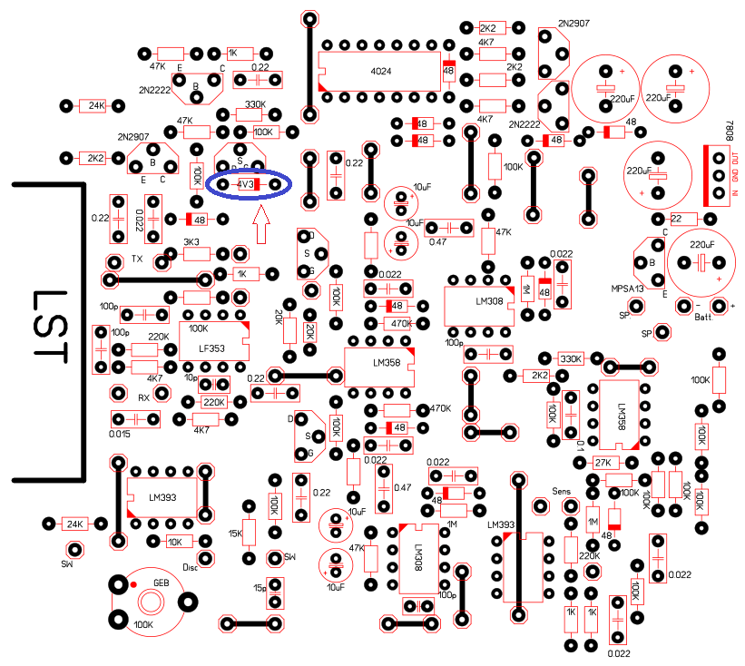

    Hello, I'm finishing my TGSL project,
    and on the wiring plan I have, there is a diode 4.3v and I wonder if it's the right diode? if it's not a 4148?
    here is the chat link. http://www.geotech1.com/forums/showt...98-TGSL-prints.Click image for larger version
Name:	Capture cablage TGSL.PNG
    This is a Zener Diode 4,3 Volt.
    You could use the one transistor oscillator, as shown in this topic here:
    http://www.geotech1.com/forums/showt...mplete-Details
    There you not need this diode. Your PCB is also suitable for this sake.
    I was doing it in the same way.
      I had done some changes in my TGSL, to run the unit more quiter. I was not able to reduce the sensitivity, so the resistor 220k is reduced now to 100k. Some other changes in values, which I had already done before, are also are labeled yellow. Also you can find the VDI Layout and hex file V1.3 by member Roderico. I'm not sure, if the is the last version. Maybe someone is interested.
