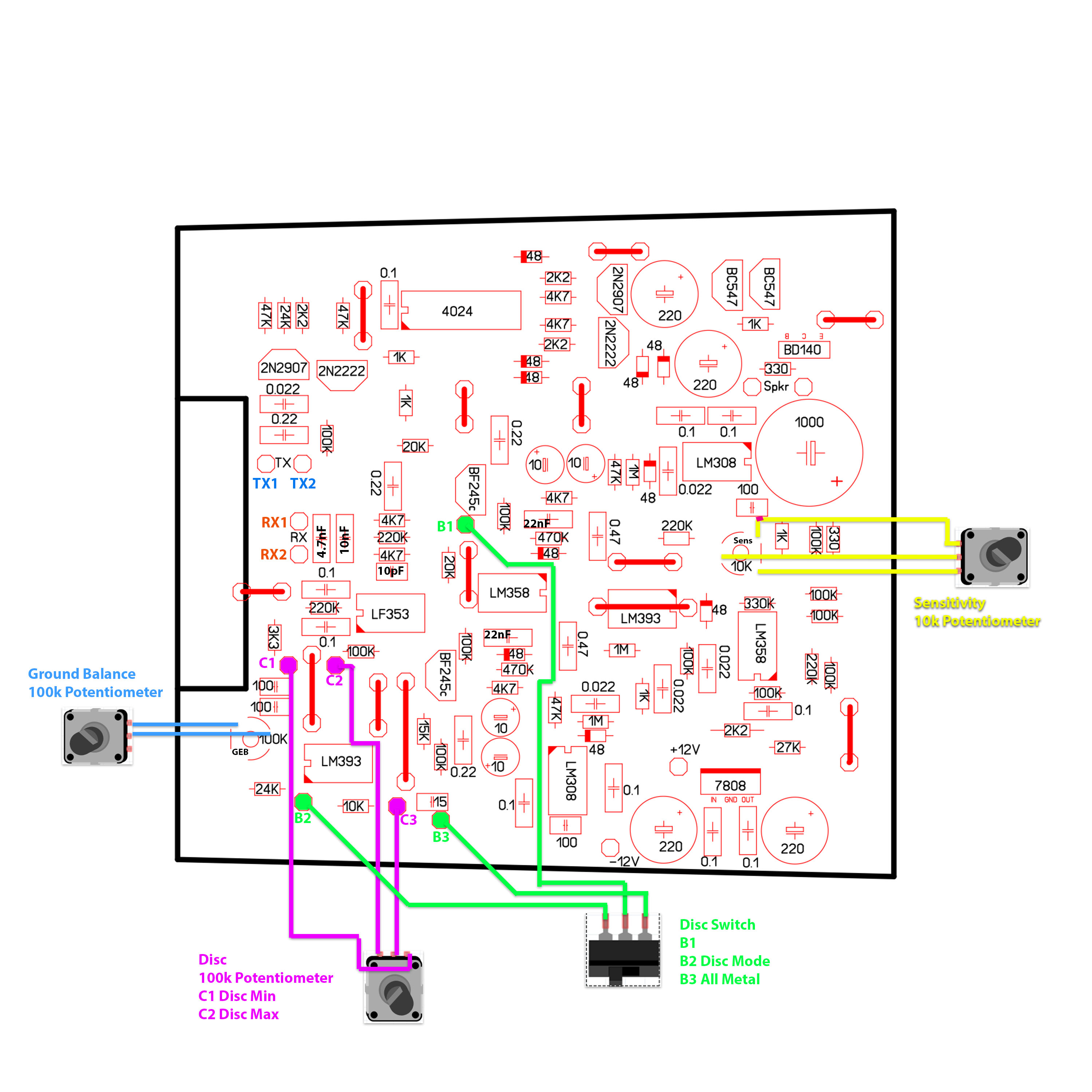

    I posted this in another thread but it might have been overlooked.
    Quick question regarding the TX and RX coil connections to the pcb. I'm getting confused on which pins on the pcb I am supposed to connect the TX and RX Start and End wires too.
    Referring to the picture I attached, could someone let me know the correct placement for the TX and RX start and end wires to the TX and RX pins that I labeled in the picture.
    Thank you again everyone for your help!
    Also if you see any errors in the picture please let me know as well. I'd like to make this available to everyone for reference in the future to help others who are building the tgsl.
    Ok I think that I've got the TX pins figured out. TX2 connects to the TX start wire and TX1 connects to the TX end wire.
    Now to figure out the RX pins
      Tx2and rx 2 for start coil txx1 and rx 1 for finish coil with grand
        You are reversing the numbers
          Thanks ne555! The reversed numbers where just for reference, I'll correct the labels in the final version of my document.
