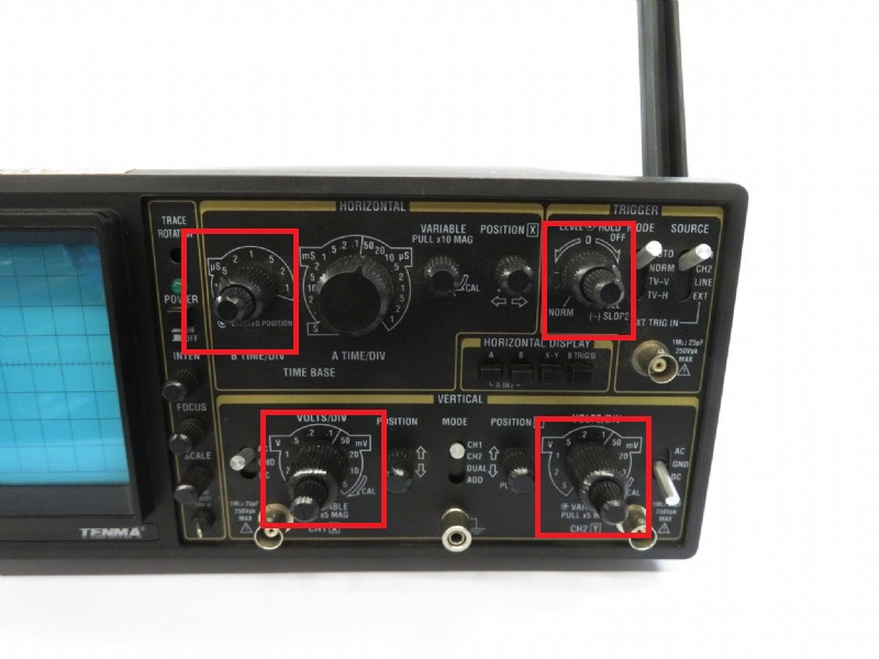

Only pot I would like as a multi-turn on a VLF is the Ground Balance. On my Pi, I use a multi-turn for the frequency control.
10 turn potentiometer or not for ground balance?
Thanks for the ebay link TiBuck, I didn't see those when I was searching I may consider buying one.
Everyone, what about the potentiometers in the picture I attached. They look like potentiometers within potentiometers, like the outside is for coarse adjustment and inside is for fine ajustment. I've seen them a lot on oscilloscopes.
Could these be used for ground balance? If so is there a specific name to this style of potentiometers?
Once in awhile I get access to broken or old oscillosopes and I might be able to salvage this style of potentiometer from them.
The best and cheapest solution (except if there is no mount place on MD front plate to put both pots there).Originally posted by Carl-NC View PostA dual pot will also work. That's what I did with the TDI-Pro, it has a coarse and fine adjust. An advantage is faster adjustment than a 10T.
