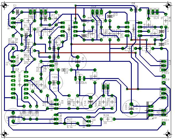

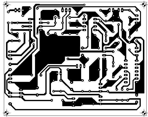

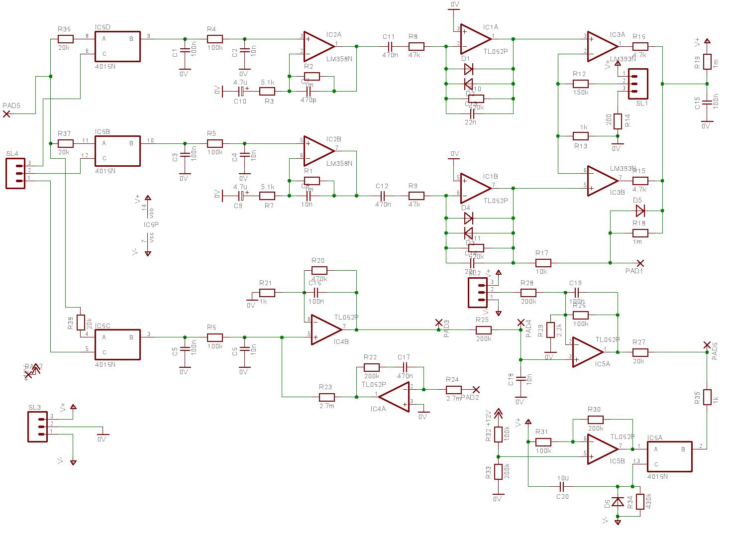

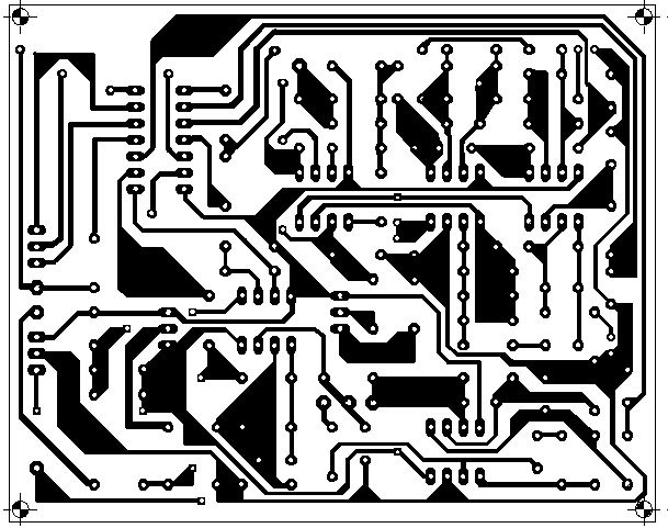

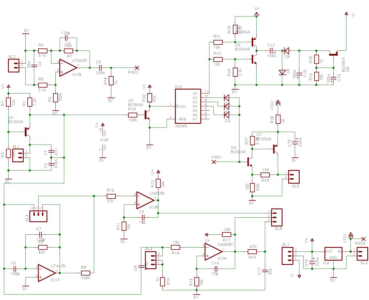

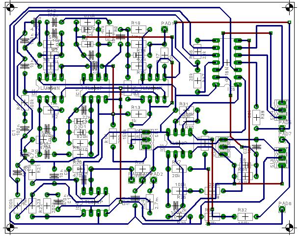

    Here is my work on Bandido project. It was made using Eagle Layot Editor.

            Good job! What are the dimensions of the pcb?
              Re: Bandido II PCB
              100x80 mm (both)
              Next day I'll try to post revised pcb's with correct dimensions - ready for printing with ACDsee.
                Re: Not yet
                I could be wrong, but your 2 boards look a bit large compared to mine. Why two boards?

                        It's true. Two boards design is a bit large than yours but in other side it is prefferable because you can place these boards in smaller box.
                        BTW, I realy like single board designs but as software I used is freeware it was with some limitations. This is maximum board size allowed in this version of EAGLE 4.01
                        One more question for all - could you give me a hint how to post source files here? It will be useful for all who want to check or modify this design.
