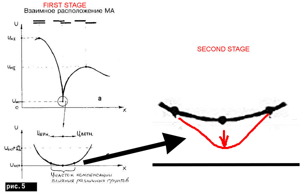

    yup. sure wrong because there is not details procedure 'how-to-make'. whites, tesoro, first texas specialists are keeping
    all techniks in deep secret. FIRM SECRET.
    ok. you have to have oscilloscope. russians use a half or 1/4 of kopeika (kopeika is old Soviet coin, in USSR hard era, we call that time THE REAL SOCIALIZM).
    first stage you must balance your coil as minimum as you have to have. certainly you look on preamp output.
    second stage, you must sure balance your coil in MICROVOLTS. that doind by MOVING the kopeika piece in different directions
    in a space RX - TX. you get absolute minimal voltage with some phase. MICROVOLTS.
    fix it with transparent glue.
    take a piece of ferrite in hand and move on coil. its like a ground. must be no reaction.
    take a coin. you see ...
    take a ferrous. you see ...

      You should not attempt to null your coils to zero. There needs to be a phase-offset appropriate to the design. In the case of the TGSL, it's needs to be around 20 degrees. Yes, you need an oscilloscope to do this properly.

                        look on pic
                          look on pic
                          [ATTACH]47624[/ATTACH]
                          Anatolij - you will need to translate that for those ignorant of the Russian lingo.
