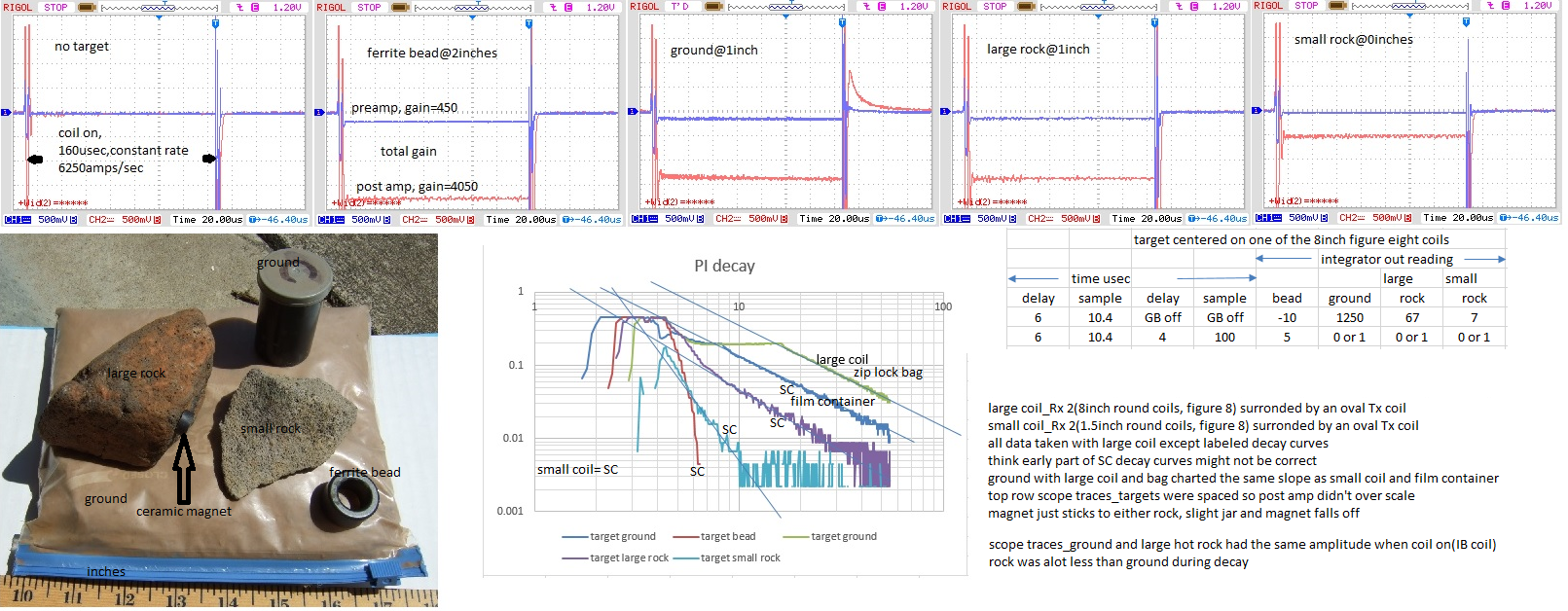

          Could you please measure the phase shift of a hot rock with scope? Im curious about it, maybe you could Disc it out.

            Some measurements made with a PI I posted awhile back. Hot rocks from California. Looks like the large rock is very close to ground, small rock decays faster. Data was taken awhile back, maybe could get better data now. Think the steeper slope at less than 7us is caused by the coil current still decaying?
