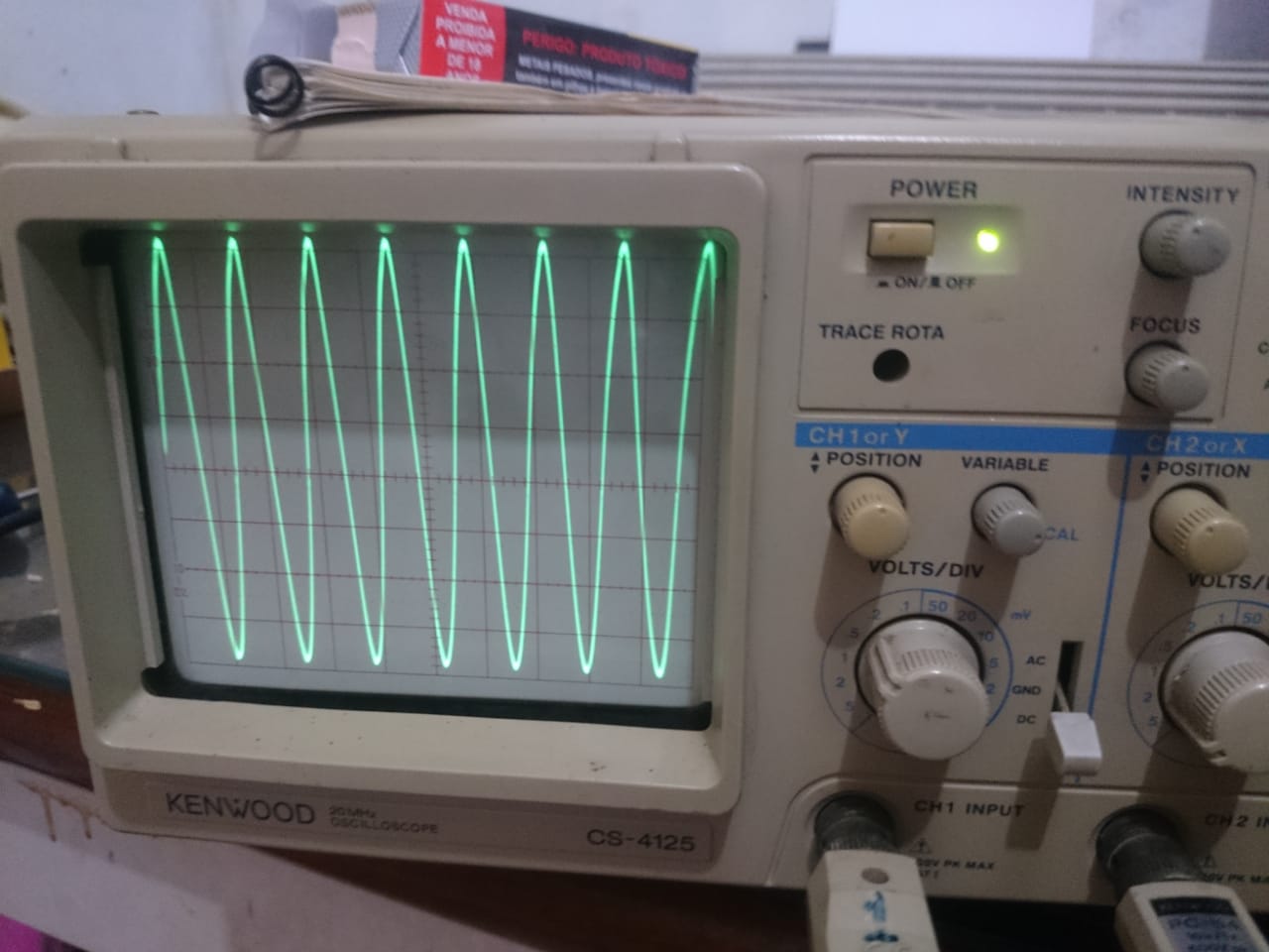

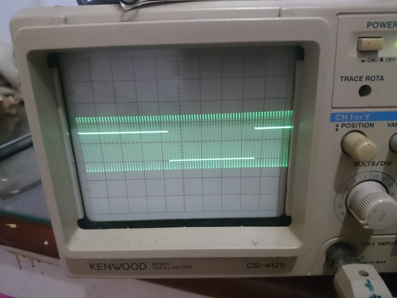

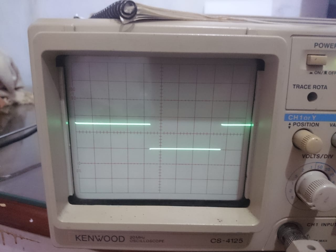

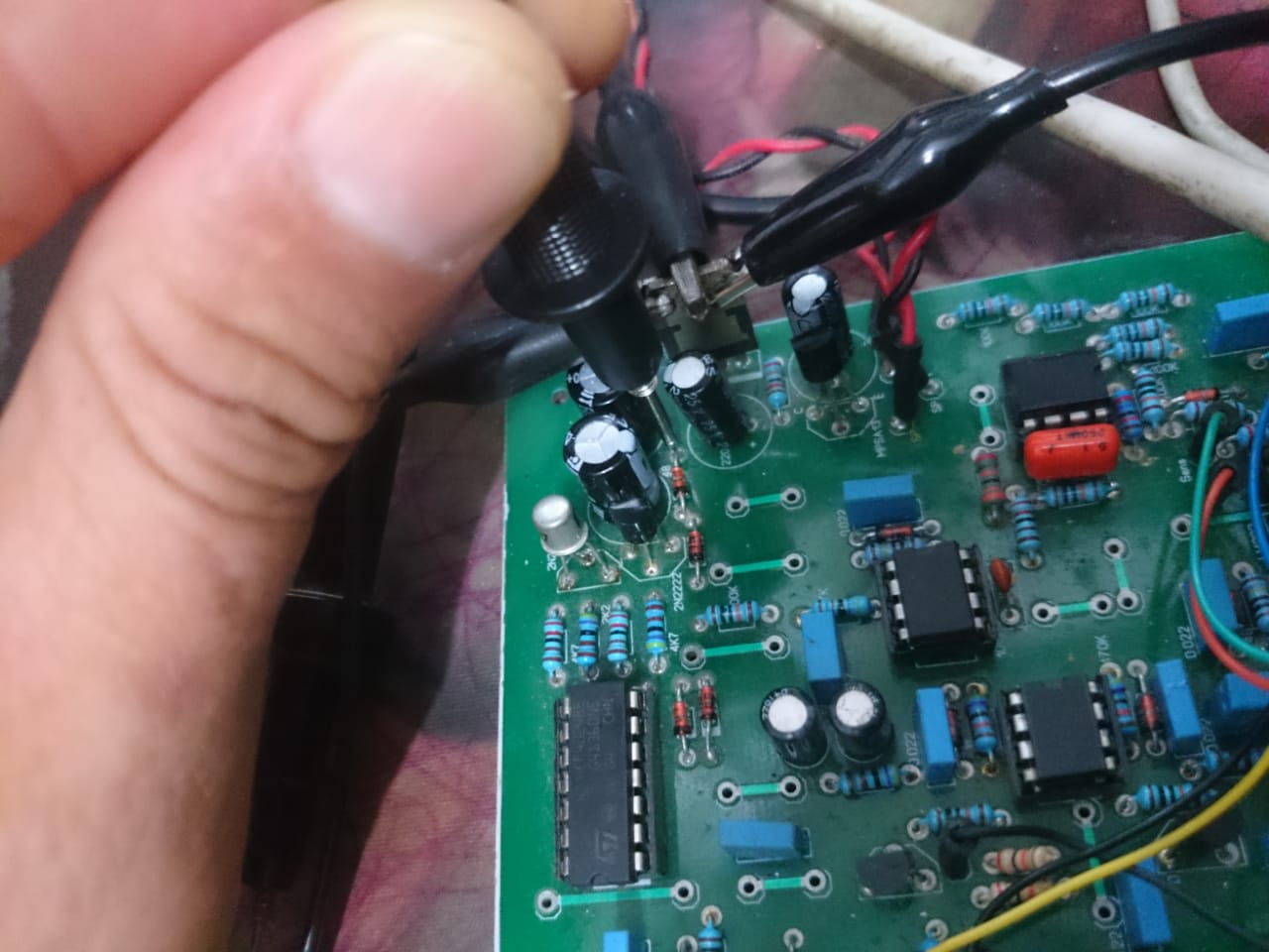

    Boa noite Waltr, verifiquei o pino 12 do u100, prendi a imagem com 5v / d & 20uS e no pino 6 do u100 com 5V / d & 20uS, como na imagem.
    Thanks for listening.
    [ATTACH]49321[/ATTACH][ATTACH]49322[/ATTACH][ATTACH]49323[/ATTACH]
    Originally posted by ranis View Post
    [QUOTE = Nandor; 265783] A fonte de tens?o negativa ? muito importante; se voc? acertar, deve obter cerca de -6,5 volts.
    Sob -6 volts, ele n?o funcionar? corretamente!
    Pierce Brosnan est? de olho em voc? !!! [/ OR?AMENTO]

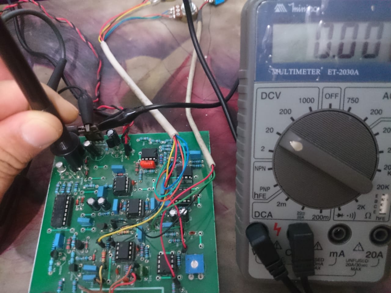

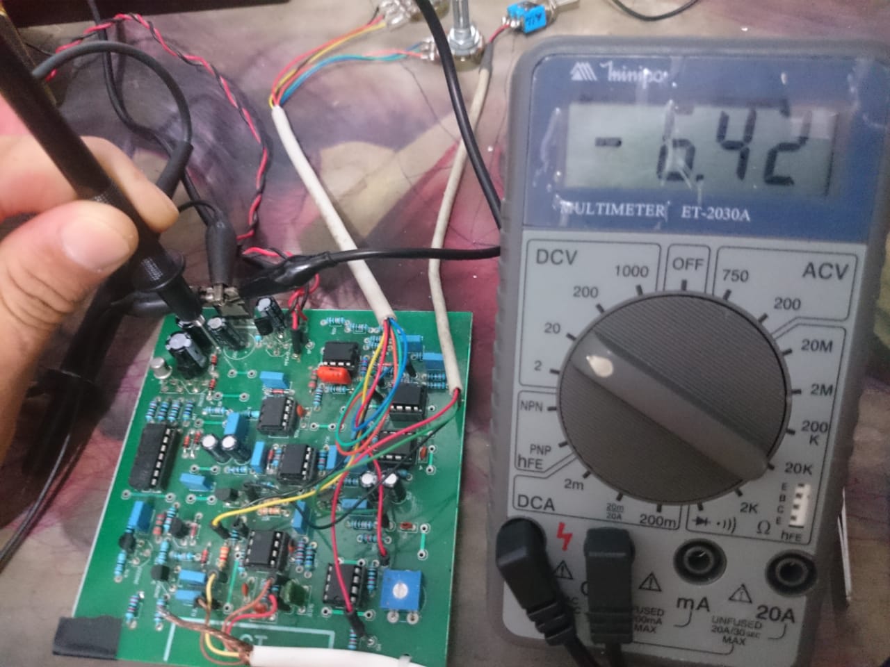

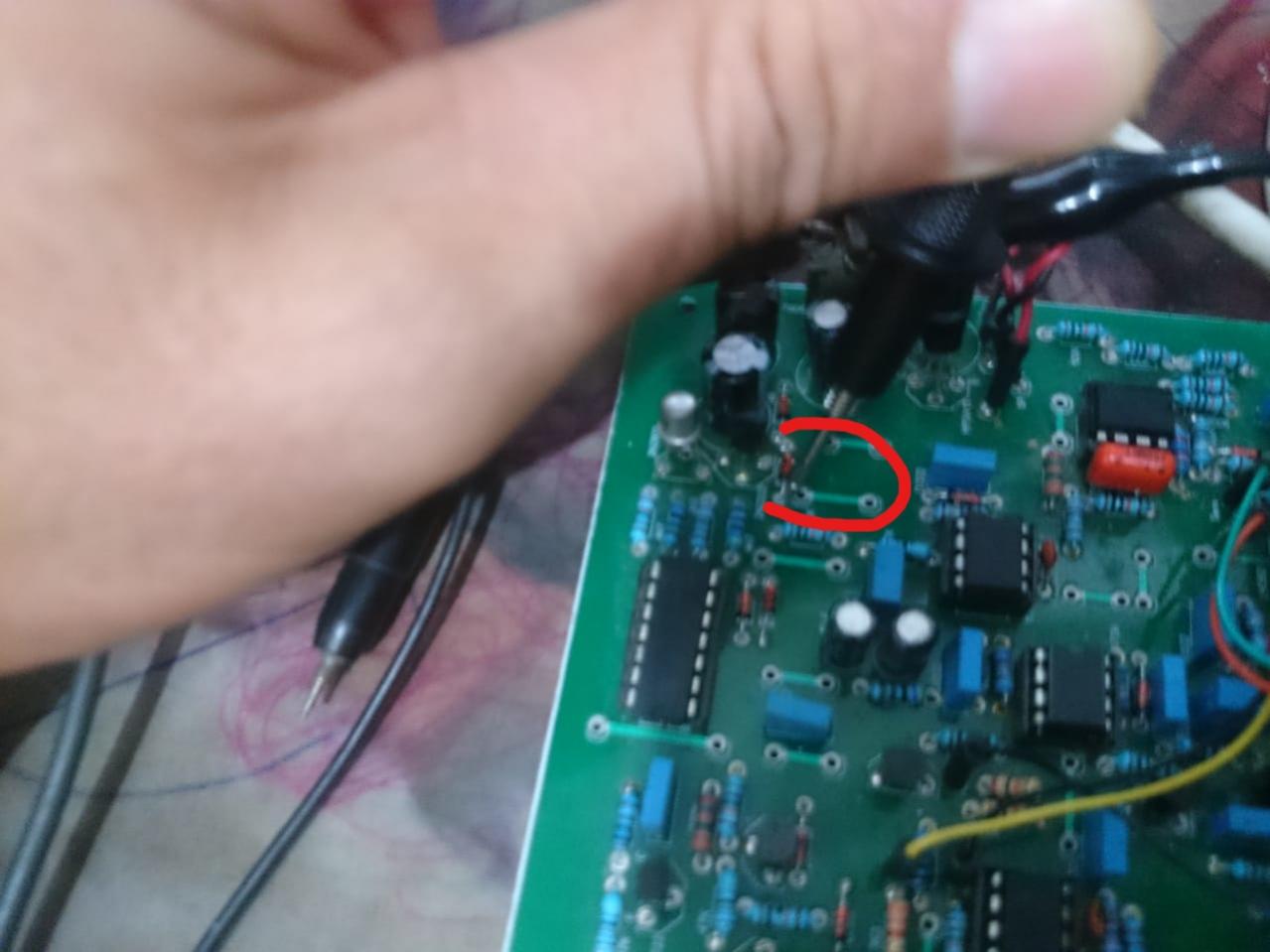

    Nandor, troquei todos os transistores, verifiquei todos os PNP e NPN em suas posi??es corretas, troquei os capacitores de 220uf do circuito no bloco 3 e nada mudou.
    Uma d?vida o -5v, s? ocorre com o campo nulo?
    Eu tenho no primeiro diodo como na imagem -6.42v, mas no segundo eu n?o tenho voltagem alguma.
    Vou consertar os fios dos potenci?metros Nandor.
    Na imagem u100u101, os dois canais do oscilosc?pio foram medidos a 5V / d e 20uS / d.
    A imagem u1017 est? no pino 7 do u101, medido com (.5V) / d & 20uS / d, porque eu n?o poderia faz?-lo com .1V / d & 20us, como no arquivo Tgsl101.
      Nandor, I changed all the transistors, I checked all the PNP and NPN in their correct positions, I changed the 220uf capacitors of the circuit in block 3 and nothing changed.
      A doubt the -5v, s? occurs with the null field?
      I have in the first diode as in the image -6.42v, but in the second I have no voltage.
      I'm going to fix the wires in the Nandor pots.
      In the u100u101 image, the two oscilloscope channels were measured at 5V / d and 20uS / d.
      Is the u1017 image? on pin 7 of the u101, measured with (.5V) / d & 20uS / d, because I couldn't do it with .1V / d & 20us, as in the Tgsl101 file.

        Thanks for the help, I did it in English, but the page was translated and posted inverted, I was unable to edit or delete it, find out again for the error.
          Good night Waltr, I checked the pin 12 of the u100, used it in the configuration of this pin as in the image with 5v / d & 20uS and in pin 6 of the u100 with 5V / d & 20uS, as in the image.

            Originally posted by Ozoz_xba View Post
            If you dont have -5v?
            1. Check for the frequency on 12.pin 4024?should be 7.2 khz nearly.
            2.check for 2 diodes near 220uf capacitors ,shoul get damaged not working well,you should have -5v at this diodes 1n4148 near 2n2222 and 2n2907,also if you have -5v there then test lf 353 ouyputs if its works.
            If you have -3v at previous doides then check for them also check 2n2222 and the 220uf capacitanses
            i wrote billions times guys. THIS SCHEMATIC WITHOUT TX COIL DOES NOT CREATE NEGATIVE VOLTAGE.
              Where it is written friend, thank you.
                Hi Ranis
                -6.42V is very good! Other 1N4148 diode is ground! Square wave looks very nice and clean "muito bom"
                Boa sorte
