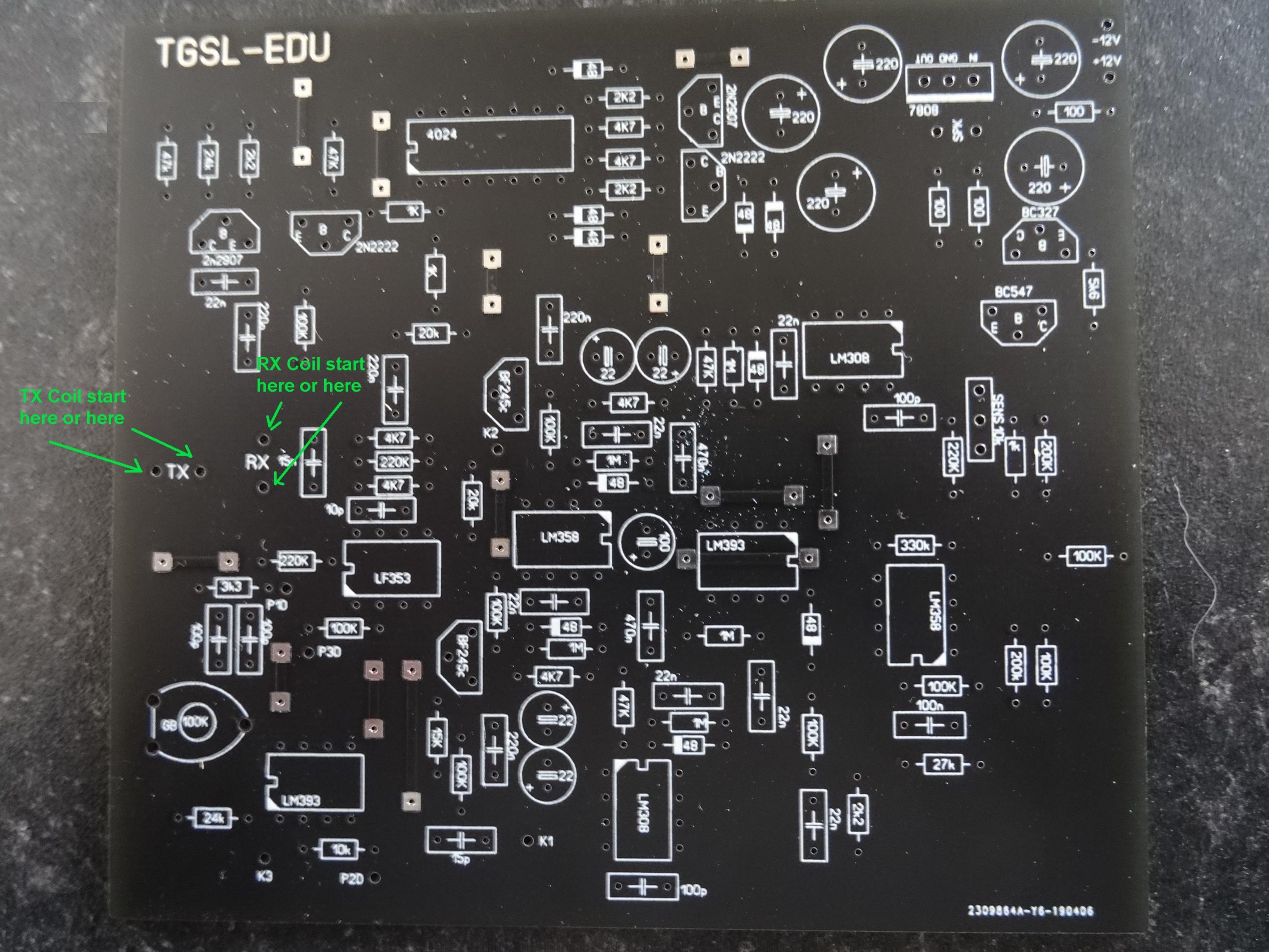

    On the PCB the TX and RX connections for the coil are marked. But there is no indication for the start or finish of the coil winding's for each respective coil. Does it matter in what orientation they are connected?
    The manual makes a point of marking the start and finish of each coil when making them but nothing is said about the 'start of each coil should go here and there' on the PCB. I would have assumed it does matter or unless I am missing something. Why the importance to label both ends?
    Have attached a pic in case my question was unclear.
    Look on the back on the PCB for which TX and RX pins connect to 'ground'.
    Otherwise connects coils and then with your O'scope do the coil 'Nulling'.
    If you get the corrct phase lag (about 20 degrees) then coils connections are correct.
    Otherwise, if phase lag is completely off then reverse one coil's connections.
