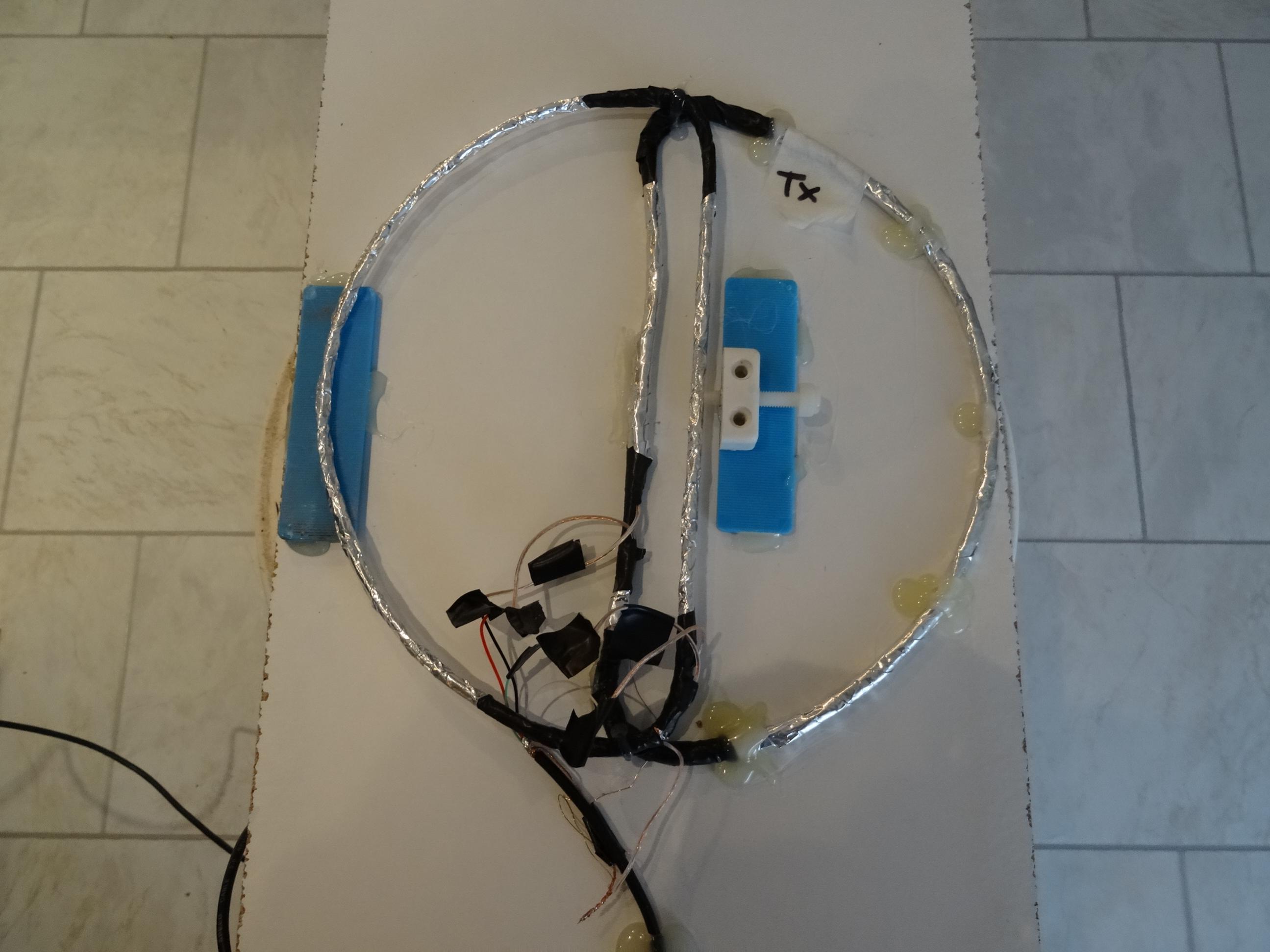

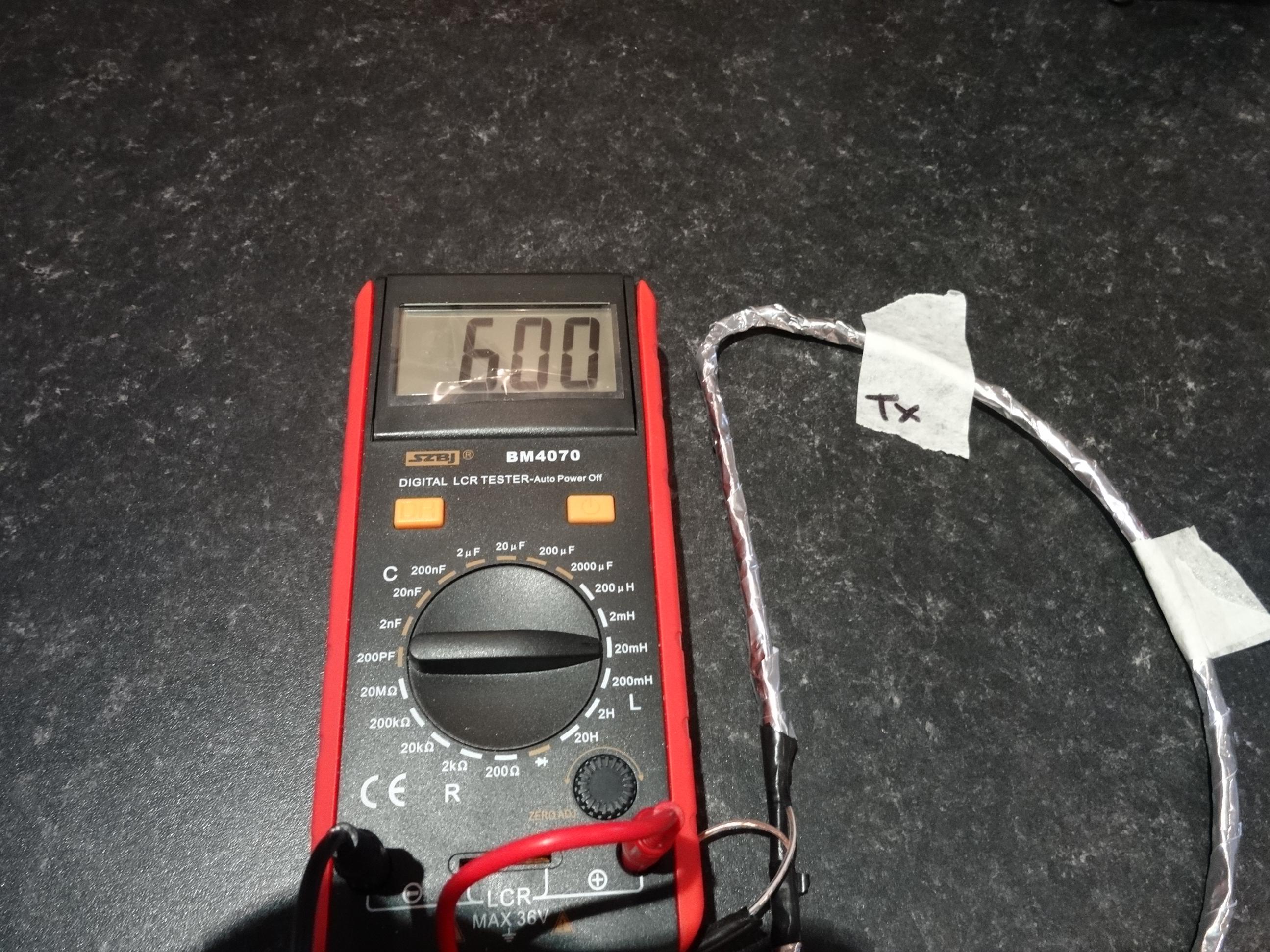

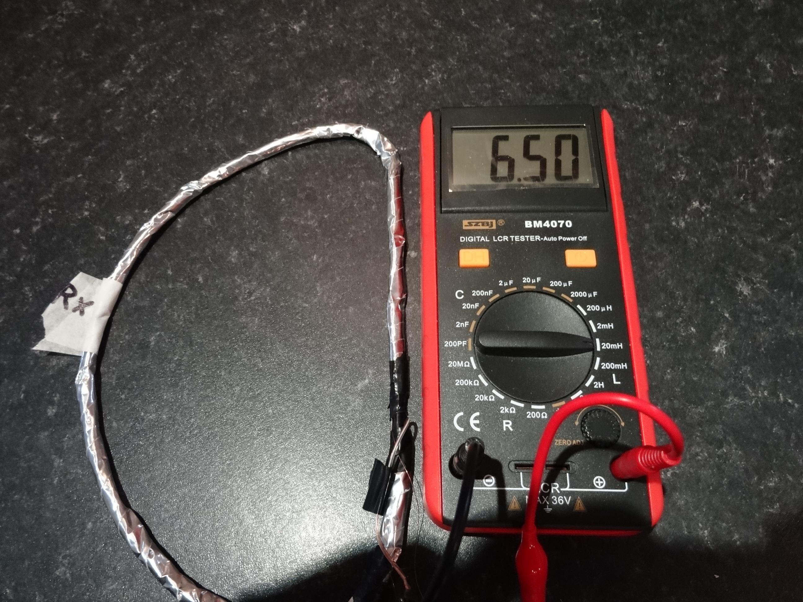

                  Some productivity today whilst waiting for parts. Altered the two coils already made that matched frequency beforehand by adding more winding's to equate to inductance value. Now happy with final figures of each coil. I used aluminum tape as a shield but kept the backing paper on for now as I want to finalize the coils to fit an existing coil shell I have nominated for the job. Until I know how much overlap they need to null out and their correct diameter, I can't commit to making a permanent coil. Not really stoked about making shells. I know the coils aren't pretty but should be enough for the initial setup. Least get me in the ballpark. Passed continuity tests when checked.
                  waltr.
                  Really appreciate the info regarding the caps and their placement, and the extra how to do it info. Stuff like that really helps a beginner like myself and I'm sure others. May seem trivial to someone with your knowledge but to me, without it, I'm like. What the Sam Hill did he just say?
                  Oh yeah nearly forgot.
                  Have found a few caps at 20-20uF and a few 14uF. Maybe after viewing the attached pics you might say I need to go much lower per cap due to the frequency difference and add to it later.
                  Oop! Gotta go. Wife's returned and giving me THAT look.
                    Correction to last post missed edit window opportunity to correct. nF cap values not uF.

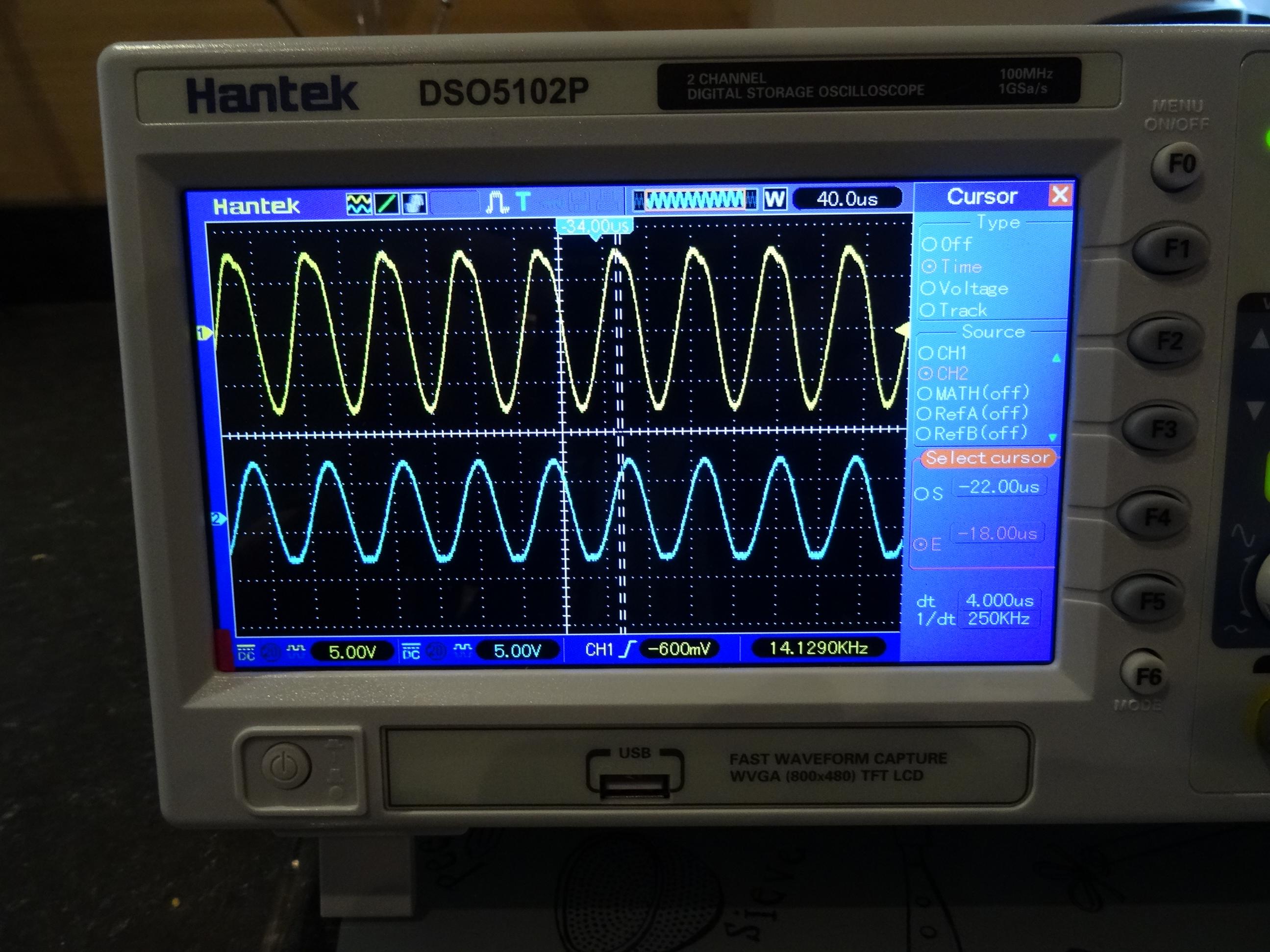

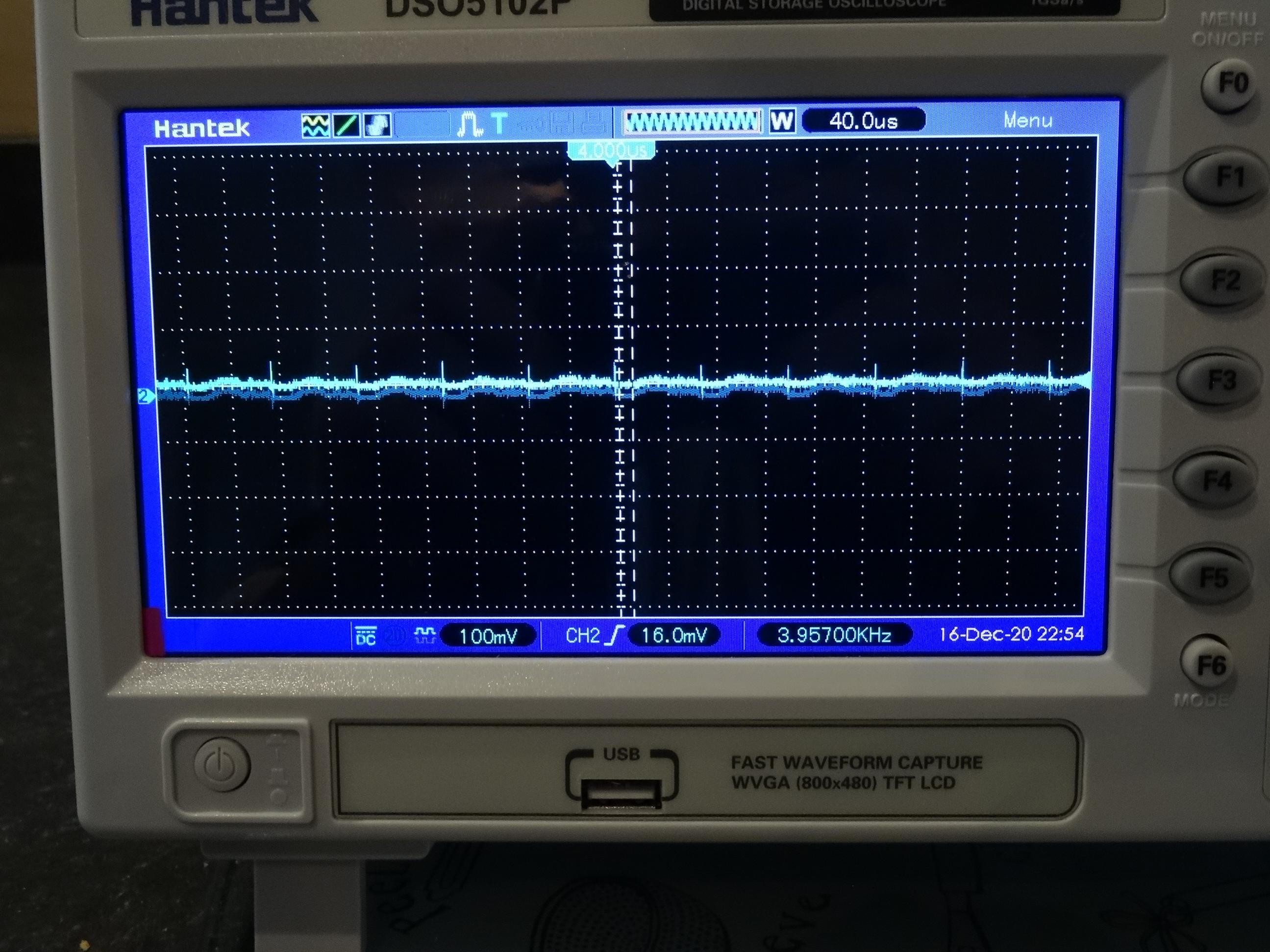

                              Parts arrived and fitted.
                              Unfortunately I won the Friday afternoon production batch of BF245c's. One tested good, the other not so much. Fitted it anyway and prayed for a miracle. Didn't happen.
                              No replacements and no substitutes so re ordered.

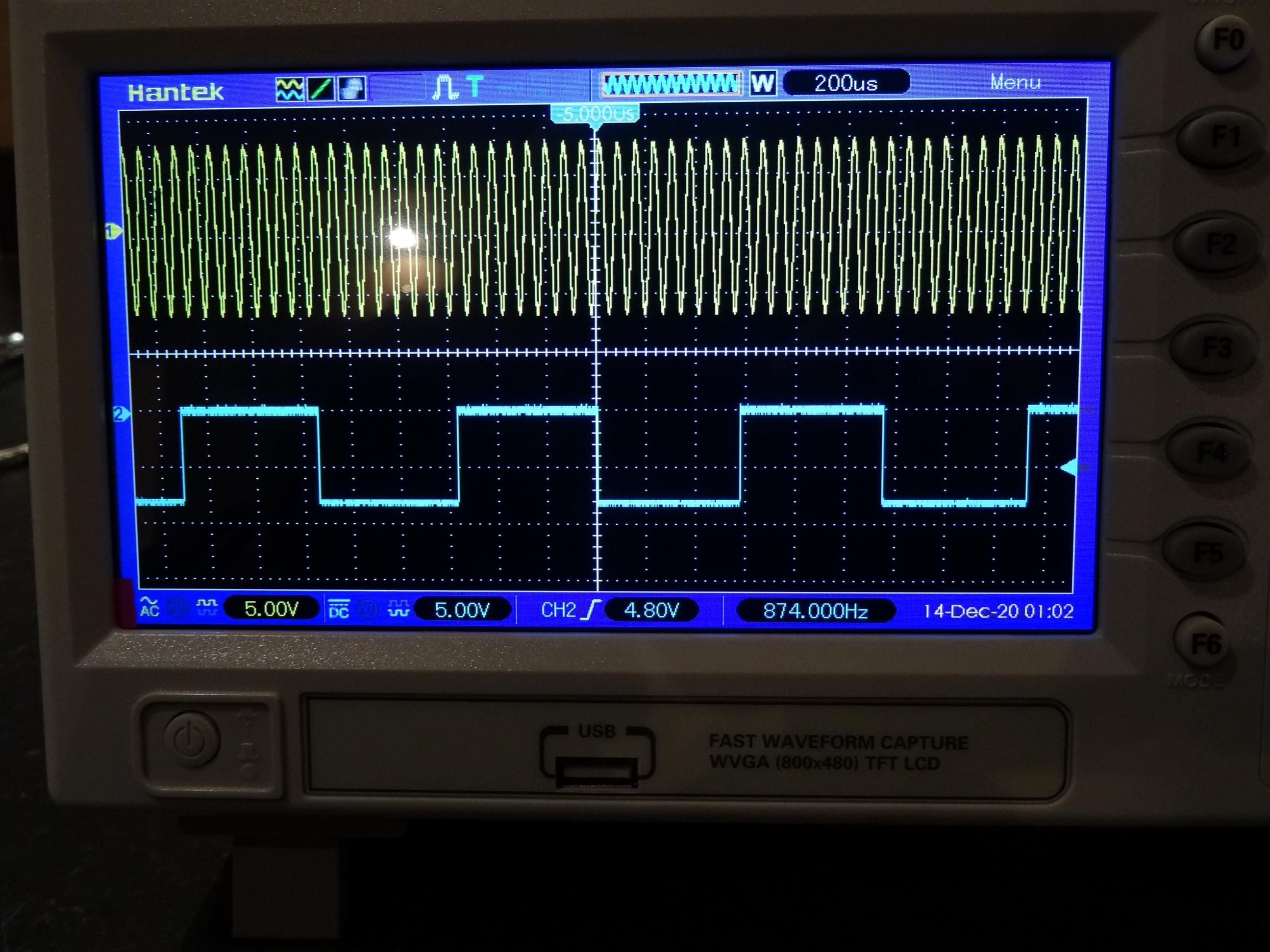

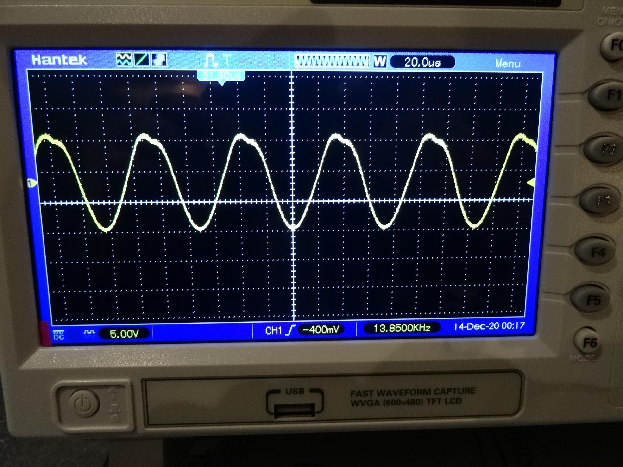

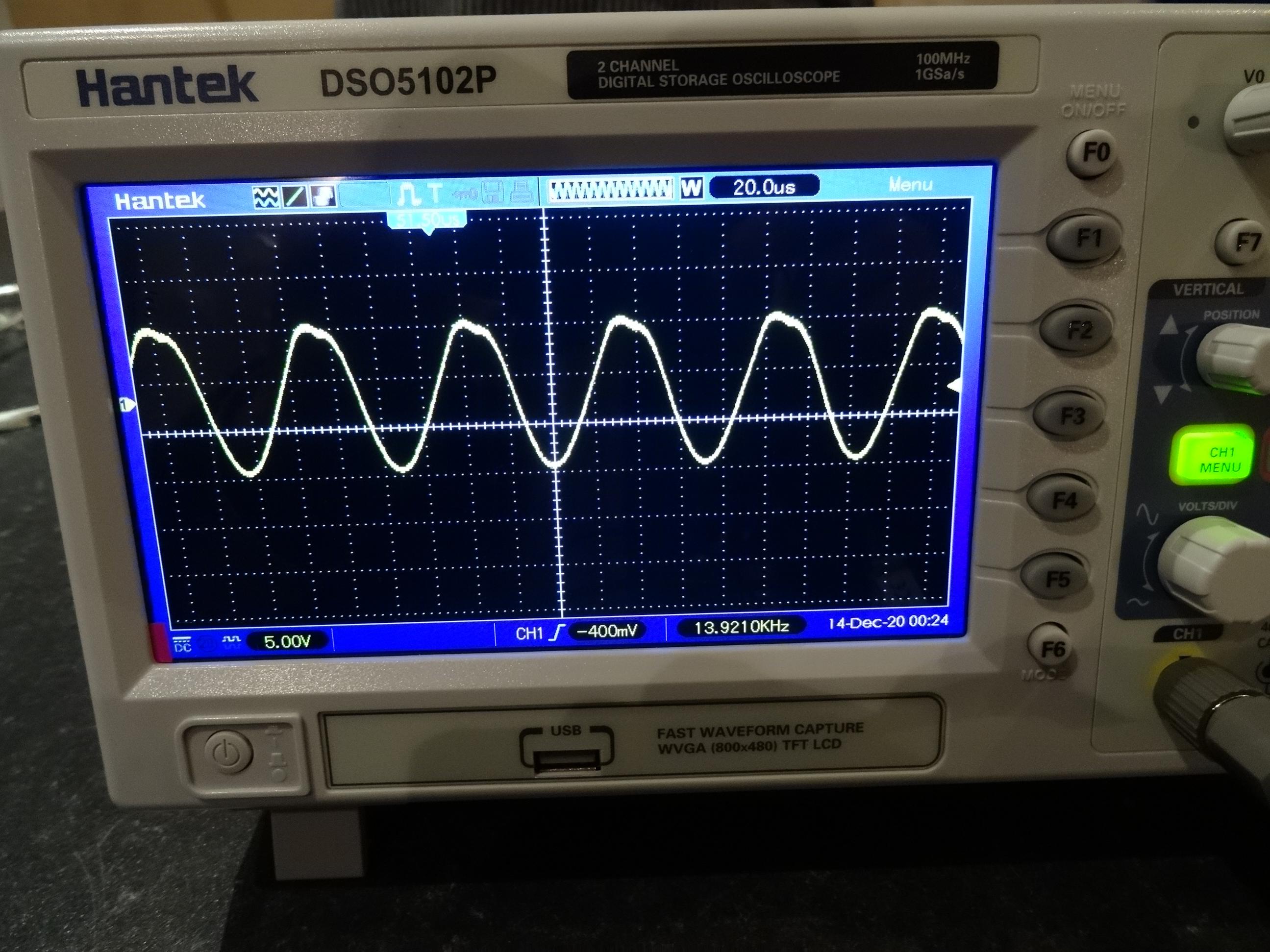

                              Went on to nulling.
                              Can't believe how sensitive this procedure is. Used a small nylon screw and block to finalize the voltage check as indicated in the advanced nulling section. Got it down to 100mV in accuracy.
                              Checked steps 2 and 4. Images shown.
                              I left the cursor menu open in case I did a boo boo with the settings. Still getting used to this new scope.
                              Weird stuff.
                              When the pcb is turned on, it takes 60 seconds before it will detect a can at 20" sounding a beep. The lower pulse in step 4 can be seen to rise and fall as the can is passed over the coil but no sound until after one minute left on. This only happens once the MD starts to beep on its own accord, at which stage it goes into a constant beep beep beep mode at 2 p/Sec The can is still detected but the beep for it comes on in between the constant string of beeps.
                              Not sure if this is due to an incomplete circuit TR5 failure or something else.
                              Also noticed when the GB pot is adjusted whilst running the beeps stop for a short time even if the can is passed over the coil and then restart after 20 seconds. Think I read somewhere the GB pot needs grounding?
                              No amount of adjusting the sense, disc and GB pots alters this behavior.
