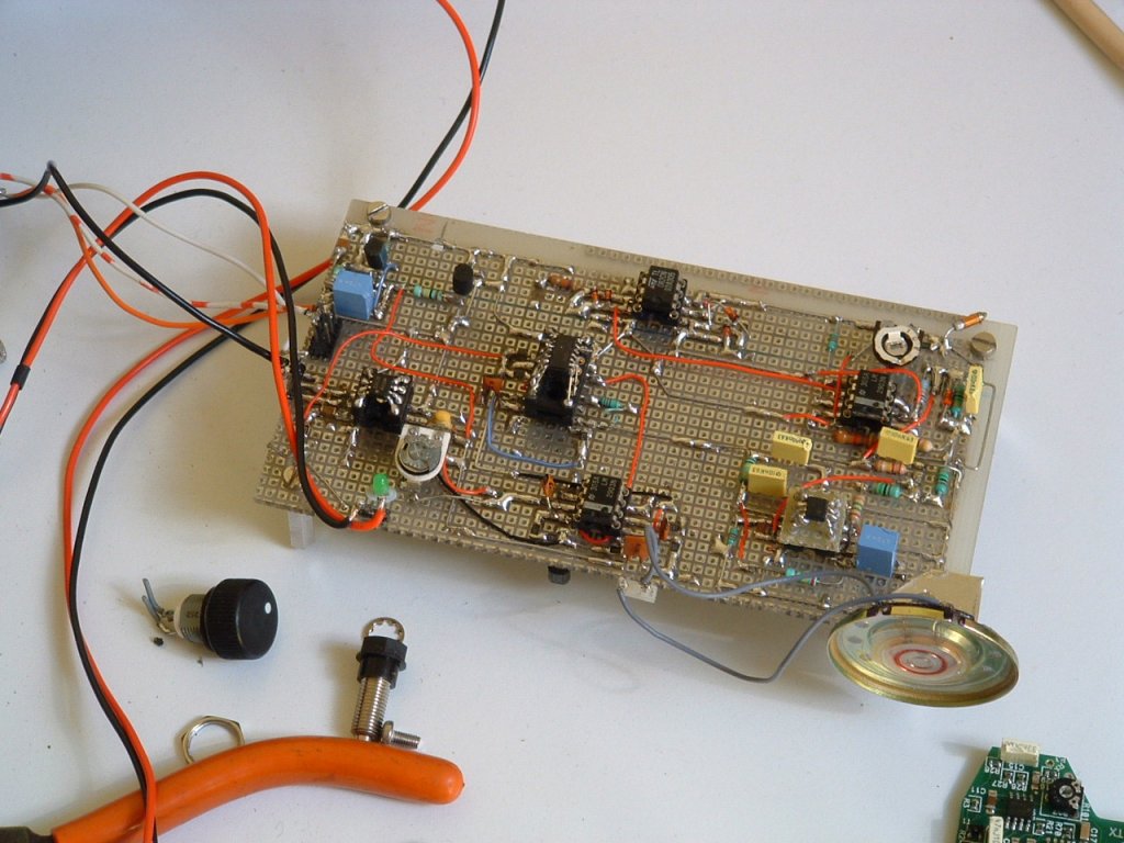

    Hello,
    I have made Carl's bandido II umax with the schematic. I can detect a 50eurocent at 20cm.
    But how do you explain, that in same conditions, with the same coil i can detect the same 50eurocent coin at 31 cm ! with my silver sabre umax ?
    The schematic seams to be comparable.
    What could be the cause ?
    I have no small audible noise when i turn the sensitivity at the max position. With the silver sabre, i can ear a small noise that indicates me that i am close to the floor.
    Thanks for help.
    What distance do you succeed to ear the first noise for a 50eurocent coin with the Bandido II ?

      I finally succeed in optimizing the bandido.
      I obtain 30cm for a 50eurocent coin.
      The problem was an oscillation of the beep :
      When there was a beep, it created a current peak in the speaker. This peak created a parasitic beep and so on...
      I increased the feed resistor of the speaker and uses an headphone and it is fixed !
