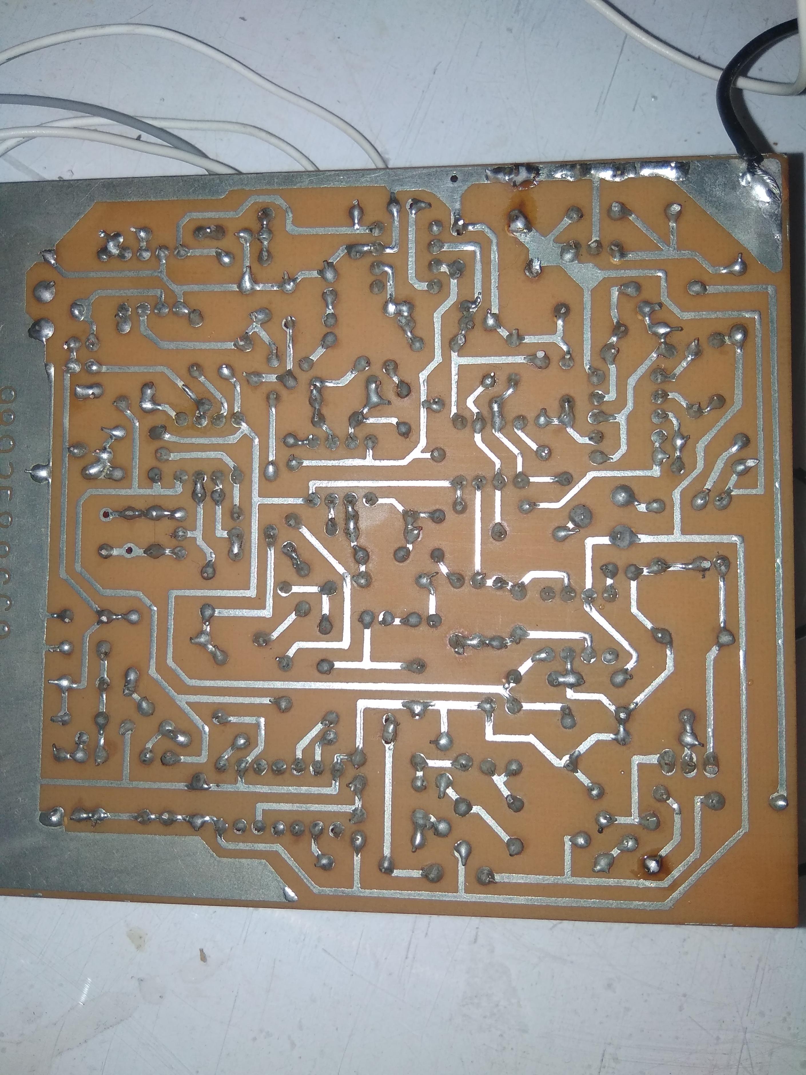

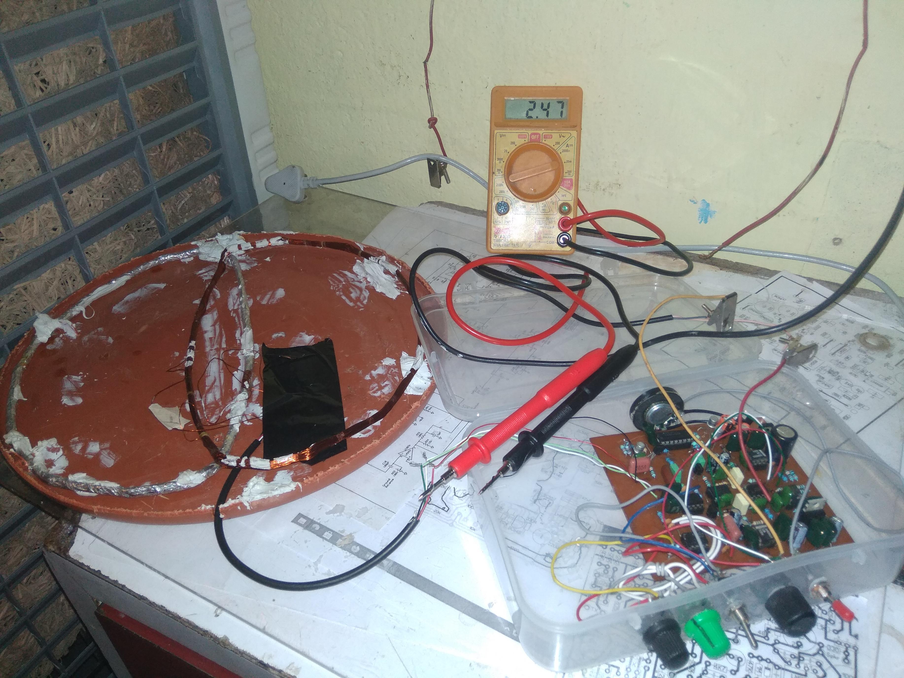

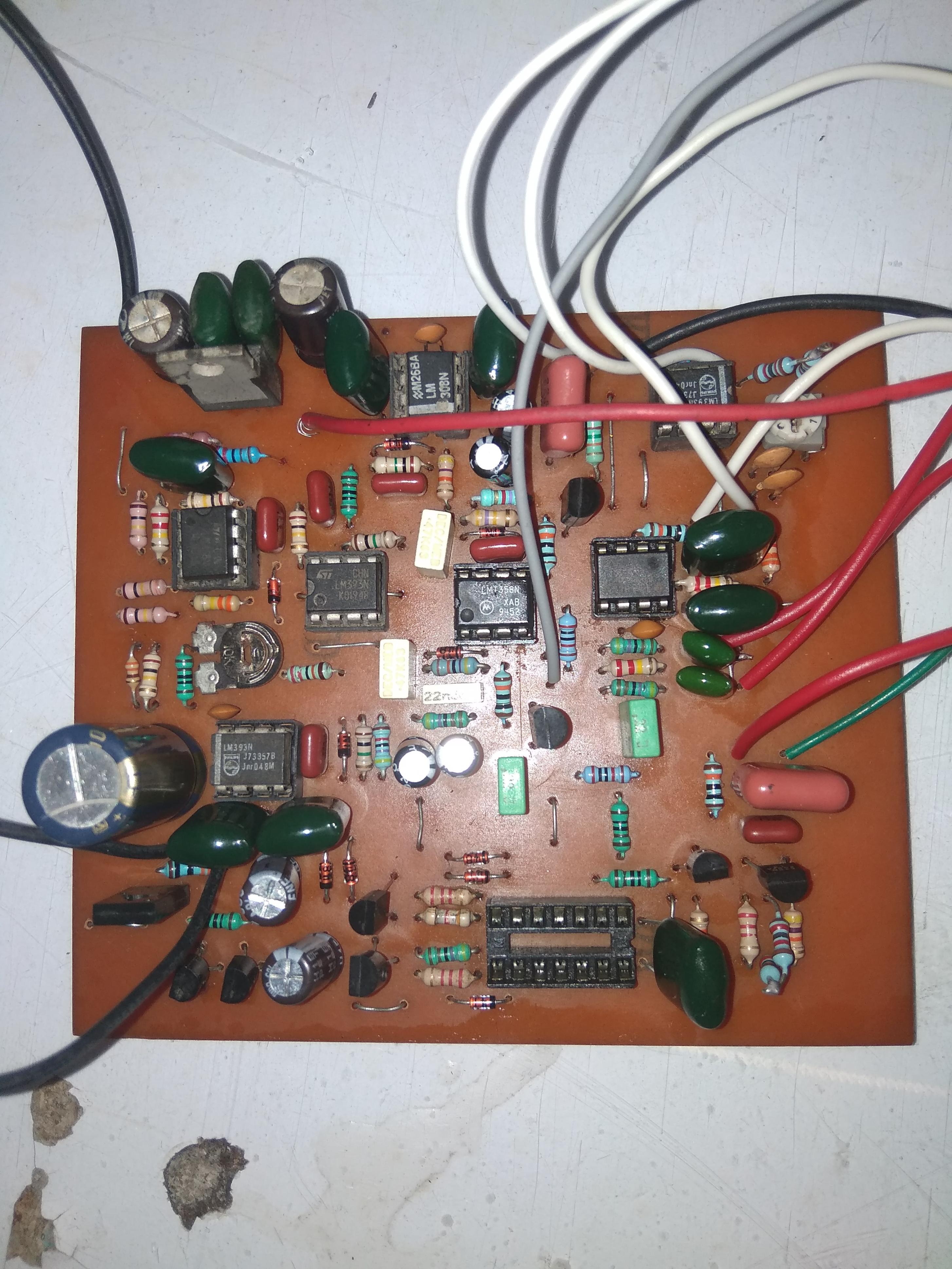

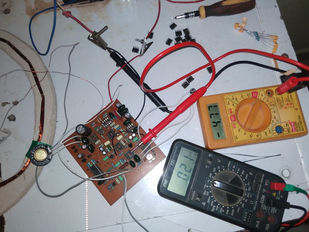

    I have 15 volts a.c. & 7.9 volt d.c. on my TGSL J1 TO GROUND without connecting the coil but as soon as I connect the tx coil, the volt becomes zero.
    Answered in PM.
    FYI Note: Do not PM if you post here.
    Then give the forum 24 hours to obtain an answer since we live on opposite sides of the world.
    You can not measure this with a DVM. With the coil connected the oscillator will run at 14.5kHz. Do you see this with your O'scope??
      ]Detector is working when i connect tx coil after giving 12 volt power supply then it is negative -5 volt & frequency also for 2 second

            oscillator run at 14.5kHz only for two second when touch tx coil on board
              hi every one there was TR.1 damage replaced this
                Ok. Good you were able to troubleshoot and fix it.
