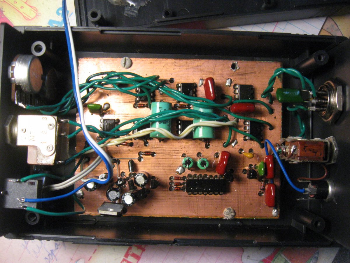

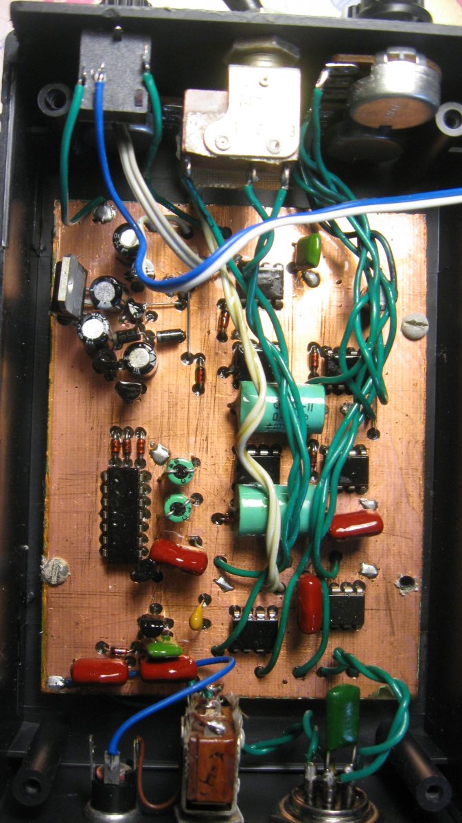

      looking info on ukrainian board. i like the size.

            running ahead remember this sch does not give negative voltage without a coil connected.
            massive amount of troubles i meet everytime.
