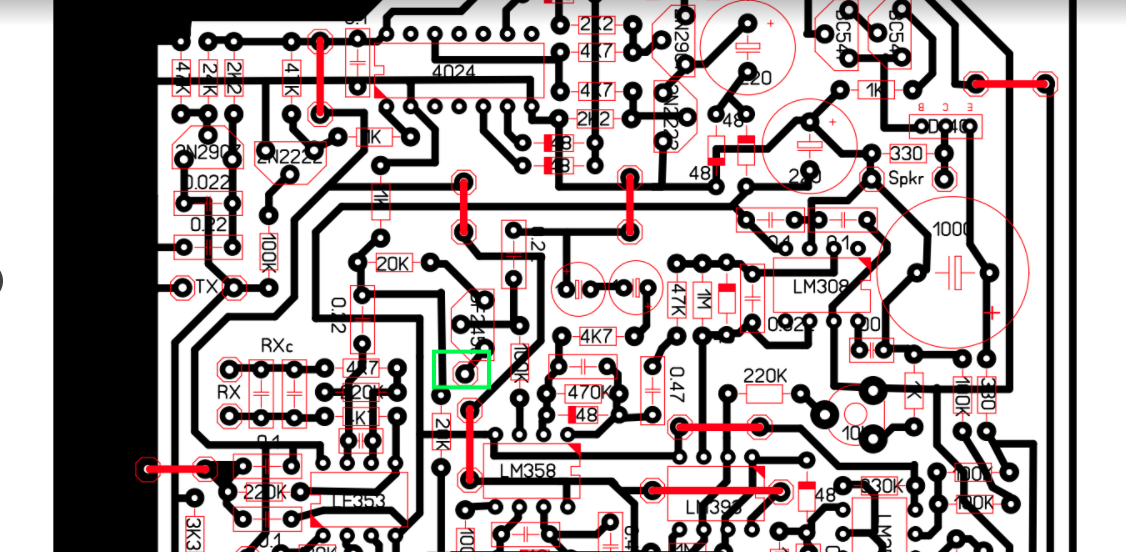

    I finished today my TGSL and I'm trying to troubleshot it, initially by looking at the connections.
    One thing I noticed is that there is a point with no connection specified in the documentation, near one of the BF245C transistors.
    I'm sending an image with this case as attachment, surrounded by a green square. Should I wire something to that point?

    wire to DISC SWITCH. i am not in the matter of tgsl i just look a sch.

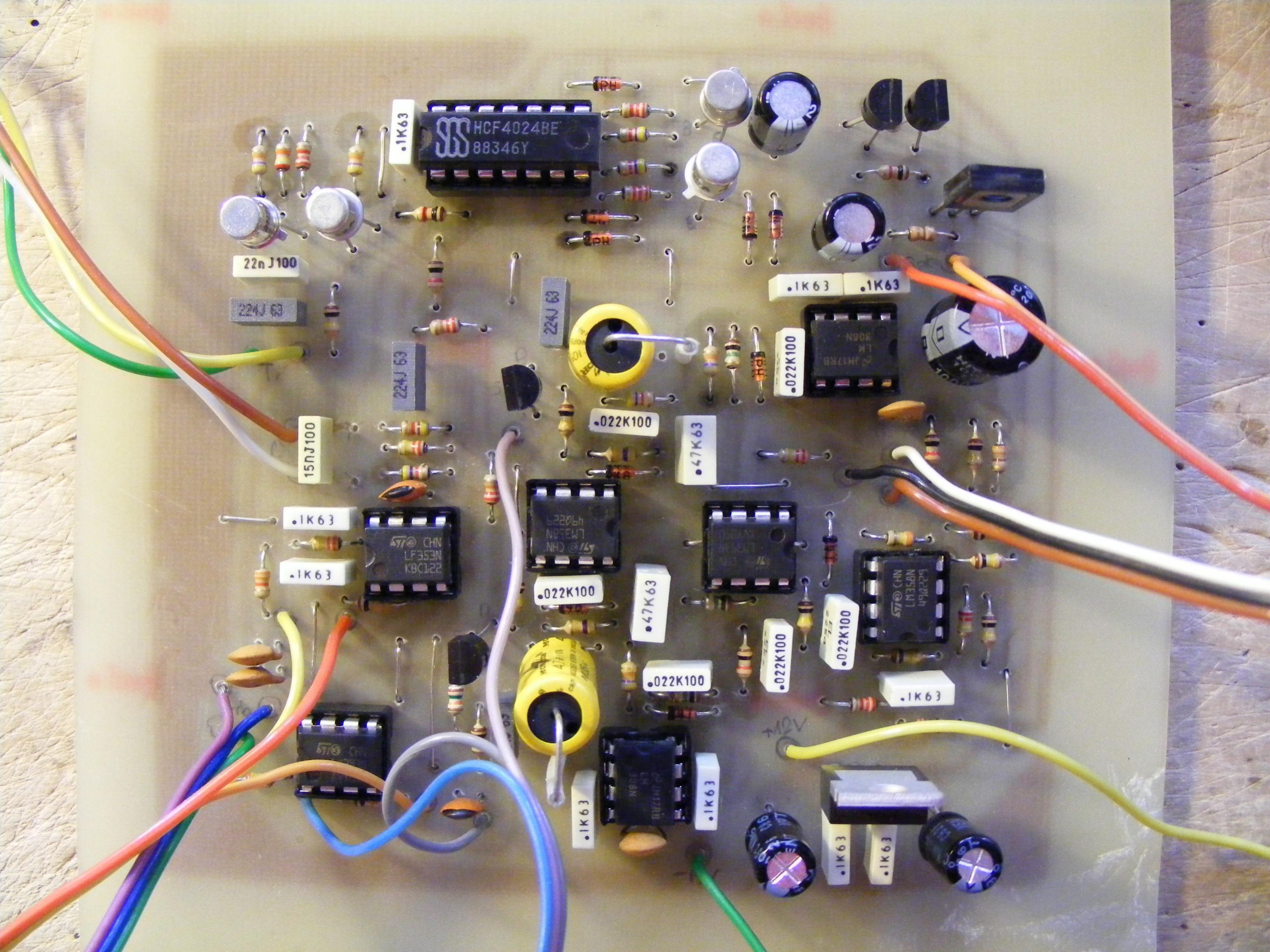

      AAL METAL MODE CONECTION SEE IN IMAGES
