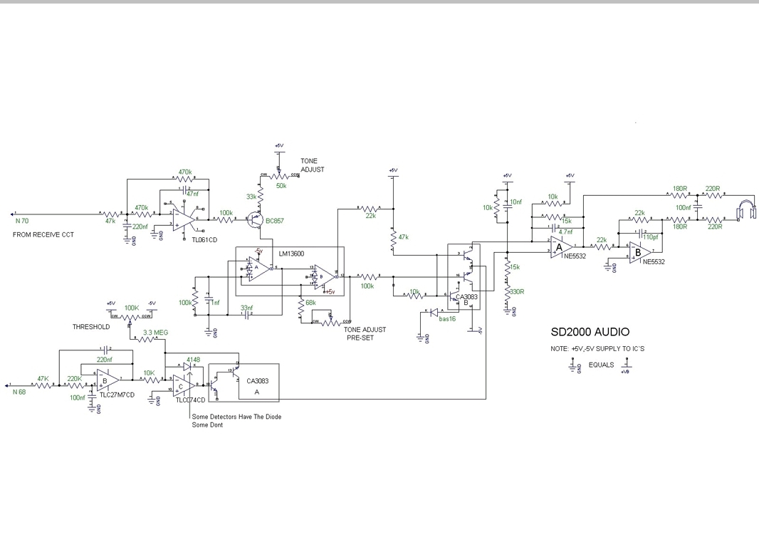

Is it possible to merge the gpx string audio circuit on tgsl
Sample Question tgsl
Bro, I'm not looking for depth, I'm just asking if the sound can be modified into Minelab tones, so that the search can be done without moving the coil top targetOriginally posted by kt315 View Postmore details. what you want? to get more the depth? audio circuit does not give the depth.
audio is audio, not have a relation with TX power. or what??? MORE DETAILS.
