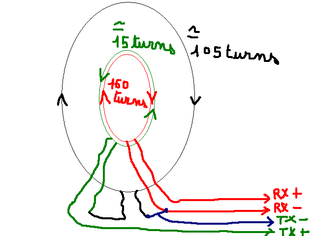

      here is the coil schematic, i will try it this evening or tomorrow.
      The second TX coil in green is in the reverse direction thant the main TX coil. The number of the green coil has to be adjusted to cancel the received field in the RX coil !
      I will tell you more if it works !

            It works !!! but it is not very sensitive.
            I have succeded in canceling the RX signal, but i have not the correct phase shift between RX and TX. It is what i have to optimize !

                This might sound stupid but try reversing the receive coil connections.

                      Not stupid , but i have tried it and the phase shift in not good neighter.
                      I have to play on the coil number ratios to have a good compromise. I will retry it this week end !
                      I will post some pictures of it if it works !

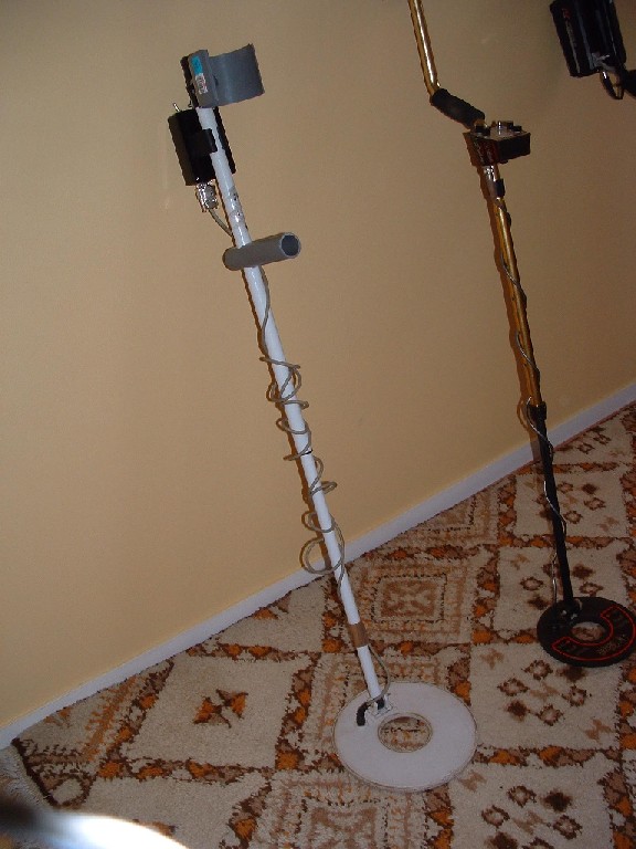

                      Before I find the solution for this coil, i use a standard tesoro coil (see picture)
