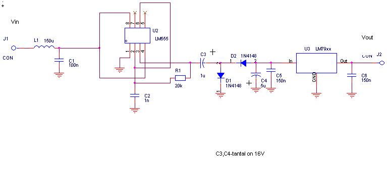

I'm trying to build the Tesoro Bandido II µMAx, but now a question has occured. I hope someone of you can help me. The -5V converter I have build has only an output of -3V . I have checked the circuit several times, there is no wrong connection in it. On the other hand I've used BC546 and BC557 as Transistors, but i think that doesn't matter.
I think the problem is that one of the switching Transistors is connected to +5V , when the transistor is connected to + 9V I'm getting an output of -6,3V. When the transistor is connencted to a supply of +5V I think it is not possible to get an output of -5V because of the losses at the transistors and diodes. What do you think, am I wrong?

I use that shematic and don't have problems with supply
