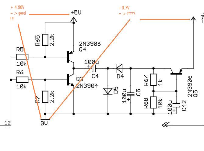

    I'm finished the bandido II umax but i'm not sure where i must put the multimeter to verify the -5V
    when i put the multimeter between this 2 points ( see image below ) i have +0.7V and i d'ont undestrand ??? => is it correct ???
    Thank you for your help
    https://www.geotech1.com/thuntings/a...ntid=609&stc=1
    D4 and D5 are round the wrong way. If you dont have a neative voltage on the board it will scream. Also recheck the schematic.
