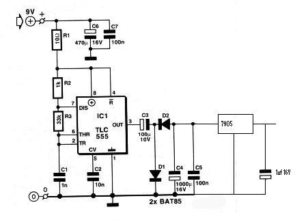

    i have made the double side PCB but my Bandido does't work.
    First when i checked the -5V power supply, i had only -2V so i have changed the power supply by this one :
    https://www.geotech1.com/thuntings/a...ntid=626&stc=1
    So now it's good, i have -5V but the bandido doesn't always work .
