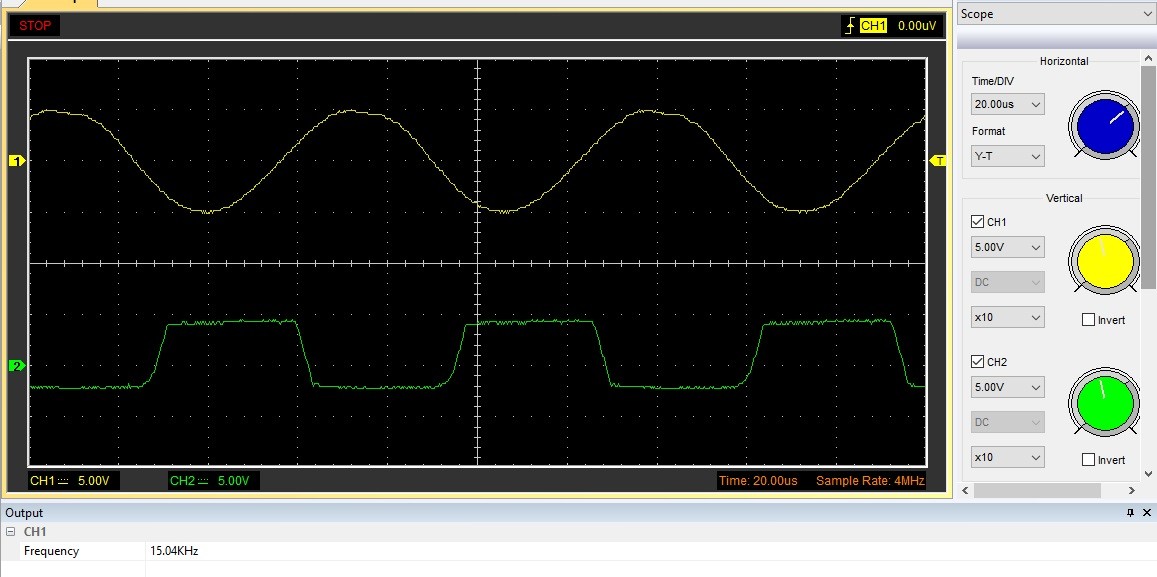

    I have built TGSL and i tried to null RX/TX.
    I connected TX and RX (pin7 from LF353) to Scope.
    But my RX is Square waveform, not sine form!
    I am using 0.2mm wire, my TX=6mH and RX=6.5
    I also reversed TX wires, but no result.
    Do you have any suggestion for check?
    Thank you.

      It is DD. I tried more and my form is OK ( attached).
      But my sensitivity is very very low. Do you have any idea for check?

        If the RX waveform is measured at the output of the preamp then it appears to be clipping on the low side, which means your coil null is bad. The idle signal at the preamp output should be 100mV - 1V pp max. Obviously, make sure there is no metal near the coil.

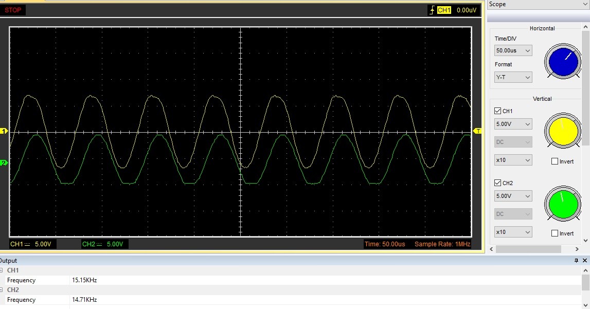

              I played with my TGSL, it is stable and my coil form is OK.
              I have built a 22cm coil and tuned its GB so that not to detect ferrite.
              You can see its O-scope form in attached.
              I think my sensitivity is low and i think that there is a problem.
              My coin diameter 3cm and my depth is 17cm! I saw several videos from TGSL that detect coin from 25cm!
              I change sensitivity pot, but it has a very little effects!
              Do you have suggestion for test?

                  I would think that the BF245B would be a better choice. I have no idea why your sensitivity is low. First thing is to double-check resistor and capacitor values to make sure they are all installed correctly.

                      Finally, i solved the sensitivity problem, thank you for your kindness.
