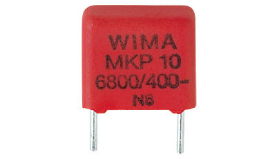

      Another question...
      why WIMA MKS ??? temperature coefficient instability ???
      I haven't wima mks but normal poly caps and they seems ok...I have drift only when in all-metal manual...and not much high.
      Best regards,
      Max
        Hi MAX,
        WIMA capacitors
        metallized polypropylen capacitors - MKP
        -55 to 100°C
        High frequency and temp stability in pulse mode.
