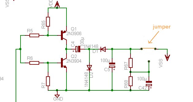

        Hi Max!
        Still can't get the voltage right... now its -2.2V, still not enough. I have changed resistors (to lower values), capacitors and even the two diodes. I even disconnected the negative rail from the opamps, still the same.
        input is a nice square wave at 5kHz and output from C4 is the same but +0.6v to -4.1V.
        I measured aver all current to 18mA.
        I use 1N4048 as diodes.. should I change to 1N4007 or any other diode?
        1000 thanks for all help
        Peter
          hi Peter.
          you have a drop on transistor Q3 1-1,5 Volts and you do not want to see it.
          my suggest, you can do
          - multiplier on more stages, for increase of voltage
          or
          - a converter similar to is used in MD-5012.

            Hi Peter,
            don't know why you get so small voltage there.
            You could use shottky diodes (e.g. bat48 ) to get better switching (and more efficient conversion), also caps could have too ESR and could cause losses due to electrolitic solution...
            You just need about -2.8 volt to get things start working good.
            But -3.2 are much better !
            As KT315 said there is the drop on Q3 (about 1volt) that you could cut off of your circuit gaining about -3.2v on -V rail.
            You just need pull out of pcb the Q3 , then short collector and emitter pads with a jumper.
            It's not a cool solution... but I think you could gain that way your -3.2 volts.
            Try then let me know.
            Kind regards,
            Max

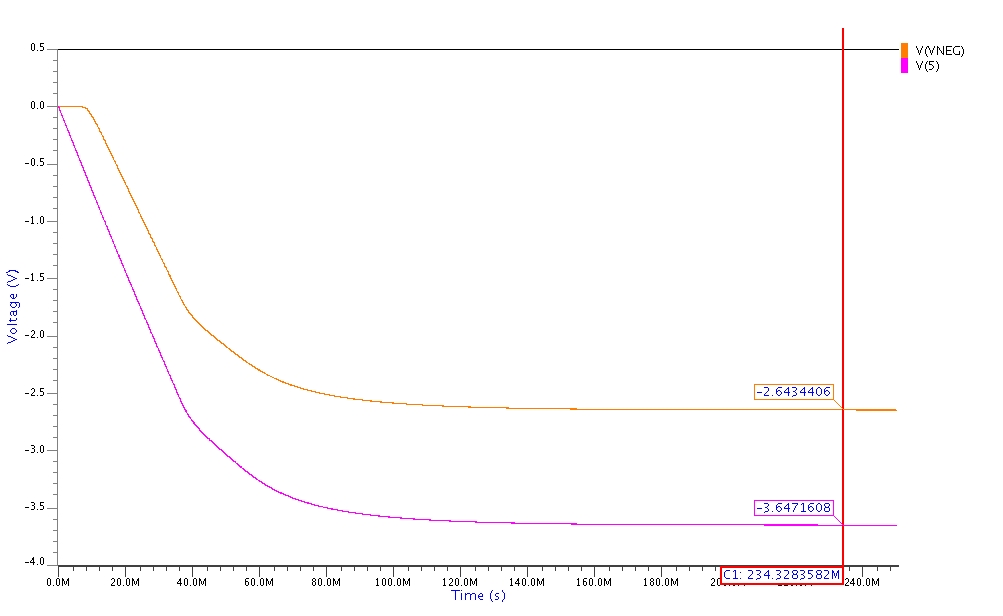

                Using this diode pump with the current values will not provide an output of more than about 2.6V. Max's workaround of removing Q3 will get you to about 3.6V.
                Here's a SPICE netlist of the circuit, and the waveform results are attached.
                V(VNEG) is the output voltage, and V(5) is the voltage across C5.

                  At last! -3.4V =)
                  Qiaozhi gave me the idea to try and optimize this voltage doubler, so I too made a schematic in PSpice looking for the best components.
                  Now I use two shottky diodes: BAT86, C4 is now a low-ESR cap, transistors changed to two BC557C and one BC547C... Q3 is still on board, R68 is now 47k. In theory PSpice gets -3.9V but I am satisfied with -3.4V negativ rail and is waiting for my ordered coilhousing, eager to balace and test =)
                  thanks again for taking your time
