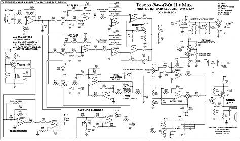

    I’m working on Bandido project. I’m using Gary’s schematic and board designs as a reference and I have a few questions:
    1) Gary’s schematics / notes specify +9V for IC 1 (4024), but Gary’s PCBs has this connected to +5 V. I looked at the component spec (I’m using OnSemi) and power requirements are +3 /18 V. Is there any reason for the +9V?
    2) I’m omitting the original battery check circuit (in favor of Gary’s Bat Check). Do I need to tie down pins 1,2,3 of IC 3 and 10,11,12 of IC 4 to gnd? Or should just let them float?
    3) Outside of the caps used in the oscillation circuits, is there any advantage in using poly caps over ceramic discs?
    Thanks,
    Molzar

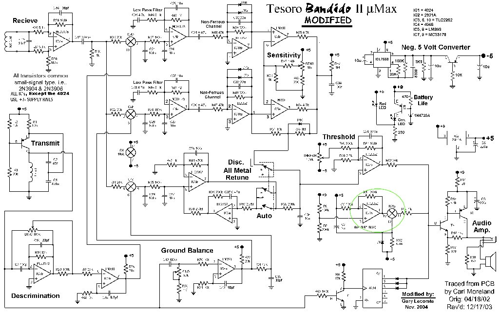

      Hi Molzar,
      I think you mean that circuit of the picture... if not please send yours.

      1. works about the same. 4024 is cmos device so could work with voltages of +3V only. I think Gary connected to +5 on PCB cause it's stabilized voltage and not just on +9 line from battery cause of maybe of the thought about eventual spurious signal propagation on battery line...after he modified the schematic... but then also the input signal is always in the 0-5V range (due to T2 interface) so no need of +9 supply.
      Also there's no differences about audio performances this way... cause 4024 gives only the GND level to be used with the pull-up action of comparators: so it's absolutely safe and right using +5V there on PCB.
      2. you can omit passive stuff too... and tie 2,3 of IC3 to gnd and 12 of IC4 to gnd; if you have already all mounted there... just pull out of circuit the 1K resistor with label R13
      3. Just about stability: poly are better of MKT or similar type to gain more stability. Ceramics are good just for small values here.

        Hi porkluvr and Max,
        The schematic is as below, Gary's most recent. The 4024 shows +9V.
        This is my first VLF and pcb design. I omitted the original "Bat Chk" so I wasn't sure what was good practice with the open pins. I've seen both Poly and Disc used so I just wondered which was best.
        Thanks for your reply, I read many of your posts, very good information.
        Best Regards,
        Molzar
