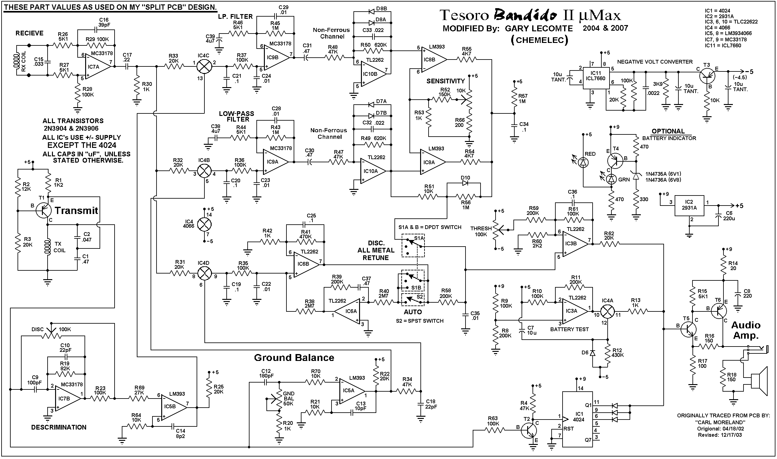

Hello , Make sure you check your search-coil RX winding . And see the schematic I posted , Also Check the order of your 100k Disc. potentiometer connections across C9 and C10 !!! You should be able to repair your Bandido , without too many problems...........Regards............EugeneAttached Files

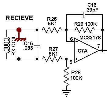

The ground connection is not needed. There should be a common connection within the Tesoro search head between the TX and RX coils. Adding this extra connection will cause problems.Originally posted by Saint Sinner View PostThanks. I will check up.
I also have earthed RX here so:
[ATTACH]6936[/ATTACH]
It is correct?

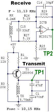

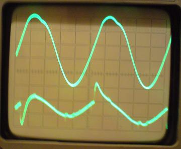

You should be seeing a 10kHz sine wave at the output of the preamp with an amplitude of approximately 300mV. Have you checked the power supply voltages on the preamp? That would be a good place to start.
I have made search head independently by the same principle as for Golden Sabre. Grounding RX has made in a search head.Originally posted by Qiaozhi View PostThe ground connection is not needed. There should be a common connection within the Tesoro search head between the TX and RX coils. Adding this extra connection will cause problems.
Can be not to earth RX?

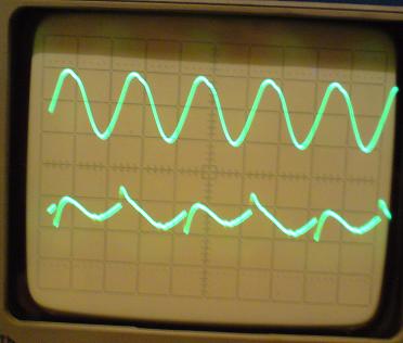

I always aspired to zero. The minimum which I receive is equal 16 mV.Originally posted by Qiaozhi View PostYou should be seeing a 10kHz sine wave at the output of the preamp with an amplitude of approximately 300mV. Have you checked the power supply voltages on the preamp? That would be a good place to start.
300 mV it is enough?
Pressure of power supplies on preamp +5V/-2.9V.
It is correct?
The grounding of the RX coil is made via the screened cable. You do not need the extra ground connection that you showed in the previous diagram.Originally posted by Saint Sinner View PostI have made search head independently by the same principle as for Golden Sabre. Grounding RX has made in a search head.

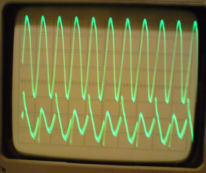

Search through the Tech Forum TGSL posts. There you will find some setup details for the coils, including the correct phase-shift between TX and RX. Because of this required phase-shift you cannot null the coils completely to zero. Otherwise the ground balance and discrimination will not work correctly.

Thanks, Qiaozhi.Originally posted by Qiaozhi View PostThe grounding of the RX coil is made via the screened cable. You do not need the extra ground connection that you showed in the previous diagram.

Now all is clear to me.
I will check up phases.
