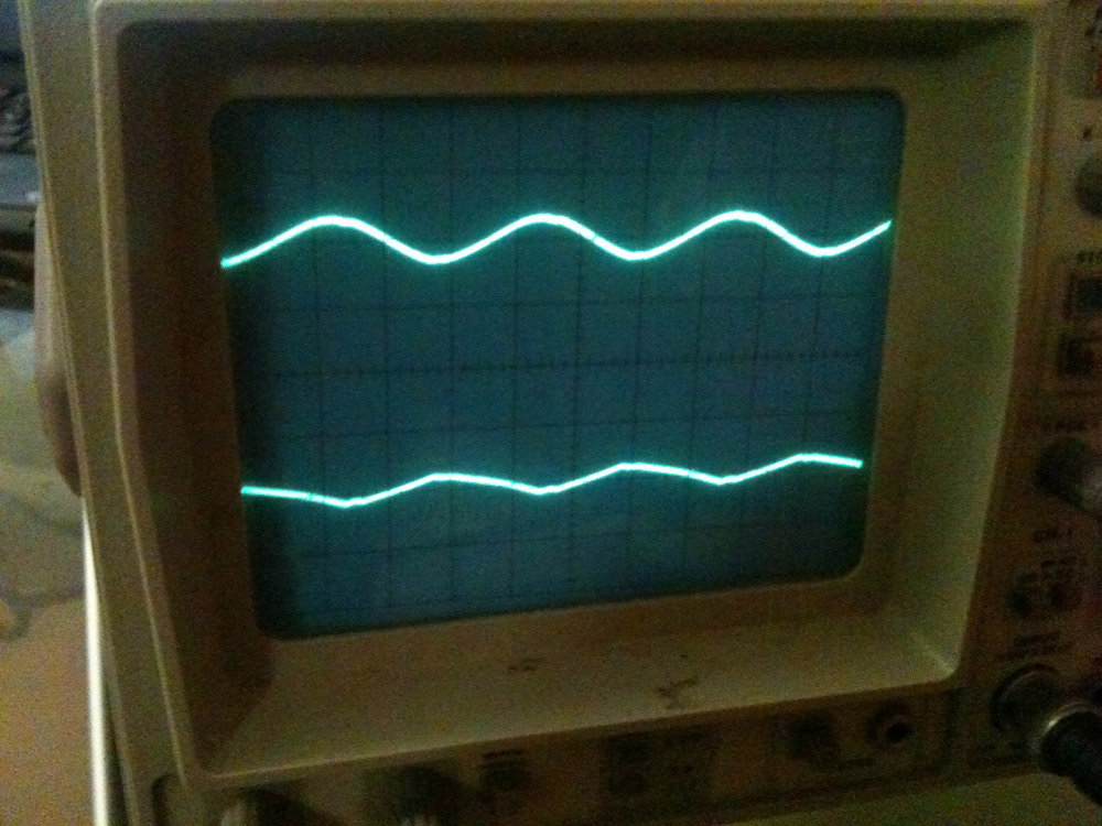

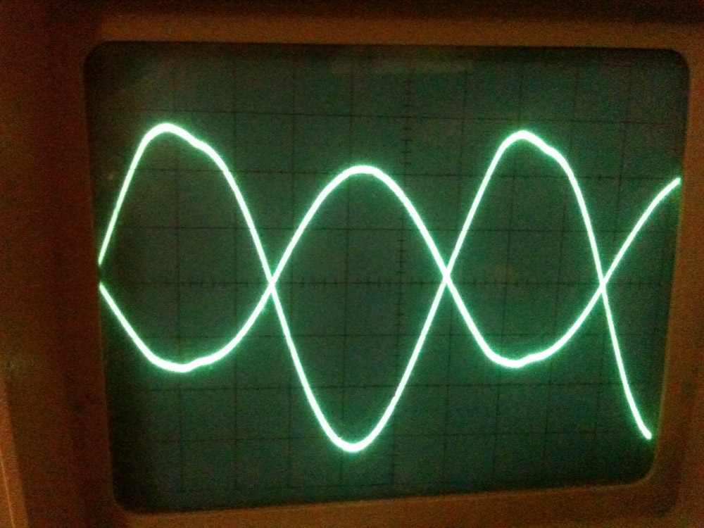

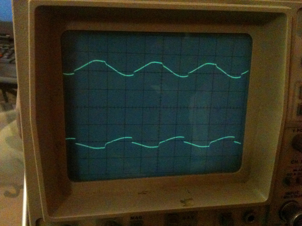

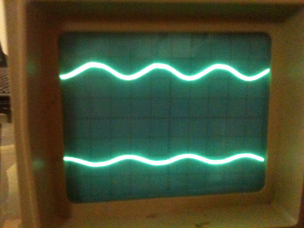

              I've just buy an oscilloscope, and I have done tests you told to KRISMEA about this post:
              Look at photos,it seems that my TGSL haves a problem...
              All pictures Were taken with 5V/Div. apart the tx-rx signal which was measured with 0.5V/Div.
              If I understand well my TGSL works around 16.1 Khz.

                Let's see, there are five different photos, and not a one has a description. But you do refer to another link, so what you posted is not a TOTAL secret.
                  Sorry, I've just see that...
                  Pic1 is point TX and RX signals at the output. (0.5 V/Div)
                  Pic 2 are points 1 and 2 (5V/Div)
                  pic 3 are points 1 and 3 (5V/Div)
                  pic 4 are points 1 and 4 (5V/Div)

                    16KHz is too high. That would suggest that your Tx coil is at 4.8 mH!! Should be 6.0 mH!! I would expect you to have some phasing problems and DISC not working right. Your Oscillator should be around 14.5 kHz and your Rx coil should be tuned to 16.12 kHz. Now just for checking the inductance of your Rx coil, connect it where you would normally connect the Tx coil. It should then oscillate at 13.9kHz.
