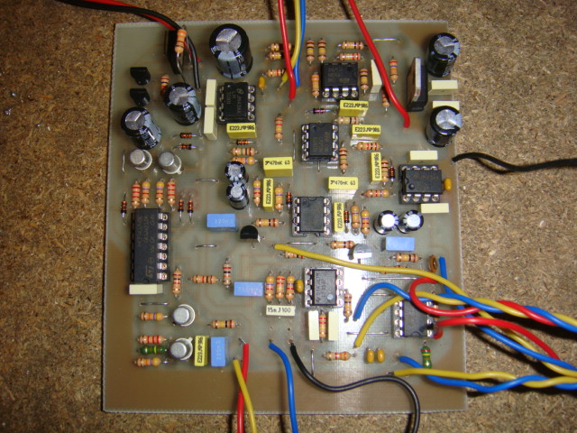

          hello has all! afflicted for this bad translation! then here is my problem: j' made the TGSL starting from the plans D Ivconic, the concern and when I start the bipppp test of battery sarète not j' saw that tiktak had the same problem (page 15 of the forum) but it used pn22222 in the place of the 2n22222; here I do not know any more or to seek. thank you d' advances for your assistance
            hello has all! it functions c' was well the 2n22222 on the other hand j' have many false signals when I touch wire or the circuit

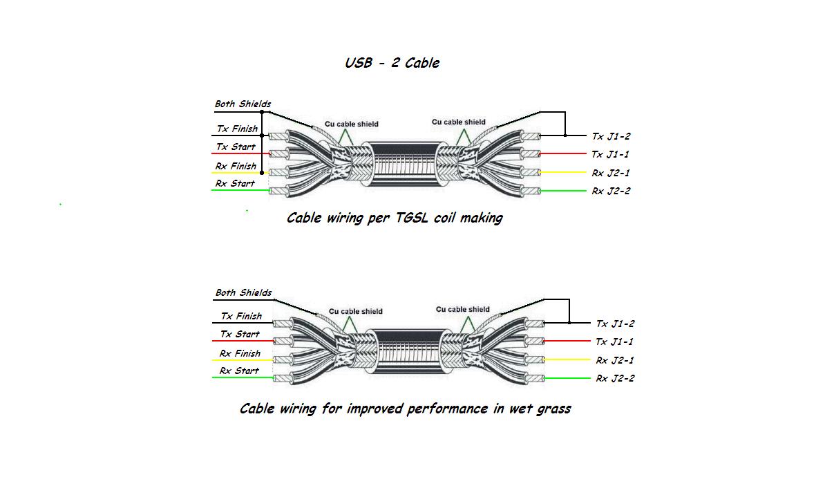

              Are you using a shielded cable and have you added a shields to your coils? If done, this should eliminate your problem.
              I would highly recommend trying to ground your coils as pictured below, using a standard USB-2 cable.

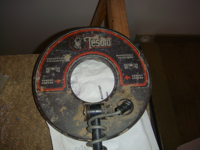

                      bonjour a tous,
                      j'ai des problèmes de faux signaux quand je touche les fils des potentiomètres ou le circuit. (je test avec une tète tesoro 8 concentric le fil et donc blindé )faut il que je monte du fil blindé pour les potentiomètre? j'ai vu aussi que le switch discrimination tout métaux ne marche pas je vous envoi une photo de mon TGSL.et le test de batterie ne marche pas non plus(petit crépitements)voila je pense avoir tout dit merci pour votre aide

                          Bonjour KRISEMA:
                          It will take some time for people here to analyze this, I hope you are patient.
                          Please tell us the exact PCB circuit you used since there are many versions.
                          It will probably be necessary for you to show us some photos of certain measurements with your oscilloscope.
                          Here is an example of useful measurements to take:
                          Look at messages #1 and #2. These are very good measurements to show us.

                            salut simonbaker
                            mon tgsl est celui de ivconic
                            je vais essayer de vous poster les photos ce week end , car l'oscilloscope est chez mon amis pas chez moi. en tout cas merci pour votre aide précieuse

                              You do not need to use shielded cable to connect the potentiometers (n'ayez pas besoin le fil et donc blindé). It seems that you have a fault in the circuit if the battery check and the all-metal switch are not working.
