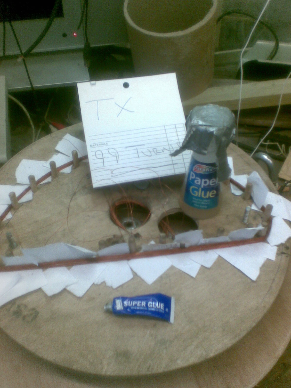

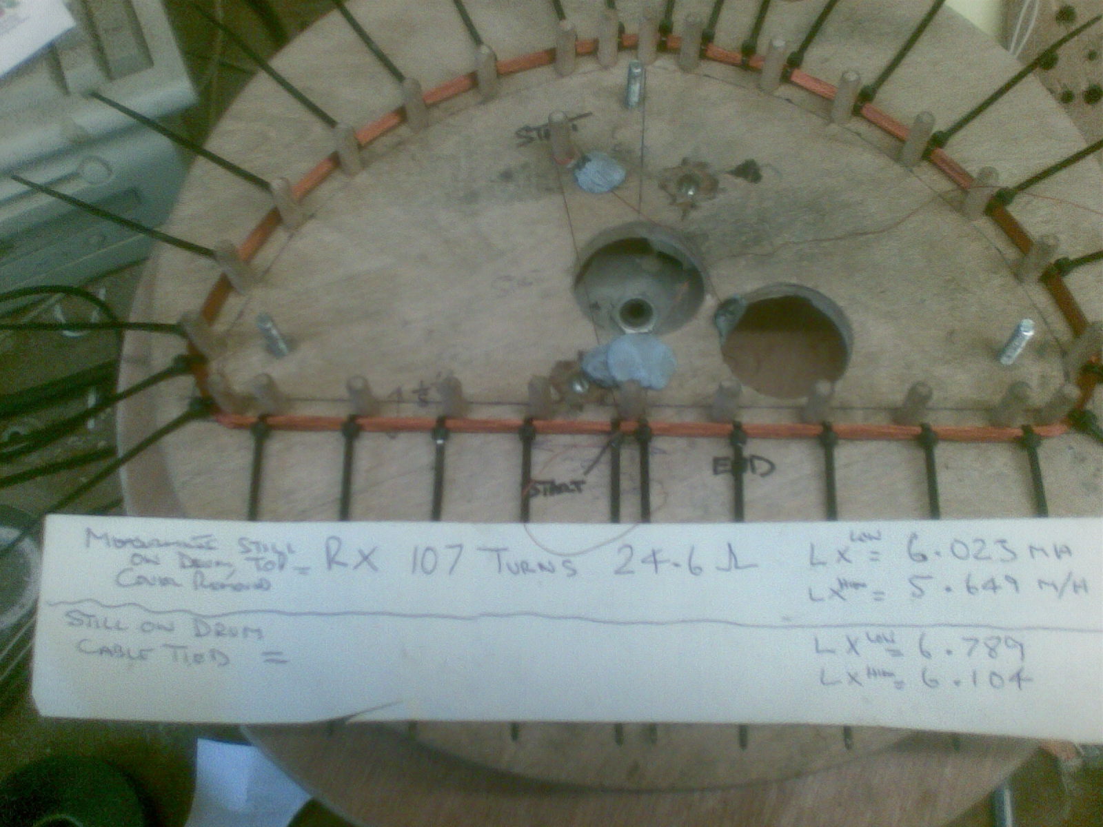

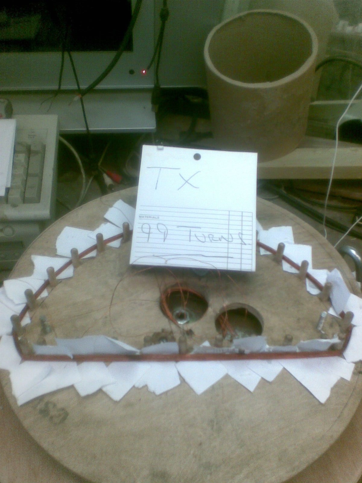

    Anyway my TGSL is finished far as construction, made case out of 2/8th styren made a few coils with my newly made electric coil mill with all the frills. Its been a good learning curve for me making these coils compared to the ones Ive made in the past for other machines, because although the 98/107 turns works for some of you it didnt for me, the TX coil no problems hit the 6.5MH everytime, Total opposit with the RX in fact I started doubting my inductance meter.Anyways with my set up Ive found 95/100 turnes TX/RX works fine giving 6.5MH/6MH at 23.5/24.35 ohms and I can churn them out fairly consistent by winding tight via a tention adjuster I installed on the feeder drum very easy to do as you will see in the pictures I will post later.
    Carefully taking the upper drum cover off small tempory cable ties to keep wire together, check induction/impeadence, spot glue, let dry, check inductance again, cut ties, lume as most of you do, check induction again, then glue all over/leave till following day.
    Now what I found is at this point with a little messing about get my 6/6.5mh quite easily, or should I say my meter says so.

    Dave,
    Yes! 5 turns difference between Rx and Tx is the answer I come up with every time with many coils. Even coil calculators show 5 turns difference. If I do the 98/107 combination I cannot get correct phasing. I can even vary the number of turns a little, but if I keep a difference of 5 turns the phasing is still correct even though the inductances are off. I am almost finished with a 9" coil and guess what.. 5 turns difference! 106/111 turns needed for correct inductances.
    C1, C2 and C6 come into play as well as how sheilding is done but if I measure the caps and pick the values closely I still need 5 turns difference.
    Don
      Same for me - I came to it when I messured L before and after removing one turn. On turn was 0.1mH....

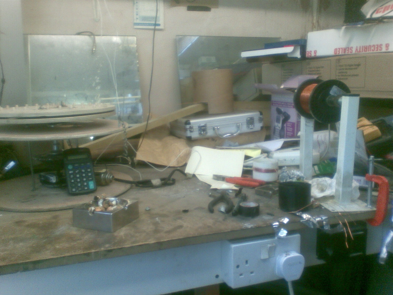

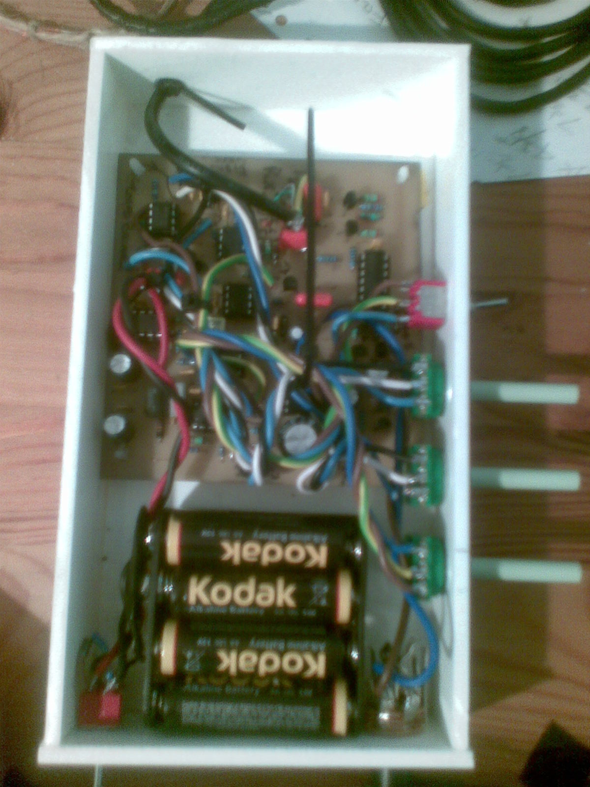

              pcb plus housing
              Hi
              Not installed the coil socket yet until im happy with the machine, makes life easer to take measurements etc, plus still waiting for the lm308s i think the last lot from hong kong were duff, but time will tell.

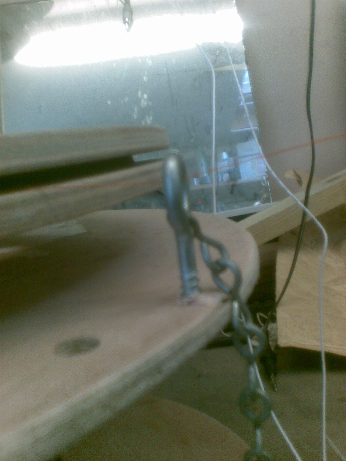

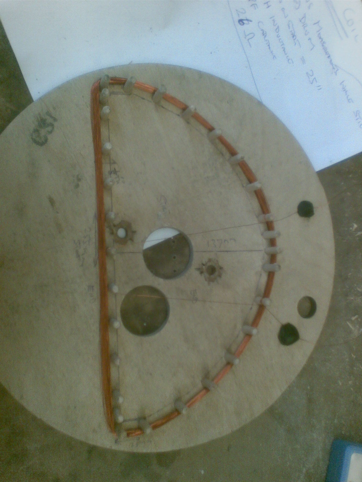

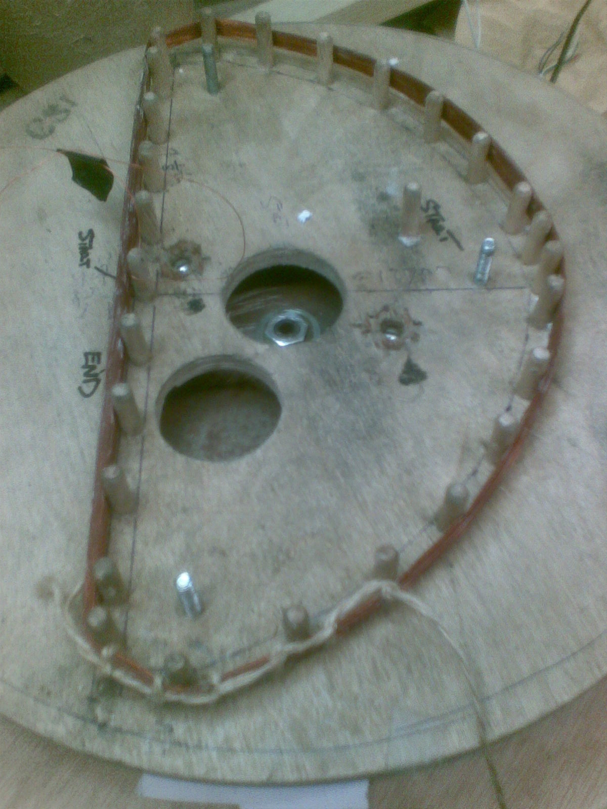

                some coil pics
                Some good some not so good as most of you know it was very much a learning curve.

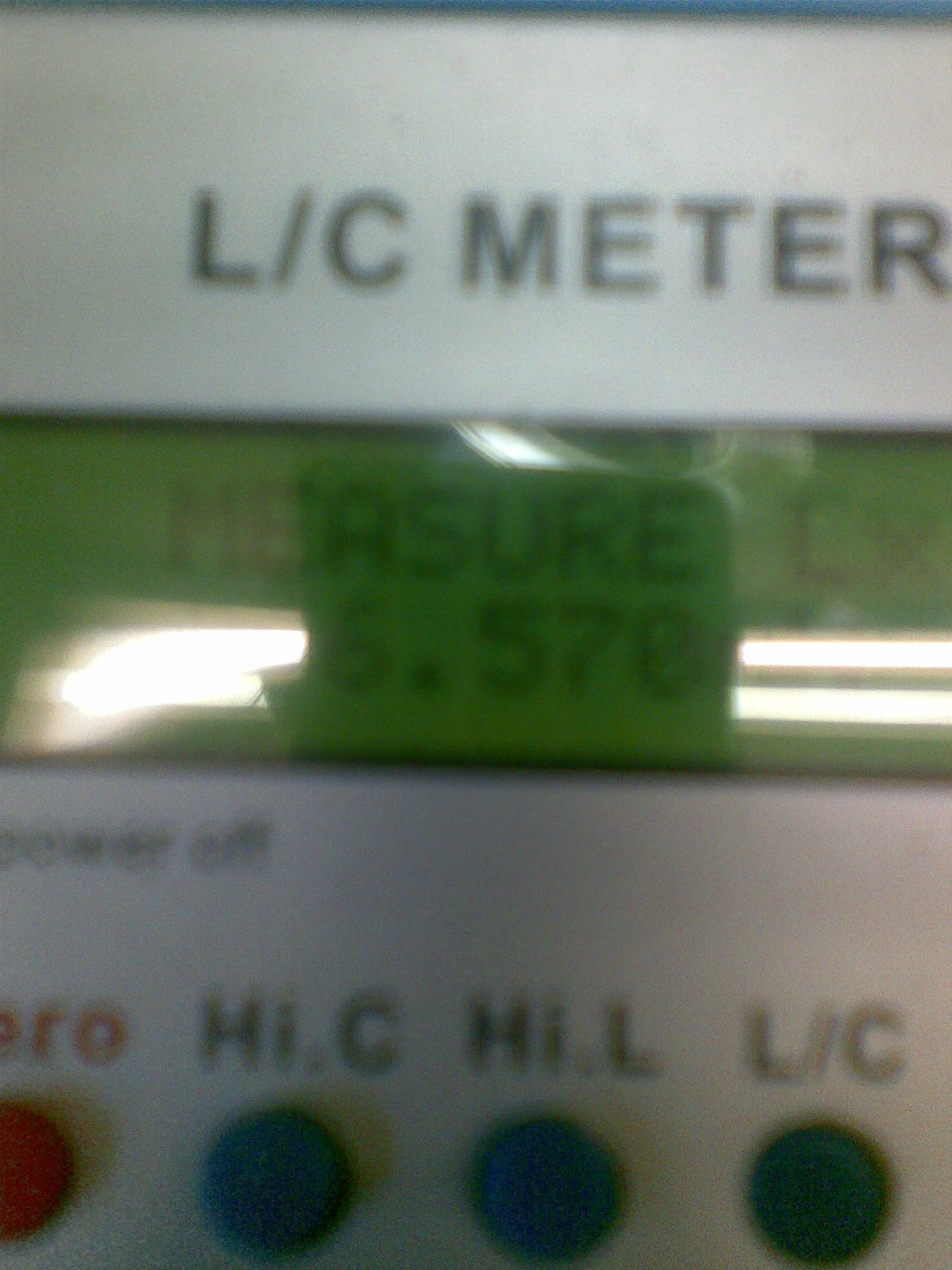

                On image 70 is when i started doubting my inductance meter, as you can see between high and low settings they are very much different.

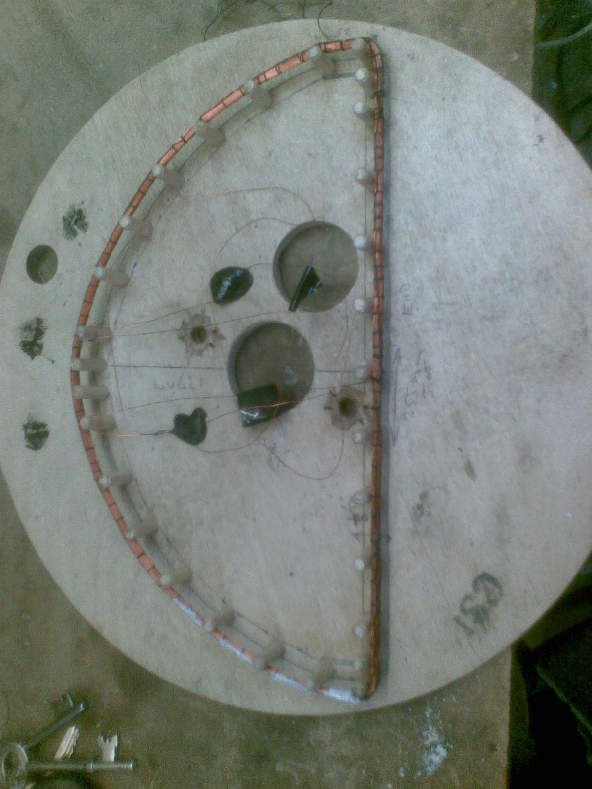

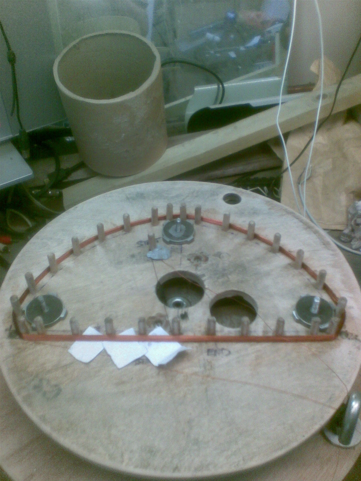

                  more coils etc
                  more pics, it was later i started to use bog standard kids paper glue on the wire leading into the drum, it sticks just enough to allow removal of top drum for spot glueing/lumming. not as good as varnish but no mess at all because where theres so much water content in the glue it just soaks into the wood, but just enough sticky to hold windings together.
                  Next time im going to try wall paper glue, it should work the same but a bit more sticky.
