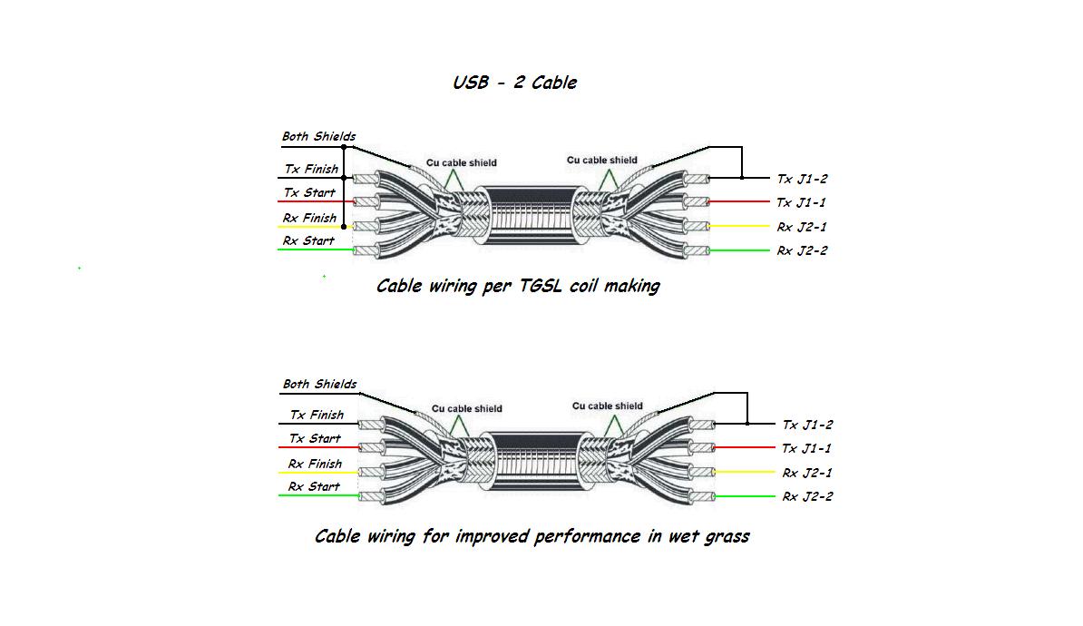

                        Faraday Shield loops.....
                        Originally posted by M.T View Post
                        HI every body
                        i don't understand about Faraday shield over coil
                        when finished the coil " Coil will have, than, 3 wires: start, end and Al shield (Faraday cage). "
                        the proplem is the other Al SHIELD !!
                        Upload, organize and share your photos with ImageShack. Fast, reliable image hosting with albums, privacy controls, direct links and resizing.
                        Don's advice is good to follow, but he neglected to fully talk about forming loops with the shield and its wiring, he knows ll about connecting with USB cable, but many use other types.........so I would just like to add the following comments:-
                        If you are using shielded or coax type cables, it's important that you don't make any "loops"...sometimes referred to as "ground" loops.
                        I in fact always use twin core cable, each core with its own shield, it's quality microphone cable, e.g. for two coils, I have 4 cores and 4 screens, 2 cores and two screens as one cable, therefor two cables per search head.
                        I connect two screens from one cable (for one coil) together and also to the Faraday shield of one coil.
                        I do not connect both Tx & Rx coils screen's together in the search coil.
                        I connect ONE screen (not from both cores on one coil), from each coil together in the electronics box....not both as that would make a ground loop on each coil.......
                        Although the working frequencies for VLF Detectors are low, I personally would never risk a loop.
                        If you are using a cable with two cores and a single shield, do not connect the shields both at the bottom and top, I personally prefer at the top in the electronics box, but then they MUST be insulated from each other in the search head......
                        I have no proof that a (ground) loop is bad in a metal detector, but I wonder if anyone reading here has made a loop and had sensitivity problems.....its possible.....it's certainly not recommended when sending low level signals over wires......
                        Ripping apart a well made search coil assembly to separate/correct shielding errors (and finding out that was not the real problem maybe!) is downright disheartening.......
                        Check between the shield for one coil to the shield of the other coil with an Ohmmeter to make sure that no shorts are apparent between the Tx & Rx coils.....before "potting".......Check afterwards too!!!
                        I hope I wrote this clearly enough, if not, just complain and I will try and do better......Any help from anyone else who understands about such loops would be greatly appreciated.....
                        Andy
                        PS. Anyone using this info for the IGSL Search Coil Head needs to be most careful when attaching the shield to one side of the Tx coil, you may cause a bad problem depending upon how it finally ends up. If phasing is incorrect, swap only the RX leads to the PCB, not the Tx leads.......I personally will shortly connect my IGSL to the coils, and I will connect the Faraday shield to battery negative, not to either side of the coil.......be careful!!

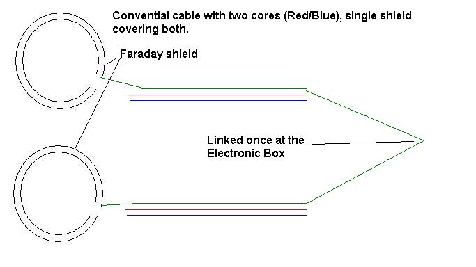

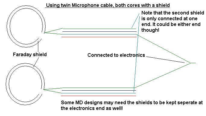

                            Loops in shield wiring - preventing them!
                            Andy, I can't believe your are from Germany. Your English is too good! I have thought about using microphone cable or audio cable for some time as others have. Can you do a quick schematic on how you run your wires? Maybe you already posted elsewhere.
                            I think that coil wiring sometimes comes down to availability and cost. USB cables can be bought almost anywhere and they are cheap! I only figured out how to get it to work with the TGSL. I would be using Belden otherwise for sure.
                            I like your idea and may build my next ISGL that way.
                            Thanks.
                            Don
                            It depends upon the cable type used to a great degree, but a shield may only have one connection to the ground plane.......many talk about "star" connecting.
                            Although I have never used USB cables personally, I have nothing against them, except that until one cuts it open, you don't know exactly how much was saved in very thin wiring.....I personally hate thin wiring as it presents an extra resistance.
                            I am sure that a good quality USB cable would not suffer from that......
                            I have added a couple of simple drawings showing the connection with twinCore cable and with Dual Microphone cable where each core is shielded, my preference....no loops....
                            I tend to bring all connections separately into the electronics box as I can both best measure and see that all is ok.
                            A typical mistake is to cause a short between the Rx and Tx Faraday's shield where they cross one another, make sure a good piece of insulation is placed in these 2 areas......(in most VLF designs that I have seen....). To stop a loop, you need to not use one of the shields, us just one (assuming its a low Ohm short....)
                            Andy

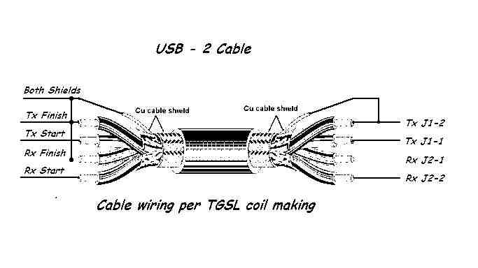

                                Loops in Shielding
                                Nice to hear from you Simon. I will try and answer your questions to the best of my knowledge:-
                                I have not seen a cable where the two inner shields are electrically insulated from each other -- but I assume they are insulated in your mic cable to satisfy your design.-SB
                                1) Microphone cable here is basically two tiny coax cables, with the outer insulation "glued" to each down one side, making a "flat" cable, the shields do not touch. For cables where the shielded parts are in full contact, that works as a single shield....(Belkin cable?)
                                I think the "USB" style cable does not really make a ground loop, does it? Unless you consider the TX grounded lead and the shield to make a loop because they are connected at both ends. But they have so little separation, could it matter? And the loop is outside the circuit.-SB
                                2) The original TGSL USB2 Cable connection diagram, has a very obvious loop in it if you look, its not the cable, its the connection method, the effects of which may be a lot worse than just "wet grass" sensitivity, if the truth were known.....(I have added that drawing below for quick reference.) The loop is via the shield and the black connection of the Tx lead, connected at both ends = a loop. Not forgetting what has been done with the coild shields if they touch anywhere where they cross over.......
                                However I like the idea of the TX pair and the RX pair being shielded from each other, although haven't seen it prove superior in practice (judging from dfbowers MDs). The USB cable does have a twisted pair for the non-power pair, which helps isolate.-SB
                                3) I personally don't like the idea of USB cables because I know that there is a lot of substandard ones with very thin conductors around. Chinese?
                                4) Also in a USB cable, the Tx and Rx coil wires are not separately shielded from each other, just all wires in together.....So you have a relatively high level Tx signal, traveling perhaps more than a meter right next to the low level Rx wiring where micro-volts are significant......it's just not my way to do that. Now if "TWO" USB cables were used.........
                                One problem with heavy-duty shielded cables is they perhaps can look like a lot of metal to the search coils, and so I'd think it even more important to fasten them down securely to prevent any jiggling.-SB
                                5) I would bet that coils that can only be nulled down to 4mVolts are suffering from pickup over such cables.....theoretically, well nulled means ZERO pickup.....(I will check the validity of this statement sometime in the next couple of weeks..... on my IGSL)
                                I have definitely gotten different behavior when I switched between USB and Belkin cable (couldn't get the Belkin to quiet down), but maybe some additional tweaking of the circuit would make them more similar.-SB
                                6) The "weight" of the cable does not seem to make any difference on any previous detectors I have made, future IGSL testing is planned.....cables must always be well fastened down....
                                7) As to why your Belkin cable didn't work, you would need to examine how it was connected in fine detail.....I cannot answer you there. That is the type of cable that really needs to be used to my mind. I believe Ivconic uses it too if I remember correctly on his machines....my mike cables are electrically similar......
                                It would be interesting to study the difference between grounding the TX shield to the grounded TX lead in the head or not.-SB
