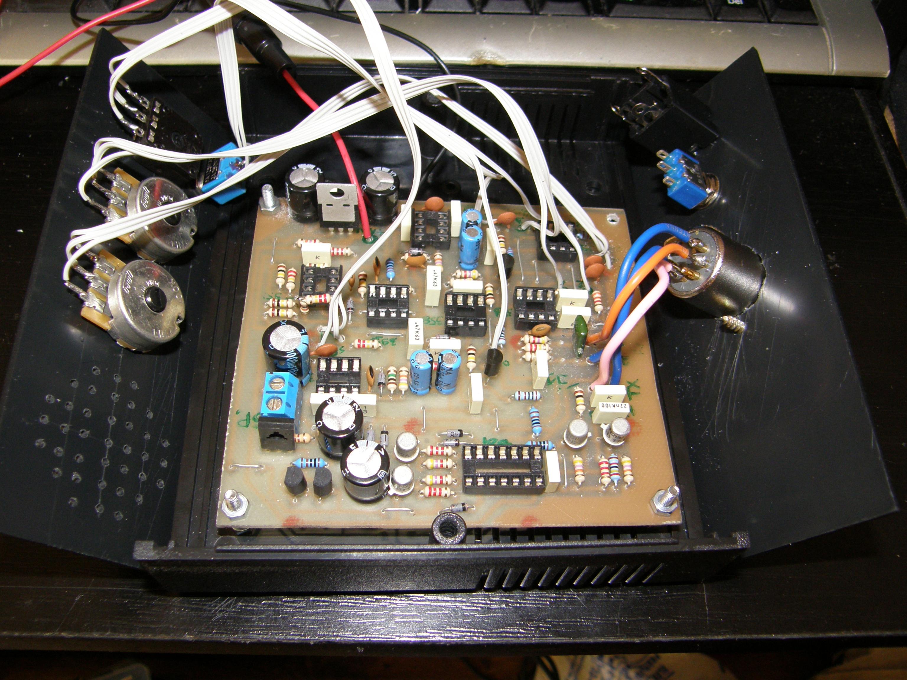

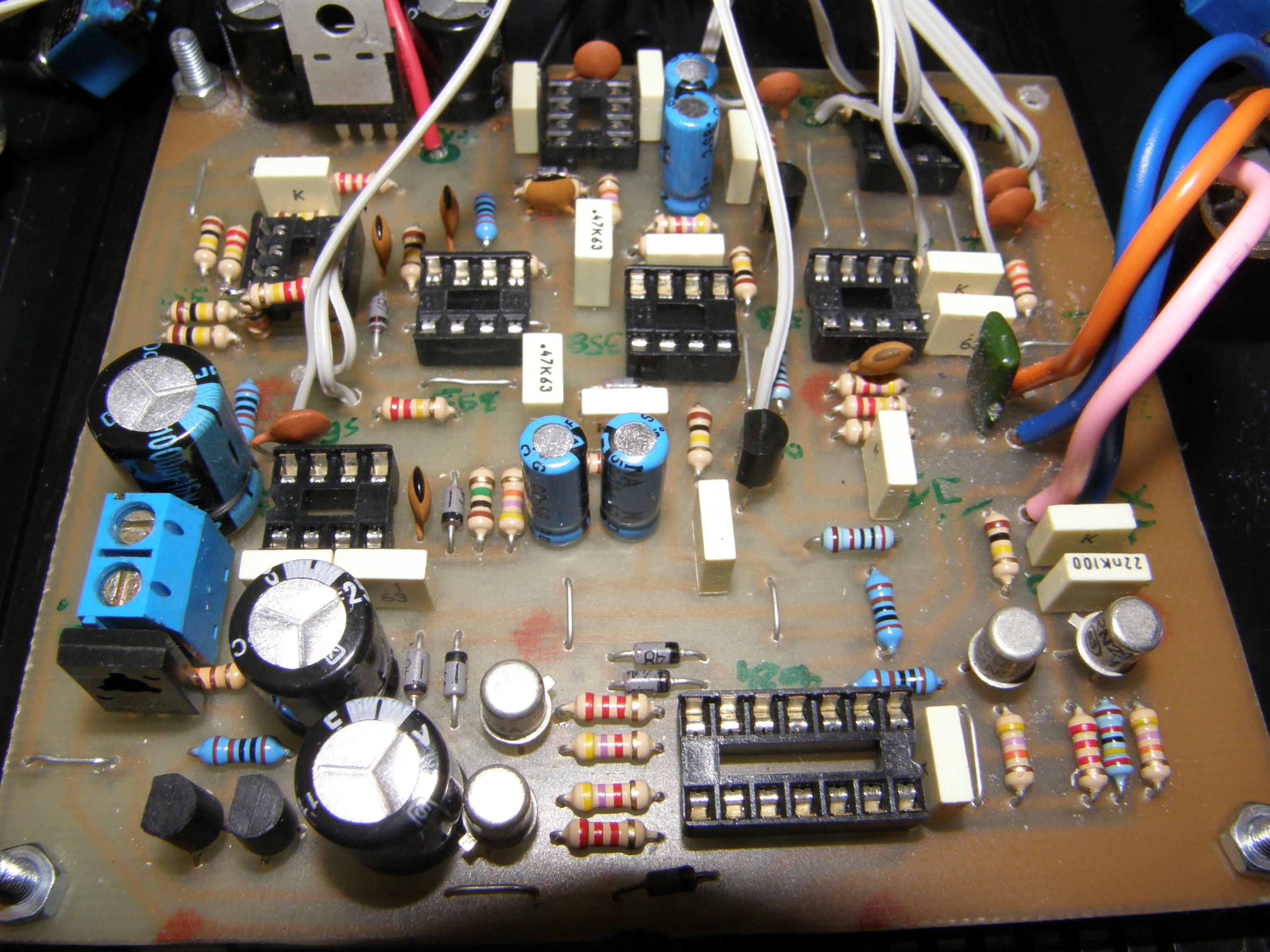

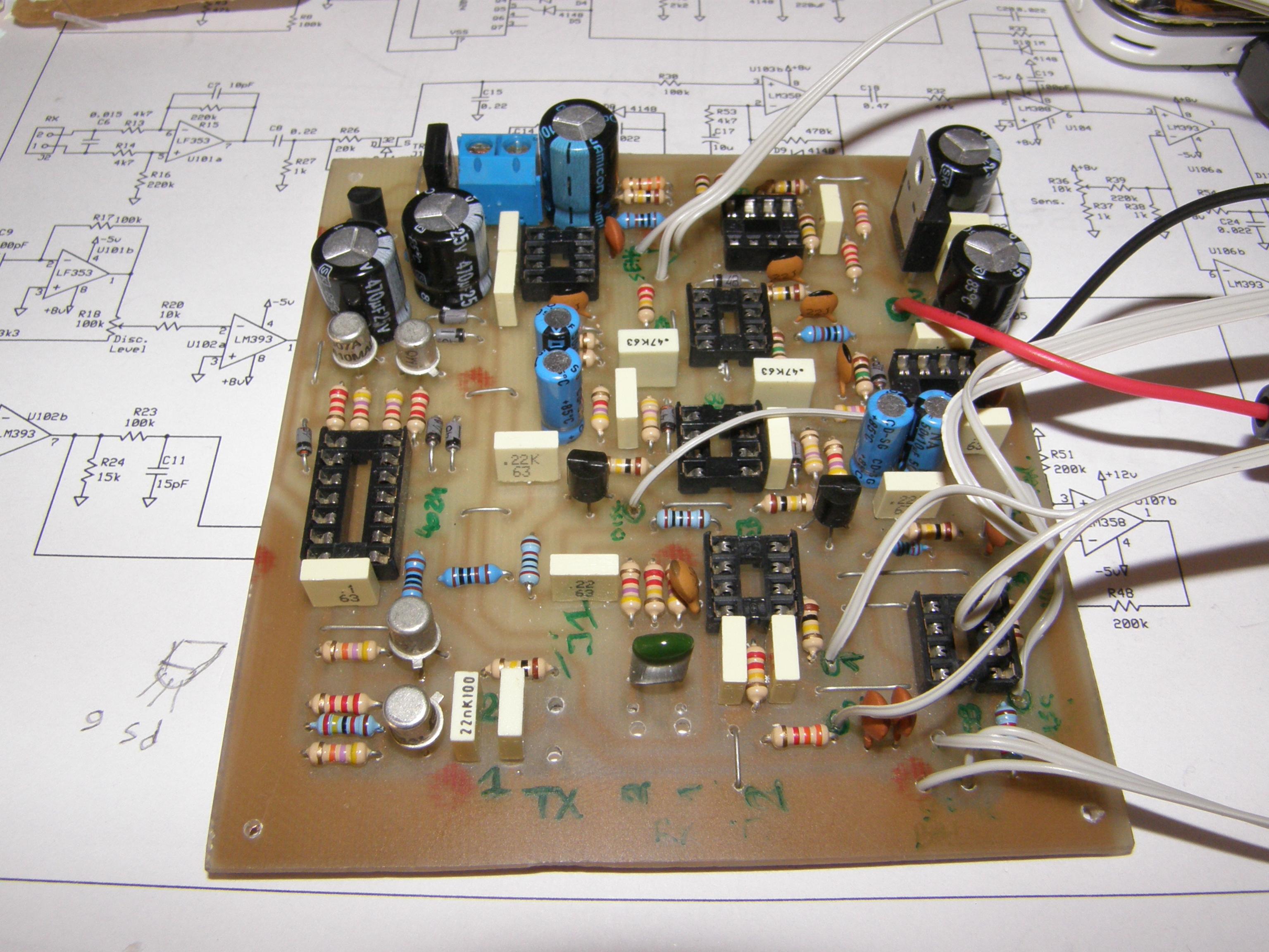

          • #50
            Hi, I have assembled TGSL and now on first run i have nothing from speaker, it is dead... no sound On the pictures sockets are not populated with IC-s, those are pictures of ongoing buiding. I have 7.9v after 7808, and 0.802v on pin 4 of LM358 (u107b)

            • #51
              My chopper didn't work, i fixed that, now i have problem with oscillator
              • #52
                I fixed oscillator, it oscillates on 14KHz but can not null coils, i have 119mv on pin 7 of U101a
                no matter what i do, move coils or turning them upside down it is still the savme 119mv, any idea?

                          Sounds like you have a very basic problem either with the way that you are measuring or with U101a. Do you have a scope? What happens if you measure the frequency at u101a pin 7? I just want to verify that you can see an amplified sinewave.
                          • #58
                            I found mistake, rx cap 15n were damaged and shorted, now i have rx and tx, and it works. i have nulled coils not so good, i have 300mv on pin 7 but i have to build coil in housing so then i will null it properly , now i have 10 cm for Serbian 5 dinars - it is similar to 1 Eur.
