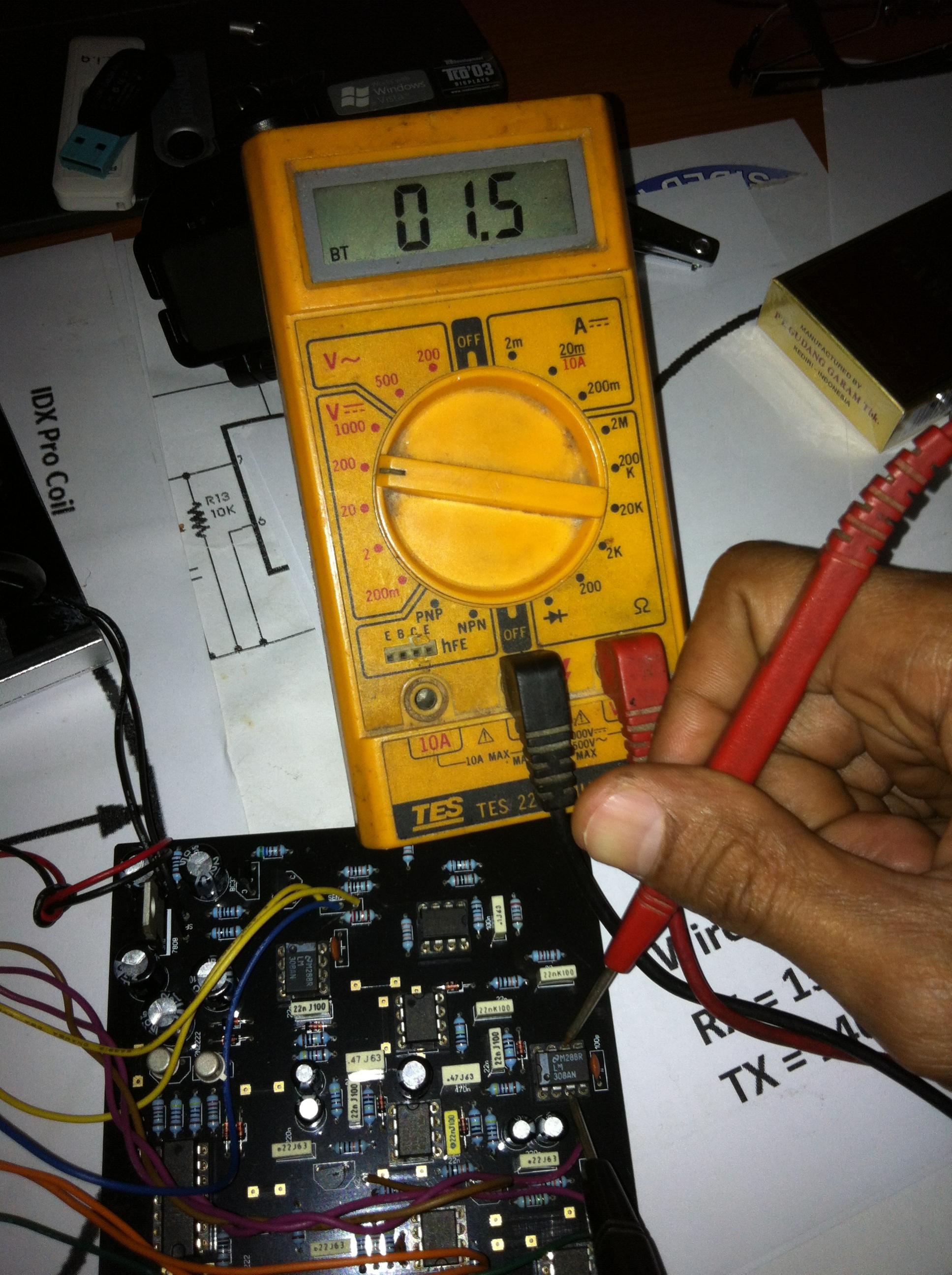

            I have Problem My TGSL Long Beep Only
            I Just Got Long Beep
            what is that problem
            Need Change Some IC or What I need To Replace Help! Help Help! Help!!

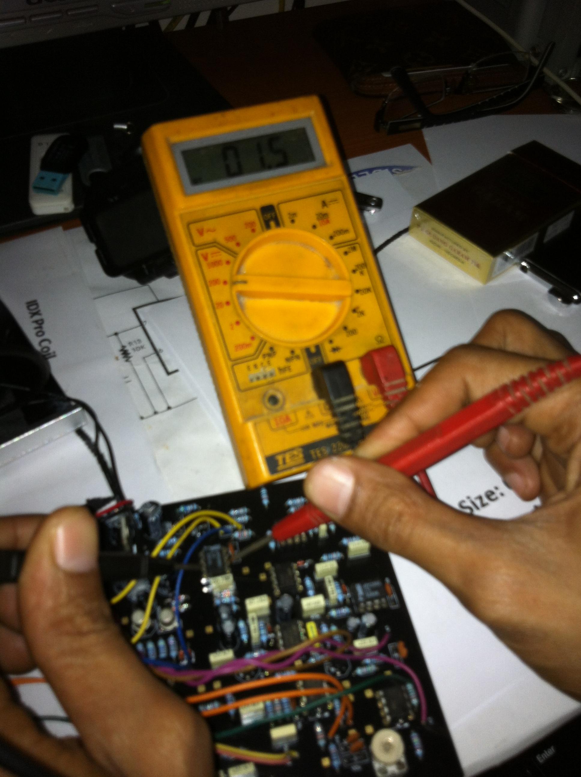

                  Can you measure DC voltage values at pin6 of both U104 and U105? You can use pin3 as reference (ground).

                      i get 1.5 from U104 and U105 same 1.5 without coil

                        And there is your problem :scratches a belly:
                        Could you make a photo that shows these two chips and the surrounding parts? 1.5V is 2 orders of magnitude too much.

                          It True The Test is Look like This Bro

                            Maybe your testing method is not perfect. Your instrument is set to 200V range, which is far far away from the expected +/- 2V. Could you repeat measurements with instrument set to 2V range. Before you start measurement, please connect the instrument pins together so that you can confirm 0V, or whatever value you get so that you can deduct it later. If it remains firmly around 1.5V you must have some completely unexpected problem.

                              i have set meter to 200v and i get 2.7v U104 and U105
                              is that right test or rong
                              • #60
                                Wrong. Put your instrument to 20V, confirm 0V by short-circuiting the instrument pins and repeat measurement. If you get results below 2V, put your instrument to 2V and repeat. If there is nothing moving on top of your coil, you should measure very little voltages in mV range.
