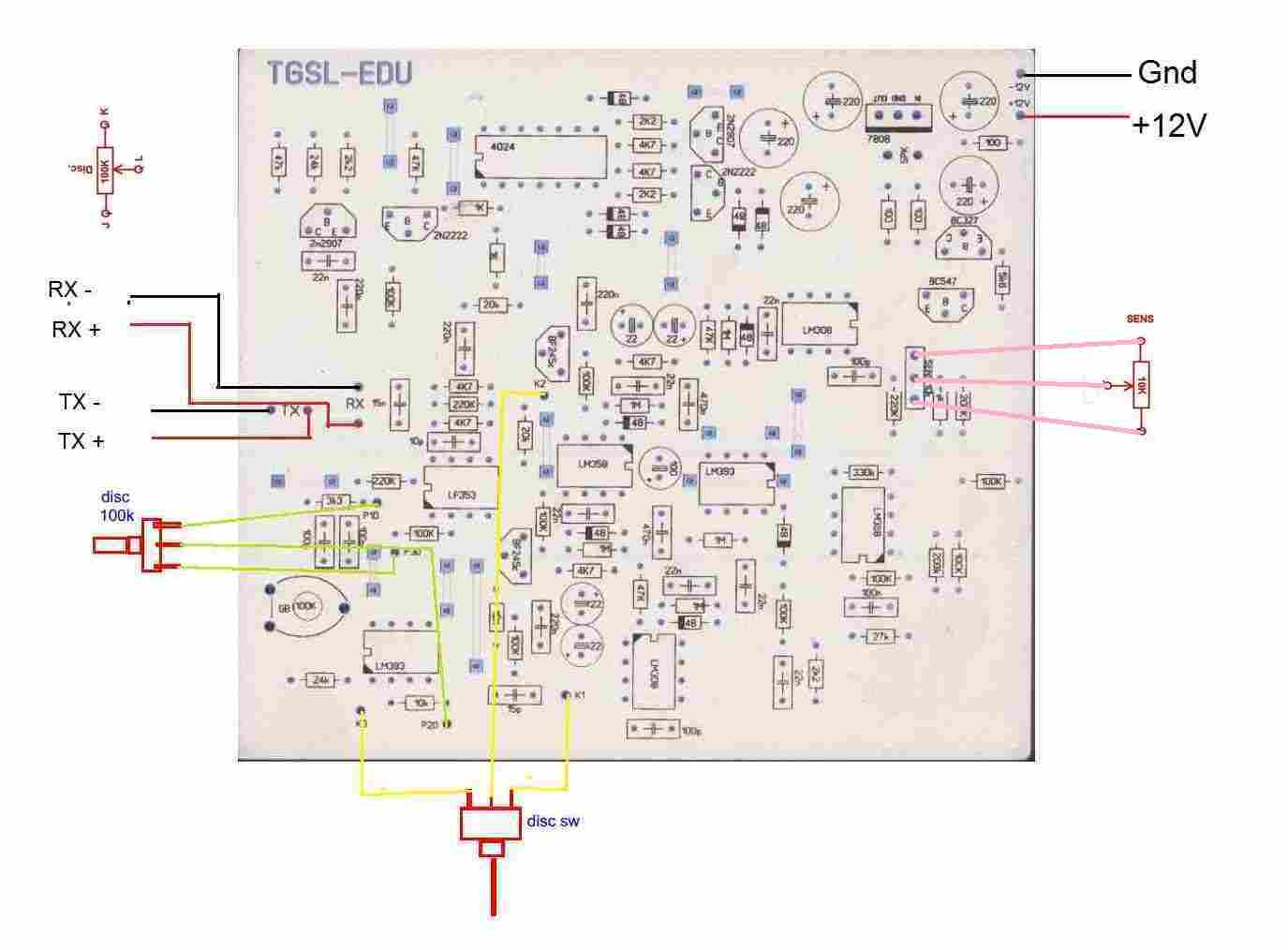

      Finished the TGSl-EDU build but can't seem to find information on connections...
      Found: Supply, Speaker, Sens (10K) and Coils but can't find connections for second pot and switch...
      Are K1, K2 and K3 for discriminator switch?
      P10, p20 and p30 for discrimination level?

          Originally posted by silverdog View Post
          [ATTACH]36071[/ATTACH]
          Looks like I got them right but I don't trust my eyesight...
          Thanks that's perfect... Magic
          One more question Andy... are the transistor markings correct or should I check orientation?

            I believe they are correct, watch the 2N2222 orientatrion as I supply a TO-18 style

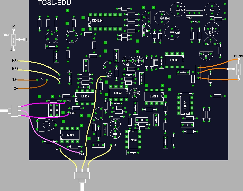

              All transistors appear to be correct...
              Here's a quick vector image... Click image for larger version
ID:	345657 it's a good deal clearer...
              Mike
              PS... Op-Amps names should be correct (I had difficulty reading some IC's part names after inserting sockets and image was a little unclear)...
              If it's of any use to others, I can correct and add component names and values etc...
