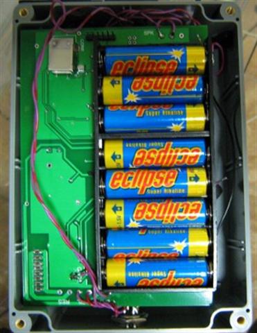

Here's one I prepared earlier
  • Here's one I prepared earlier
    Assembled and put in a box.

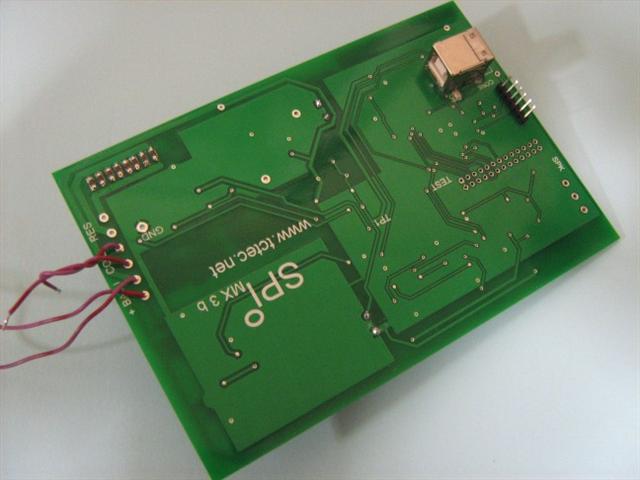

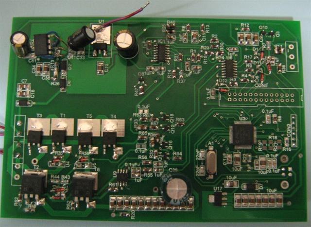

    Very pro PCB look, Tec.
    According seen parts used, I'm interested in what is its power consumption?
      power consumption
      Thanks.
      It draws a total of 152mA:
      ~ 80mA goes into the coil pulses (100uSec pulses at 580Hz)
      ~70mA for everything else, mainly the pic32 which is running at 20MHz.
