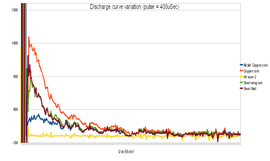

                  I scanned this a while back, (the 400uSec pulse is irrelevant), but the response of different targets is the main thing I guess.
                  The X axis is 0V to 65mV threshold voltage.
                  It is not balanced, so is is measuring the curve lifting up as well as shifting sideways.
                  A balanced will look more interesting, I would like to plot one and see how it looks.
                  (X an R response of balanced systems is not my area at all, or the phase shift of sine waves vs amplitude change.
                    So your curves disintegrate below ~5mV. OK, it gives you a whole decade to work with. Now just apply some averaging of the samples, even addition should do, and plot the curves for 5 to 50 mV range. This looks a bit hairy.
                    BTW, did you optimise damping resistance?

                      They are old plots from a different system (1 year ago)
                      Here are some recent plots (today) from the SPiMX.
                      All targets are 15cm from the coil in the center.
                      On a fast coil, 5 mV crossing may occur at 10uSec, on a slow coil 5mV crossing may occur at 50uSec
                      So, on this particular system and coil between 1mv and 8mV corresponds to 17uSec to 41uSec
                      I have set it up to use the signal at 30uSec (2mV) to find coins at the beach and park.
                      If you want to find a piece of gold the size of a match head in a pit of powdered iron, just make a faster coil and a use smaller pulse width.
                        Precisely! It all is about finding small stuff in a difficult soil.
