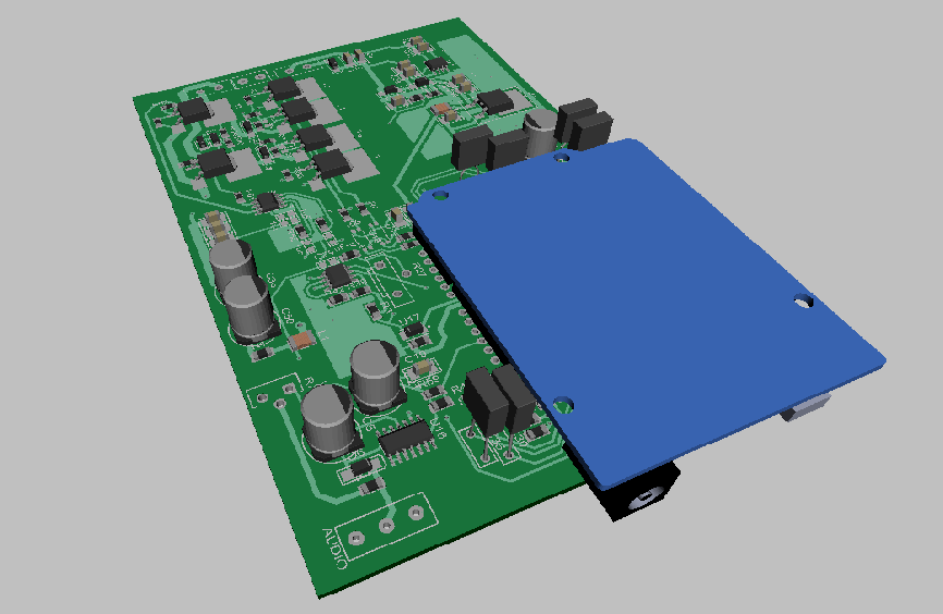

    Building a new version of the SpiMX , the 'Spi MX Shield', the improvements are:
    1.
    Using an Arduino Leonardo as the micro controller:
    Ready to go, can plug it on , don't have to worry about assembling a micro controller.
    The code is tidier (written in c, not arduino language), the previous pic code was messy.
    I think arduinos are great hardware platforms.
    2.
    Completely different sampling/analog part. It is more like other PI designs;
    The coil signal is amplified, gated (sampled) and then measured with an AtoD.
    3.
    Automatic sampling gate.
    Sampling is triggered by the coil discharge. It is always synced to the 'knee' of the curve.
    4. Simpler and better switching of Mosfets.
    It still shares features with the old design:
    Bi-polar pulsing
    Conductivity calculation.
    I have only tested the prototype, it seems quieter and deeper, am going to assemble a PCB soon.
    Hope to see some of the code soon. I have also been experimenting with arduino in a PI detector. Do you use a separate ADC?
      No I am using the built in 10 bit ADC, fairly low resolution, but it is quite fast.
      The Leonardo has built in 2.5V reference..
      The signal has been amplified , averaged , and amplified again by the time it gets there..
      as a ripply DC signal.
      The ripples are the pulses, and the sampling is synchronized to the pulses, so this noise is removed..

                Thanks for the code.... Oh boy, atmel studio 6... Wonder if it is portable to other Platforms, I am using Linux with the Arduino IDE. I guess if it is written in C I might be able to use the code.
                  I have spent one evening porting your code to the ARDUINO IDE. Seems to compile without errors. I can't test it on the hardware yet, I am waiting for my Leonardo Board to arrive from China ;-). Also, haven't looked at the schematics yet...
                  Are you interested in the ino file? It only took a couple of changes to work, which I can explain in detail later...
                    Re sketch files
                    Hi Joop,
                    I am definitely interested in the sketch files, I can test it here.

                          Here it is: SPI_MX_3b.txt. Rename the file to extension .ino before loading it into the arduino IDE.
                          All of the code is in one file.... there were only 3 minor changes: PD5 was replaced by PORTD5, GlobalInterruptEnable() by sei() and GlobalInterruptDisable() by cli(). I left out all of the unused code, like loading the config from eeprom. Hope that's okay for now, it made the code easier to read for me.
                          I had a quick look at the schematics. Some parts don't have values, like IC1, U6, U8, U10, U11, and U17 in the analog signal diagram also U16 in the supply and micro diagram.
                          Yes, a PCB would be nice and I am willing to pay for it. I think this is a nice effort!
