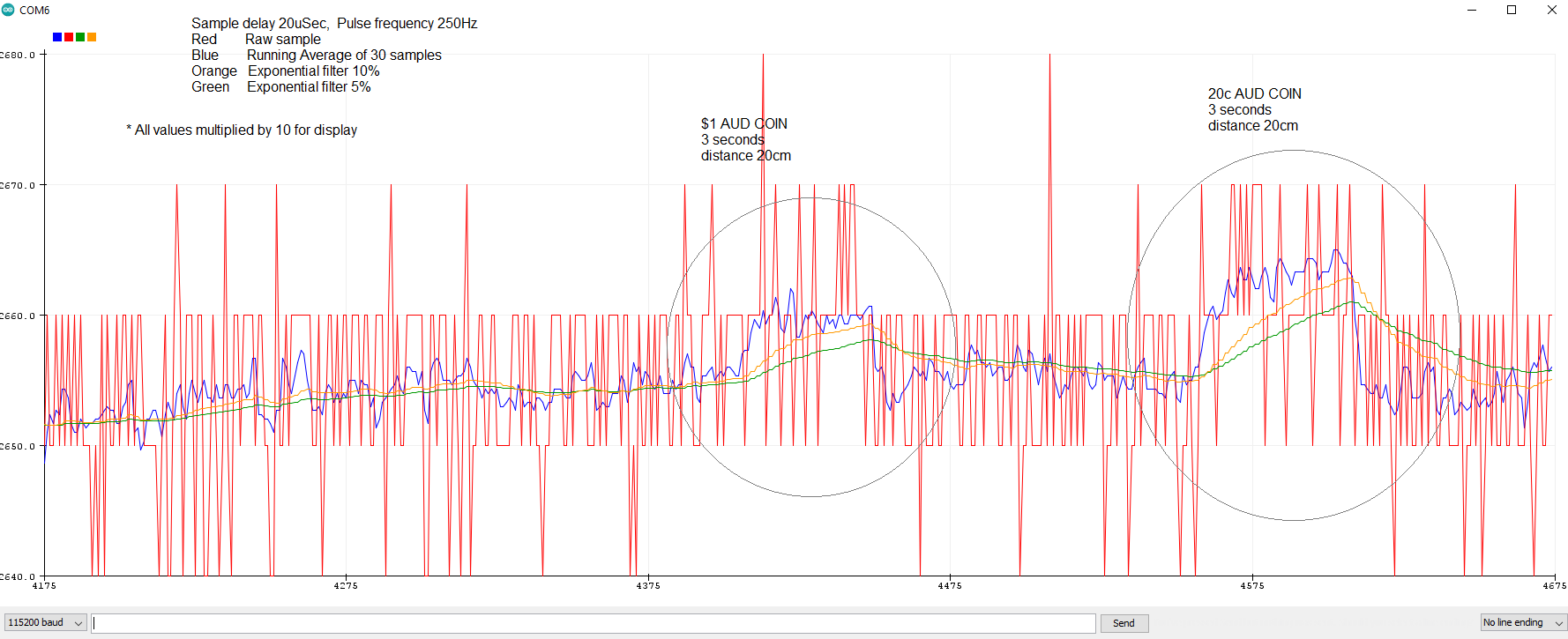

    Note on noisy signals above: This is the running average of 50 samples. (300 pulses per second average of 50 samples)
    Atmega328P, reference 1.1V, preamp gain 14, ADC at 500KHz, IIR filter based on 64 samples...
    This is enouh to build a nice PI

                            Signals: Raw vs Averaging.
                            *The 'Raw samples' is one Raw sample in block of 50 for indication. (Instead of displaying all 50 raw samples)
                            * The Signal is at the resolution of the AtoD, i.e within one bit of the 10-bit A to D.
