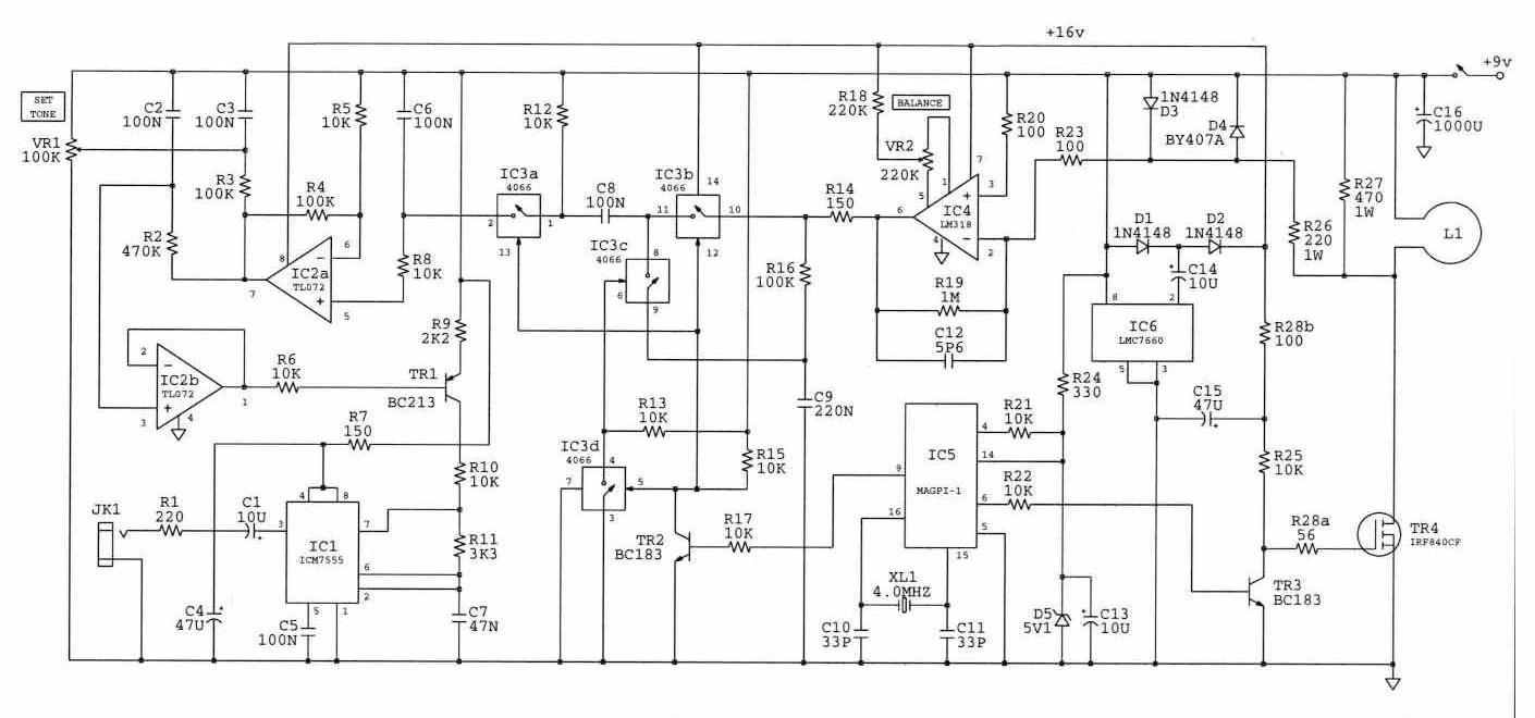

    I attempt to buid the Microcontroller PI treasure hunter by Mark Stuart and I notice mismaches between PCB and diagram ,coil must be connected at 9V, VR1 (100K pot) I'm not sure(at 9V or at 16v), anyway voltages are ok 16V and 5V
    but when I want to test it I hear a tone in the headphones but I can’t vary the pitch of tone with VR1(see section TESTING in document stuart2.pdf) Also I take the
    source code written for 16C84 (pi84.asm) and put in MPLAB IDE (Microchip tool) and try to build it (compile) for 16F84, errors appears ;
    I don’t understand the comments in asm file, they are not written in english. I fogot to mention that I burned the hex file found on Carl’s page into a 16f84 because microchip don’t make any more the PIC 16c84 and can’t find it. Please help me with more information...

            Re: EE Treasure Hunter
            Hi Arjoca,
            Here's the schematic. Note C4,R26,R28b, and VR1 connection.
            Cheers
            Kev.
              Sorry Arjoca, still mistakes !
              Now please note: Coil connection as you are already aware and R27 - along with C4,R26,R28b, and VR1 connection
              ta
              Kev.
                I don't believe it, yet another !
                Sorry I sure hope it's right now. Note IC4 Pin 7
                Along with Coil connection, R27, C4,,R26,,R28b, and VR1 connection all different from original.
                Cheers
                Kev.
                  This is embarassing. Faultless sch?
                  I should have looked more closely before uploading the first schematic, sorry about the space Carl.
                  Note: IC4 pins 2 and 3.
                  Pin 2 is the inverting input not 3
                  Added to changes on the schematic from the Stuart 2 PI construction pdf
                  IC4 pin 7, Coil and VR1 connection, R27, C4, R26, R28b,
                  Cheers
                  Kev.

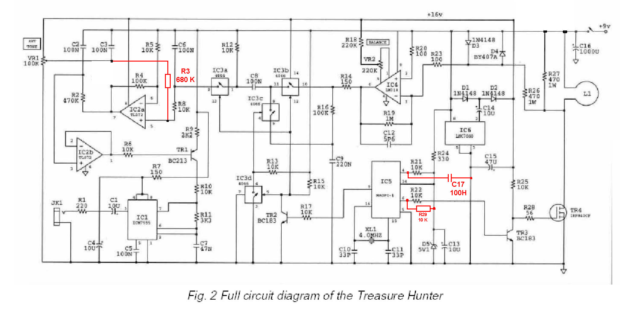

                        100H
                        In this post, "http://thunting.com/geotech/forums/showpost.php?p=29089&postcount=3" the attached schematic shows C17 as 100H.
                        Someone maybe convert that into uf,pf or nf?
                        tia
                          tia
                          100 nF=0,1 uF
