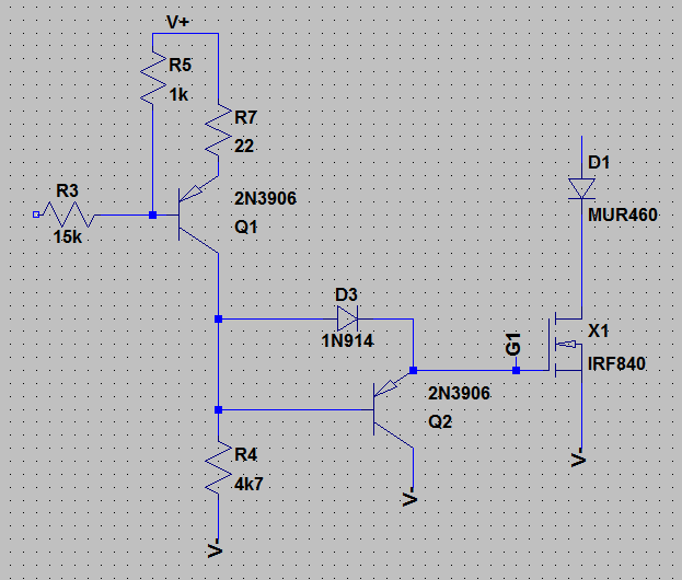

                  Nice. There are a few goodies lying about. You may even connect a voltmeter at TP102 (after a LPF at, say 10Hz) to act as a crude ferrous discrimination.
                  I'm not sure NE5534 will be happy with 110 ohm loading. Even if you increase it 5 fold it will still be fine regarding input noise, even with a better op amp.
                  There is also a simple but faster MOSFET driving circuit.Click image for larger version
                      There is also a simple but faster MOSFET driving circuit.[ATTACH]34413[/ATTACH]
                      Yup, the original input amp was made from pure unobtainium ($50 a pop) so I dropped in a 5534. I know the original worked because it's in an existing design (not yet released but working none the less). I agree, maybe making it 100R and R106 1K might be a better idea. THe plan was to keep the Gaussian noise as low as possible.
                      Re the updated driver. Feel free to add it to the design. I take your point and bow to your experience in this area, but this driver is OK for the application, doesnt need to be any faster (yet). Lets see how it performs once the bugs have been driven out.
