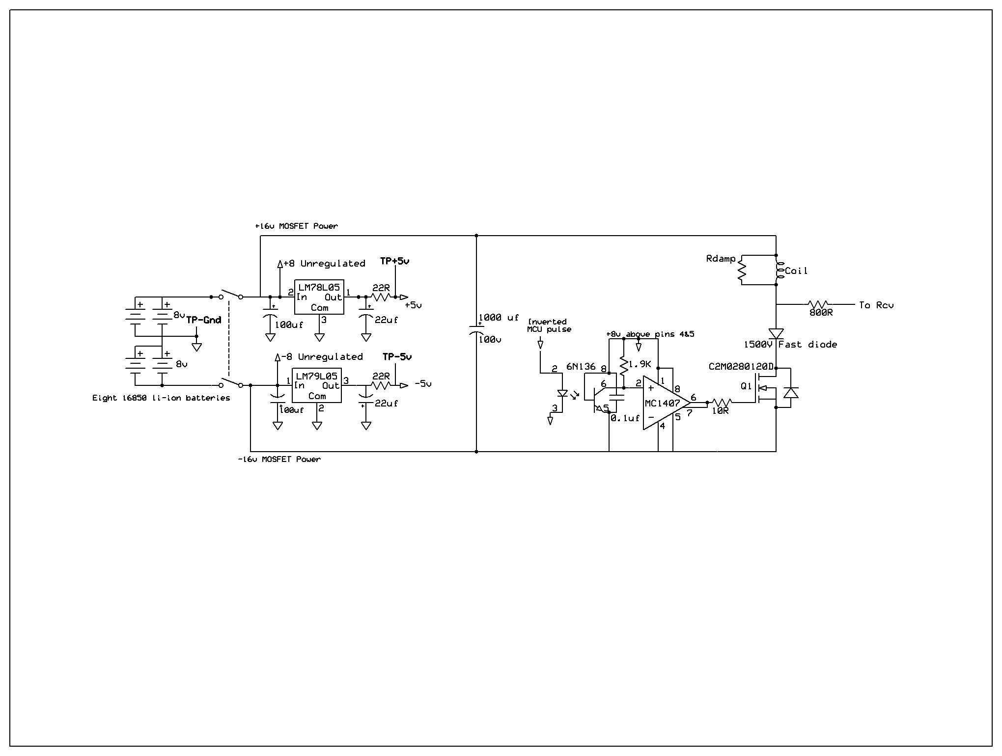

    This is a suggestion to move any discussions relating to the design of the power supply here. One major point that I feel should be discussed is whether the PS should switch or not. After spending a good deal of time thinking about how to design a non switching, rail split type of design, I do have some reservations about this this technique. The biggest being what happens when the transmit and audio currents are dumped into the ground? These can easily be 100mA or more and so it would seem a stiff ground is required.

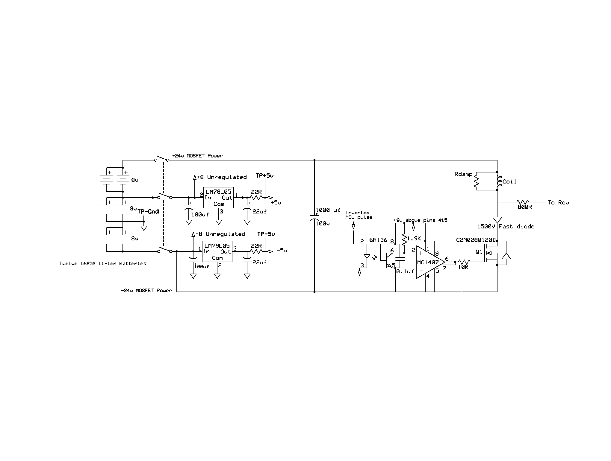

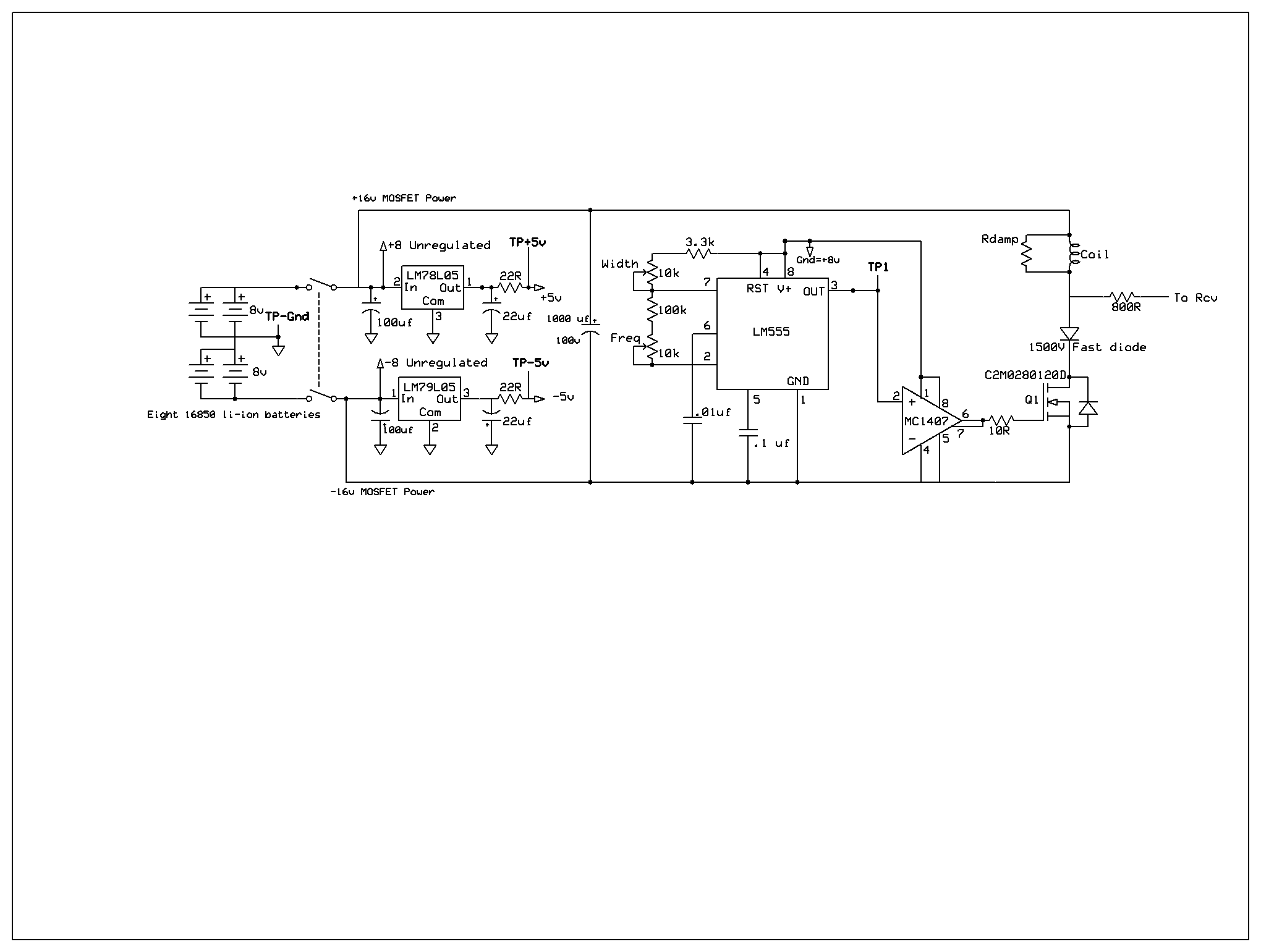

      Attached are some alternate power supply ideas to consider and work with. A few thoughts went into them; more transmit power, no noise from voltage converters and some separation between transmit and receive circuits. Circuit boards should have as much copper area and heavy traces as possible to help prevent ground noise.
      Have a great day,
      Chet
        Here's the power source to work with my preamp.
        There are no large capacitors in the analog paths to avoid shifting baselines in the analog signals.
          I think a mosfet in the negatice rail witha soft start optio to stop the inrush current damaging the switch contacts might be an idea. I like the opto isolated method, but is it fast enough to get a good switch on an shut off time on the main FET? Also, what about a lov value (like 100R) in series with the gate to sharpen up the edges (maybe a 10pf) across it too? I haven't run simulations on these ideas.

              Hi Teleno
              I like your power and drive circuit. Is there an advantage of using set and reset pulses from the MCU versus using Pulse Width Modulation (PWM)? Or another choice a flip flop and driver?
                      Have a great day,
                      Chet

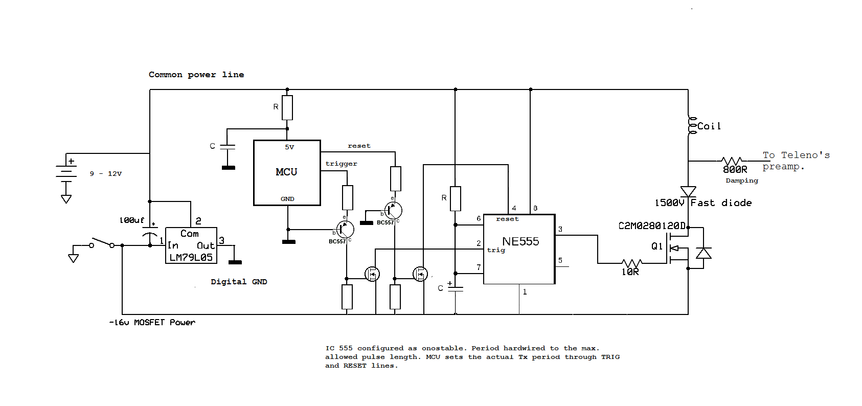

                            Hi Teleno
                            Yes. The maximum (safe) Tx duration is harwired in the monostable. The MCU cannot accidentally cause the Tx pulse to be any longer. It's a safety measure to avoid blowing things up in smoke.
                            If the MOSFET is driven directly by the MCU and a glitch gets the trigger pin stuck in "low" then the MOSFET is turned on permanently, which is bad.
                            My schematic contains a mistake, though. The circuit as it stands is a "retriggerable monostable" and it should be non-retriggerable. See the difference here: http://electronics.stackexchange.com...rable-one-shot
                            Better than a 555 would be monstables CD4538 or CD4098.
                              [Better than a 555 would be monstables CD4538 or CD4098]
                              The 555 has higher output drive. You could capacitor couple the trigger.
