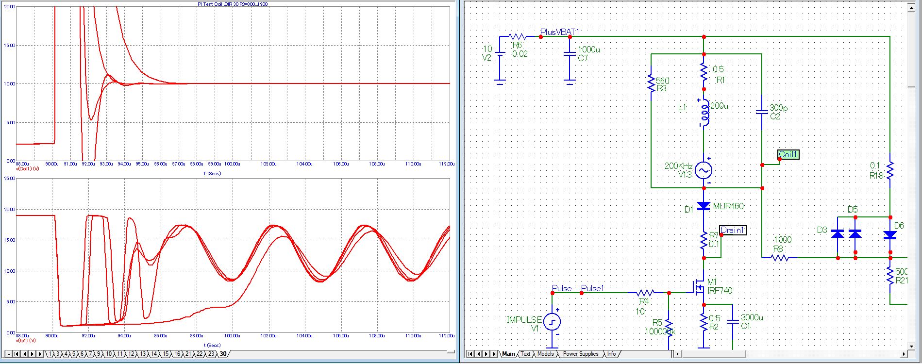

    Little Update on how this whole damping resistor thing went lol basically the appointment with local electronic shop was a bust! The gentleman offered me the use of the scoop and a variable resistor tool, but could not take the time to help me with it, Sadly I never seen let alone used a scoop so ! as nice as his offer was I am no further ahead, But he did offer me his tools anytime free of charge, So if I can learn how a scoop works I could use his. seems cheaper then buying one Right lol but how hard is it to learn how to use one without having one. Anyways, so coming back home I used my bread board and made the resistor tool that Giaozhi kindly drawn out after many hours of dancing with changing resister value ( which to take a measurement I had to unplug the coil, measure resistor, and plug it back in) fallowed by many a pond many air test and delay tuning, HAHAHAHA as you all can guess its not working out so well, For time being I settled on a 565 Ohm resistor which seems to work But ...... I still can't get more then 7"on a usa nickel and its scratchy at best. Brings me to a question, Is it even possible to reach 12 inch or more in depth with the sur pi 1.2?

                    Hello,
                    The damping resistor avoid to have too many ripples on the flyback voltage.
                    When at the good value of damping resistor, the voltage at the input of the OPA is at the values to be amplified without saturating. So it makes the circuit quicker.
                    Also, as small is the parasitic capacitor, and as hight the frequency of the ripples is , (or as short in period time there are) so smaller input value is , quicker the amplifying is possible.
                    I will try to attach a spice capture, with 4 different values or damping, on a 300ยต coil.
