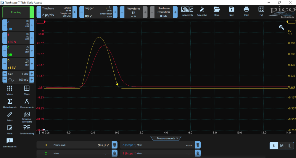

        I was playing with the circuit today, so I took advantage of taking a screenshot of the Flyback and the damped RX input.

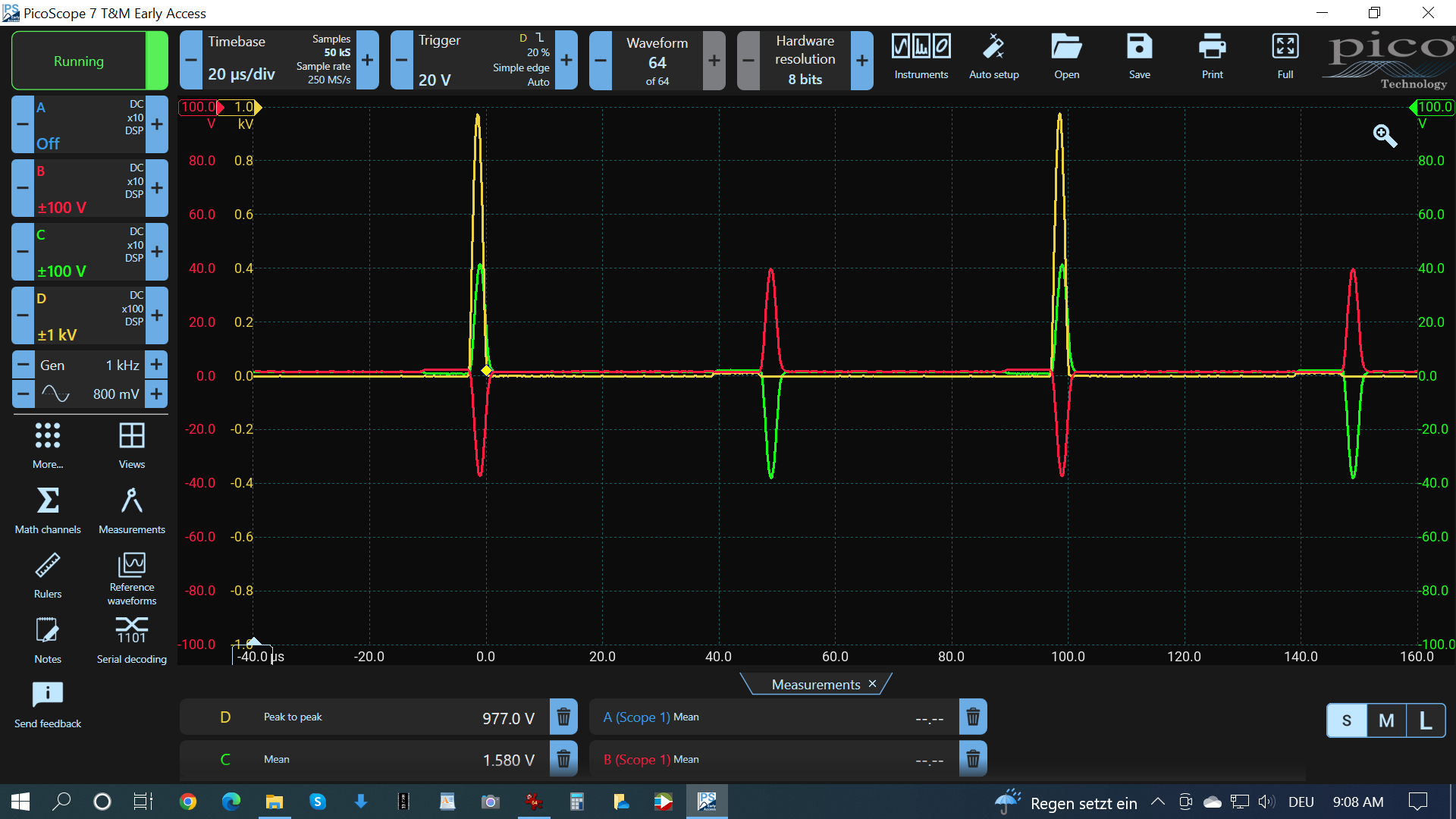

              You run this type of PI 5-10khz normally as its always working /no dead time/ you switch polarity and so you have doubled flyback response on each polarity switch and you get the flyback response shown there in the previous picture.

                    Here is a better picture of the Flyback, TX in yellow and RX in red and green.
                    Unfortunately I can only show you one of the TX Flybacks, because I have only one high voltage scope probes.

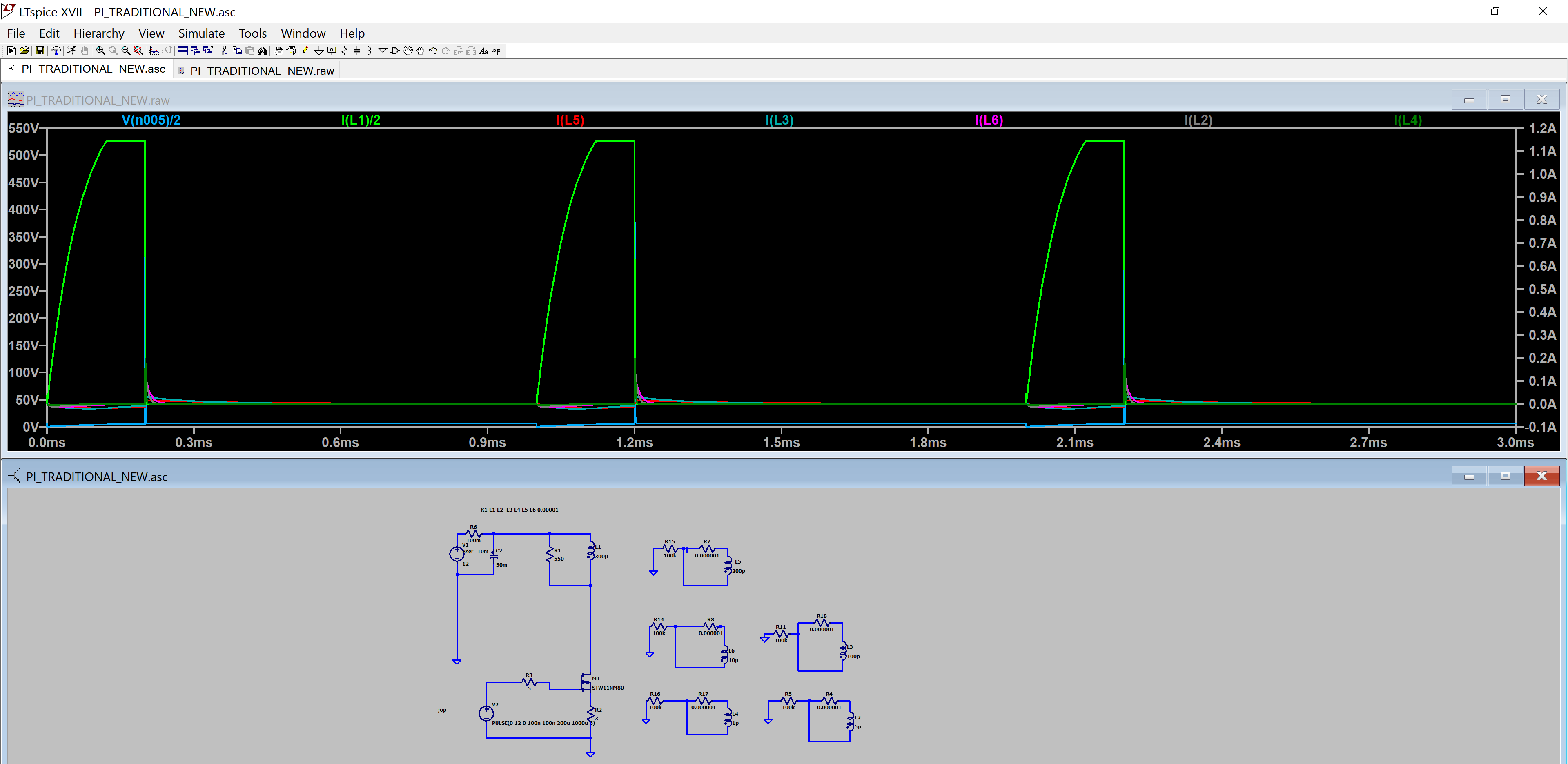

                                Traditional PI Flattop coil current
                                The important part is the "flattop". The time where there is no change in the coil current.
                                Let?s have a closer look at the ?flattop?.
                                Here is the simulation of a traditional PI TX.
                                We see the current ramp up to maximum and then stay flat. This is what we call the ?Flattop?
                                You are welcome to try the simulation yourself and change the variables.
                                L2, L3, L4, L5, are targets of a TC of 1us, 5us, 10us, 100us, 200us.
