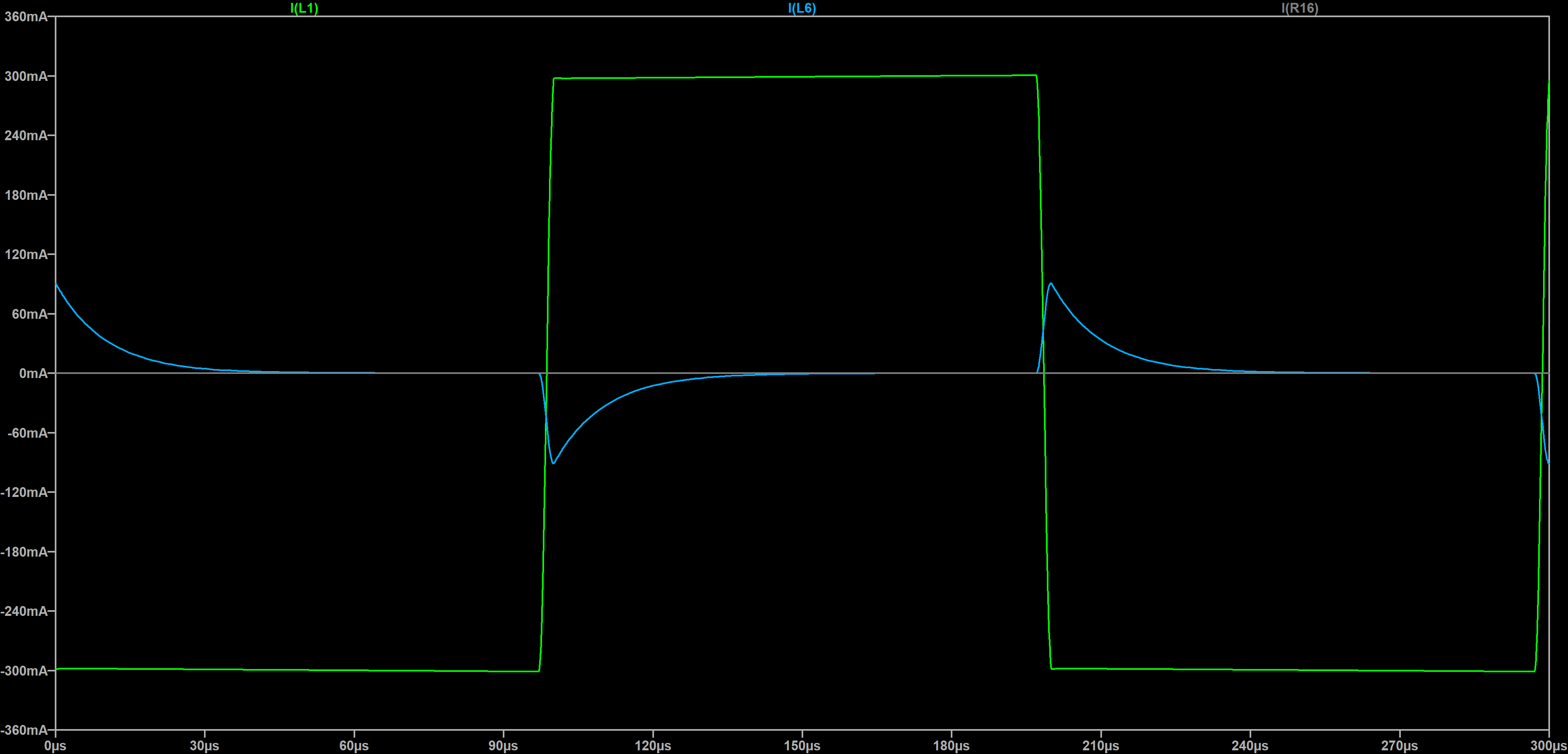

                  Here is the SQUARE WAVE simulation.
                  SQUARE_WAVE.rar (reply #44)
                  Ran the simulation. Tx current not flat topped, slope about 30A/sec. What parameters are measured and controlled to get Tx to flat top?
                  • #54
                    Thank you for the feedback, green.
                    You are correct.
                    It is far from a perfect square wave. The verticals are actually exponentials. The "Flattop is sloped about 3mA over the 100us of target receive time.
                    Unfortunately, there is no perfect electric world.
                    The slope shown is due to the ohmic losses.
                    What can we do to improve? In general, reduce all the resistances in the circuit.
                    The high voltage Mosfets used in the simulation have a relative high resistance. We use better ones in the real circuit.
                    I also found that using genuine Litz wire for the TX coil makes quite a difference in reducing the impedance.
                    Fine multi strand, tinned wire is the next best.
                    But for rough tests I just use magnet wire. Spacing the coil loops with fishing line reduces the interwire capacitance.
                    After reducing the total current path resistance / impedance as far as possible we still end up with a slight slope.
                    How much slope does matter?
                    How much eddy currents in the soil or target does it need to be detected?
                    The "Flattop slope" will affect a target with an TC of 5 times the slope time most. With a slope length / time of 100us that would correspond to a target TC of 20us. Let's look at what the simulation says.
                    To eliminate the slope completely we need to replace the ohmic losses at every cycle. DEEMON's original design already included a circuit for compensating the losses. If we do not like his compensation circuit, we can invent our own. In our prototype we control the current by micro-processor. For myself, this means that I dial-in the amount of compensation I want in a parameter file.
                    How does the slope manifest itself in the RX? basically it shows up as an offset.

                      So, let's talk about some of the improvements the SQUARE CURRENT WAVE offers over the traditional PI TX.
                      1) We can use a much higher repetition rate. A higher repetition rate means we can integrate so many more cycles. This improves the S/N and the signal amplitude.
                      2) Considerable les power consumption for similar results.
                      3) Much less limitations as to the coil diameters / amount of coil turns.
                      4) Automatic Earth Field compensation.
                      Any questions? anybody?

                                I've been trying to figure how to measure change in coil current during the target sample and ground sample periods. Any thoughts?
                                easy with the simulation, don't know how with real circuit.
