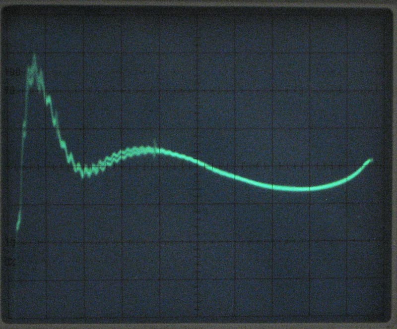

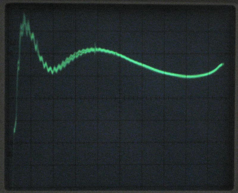

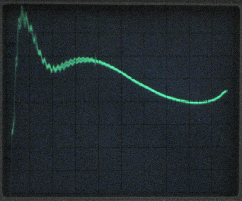

    In this thread I am going to show photos taken of the oscilloscope screen, with different targets.
    The first 3 photos share the following parameters:
    Oscilloscope settings:
    Vertical = 200mV / div.
    Horizontal = 1uS / div.
    The photos show the output of the preamp, TAU TWO.
    Preamp gain is 100
    I will start with large targets
    # 1 – No target

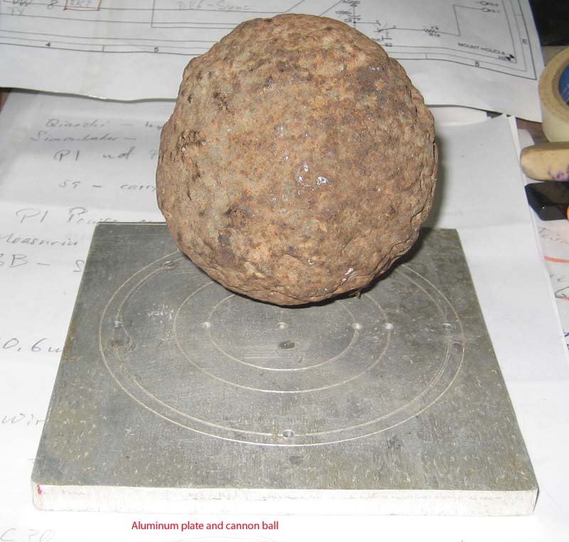

    #2 - 5.5 Inch by 5.5 Inch by 0.375 Inch Aluminum plate, AG4 alloy at 30cm from the coil.
    #3 – 6 pounder cannon ball from an 18th century shipwreck, about 3.5 “ diameter, at 30 cm from the coil.
    # 4 Alu plate and cannon ball
    As can be seen, this is not a good detector to look for cannon balls.

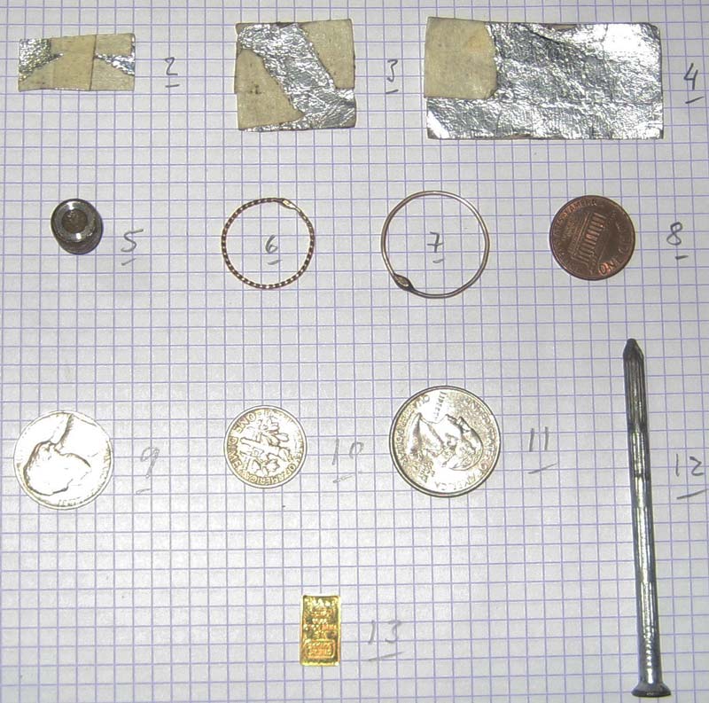

    Here is the set of small targets that I will show next.
    It starts with a 1/2" square alu foil. this target has a TC of about 5uS.
    With a gain of 100, this is the smallest target that shows with a Oscilloscope setting of 200mV / division.

            Here is the listing of the set of targets.
            Small targets:
            The photos show the output of the preamp.
            Preamp gain is 100
            The targets are very close to the center of the coil, about 3mm above.
            # 1 – No target
            #2 – 0.5” square alu foil
            #3 – 1” square alu foil
            #4 – 1”x2”sqare alu foil
            #5 – 15mm x 10 mm steel lug from a roller bearing
            # 6 – 0.5 gram gold ring
            #7 – 0.55 gram silver ring
            #8 – Penny – US$ 1c
            #9 – Nickel – US$ 5c
            #10 – Dime – US$ 10c
            #11 – Quarter – US$ 25c
            #12 – steel nail in the vertical position
            #13 – 1 gram gold bar
            Tinkerer

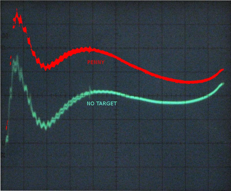

                    The silver ring is target # 7. It would be ideal if the "no target response" could be superimposed with a different colour on each target photo.
                    Nicolae
                      Here is the response of the Penny, a US$ 1c coin.
                      This is # 8
                      A penny has a TC of about 70uS, so the PIVOT is not in the sampling window. Rather the whole waveform has gone about 300mV more positive.
                      Note that the total gain for all these pictures is only 100
                      Tinkerer

                          Hi Tinkerer,
                          Somebody with experience with Photoshop or other graphic programs could do it very fast. It involves working with different layers and adding one on top of the other.
                          I already did that and I sent the sample images to Tinkerer, for evaluation.
                          Nicolae
