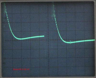

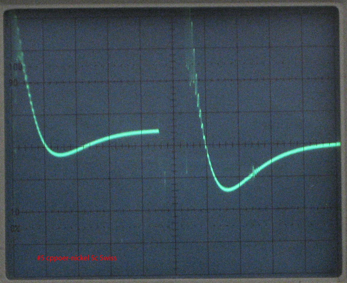

    Can the IB-PI tell the difference between metals?
    I started a new thread for this test series, because the gain and settings are not exactly the same as the other test series.

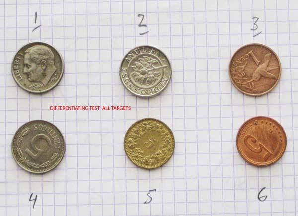

    Here are six coins of very similar size, but made of different alloys.
    The pictures show the signal during TX ON to the left and after Switch OFF to the right.
    Looking only at the signal after the switch OFF, does not tell much more than amplitude.
    Looking at the signal during TX ON, also shows FE, the signal goes positive but also shows differences between non-FE alloys.
    First picture: DIFFERENTIATING TEST ALL TARGETS
    #1 Copper-Nickel-US$-10c-Dime

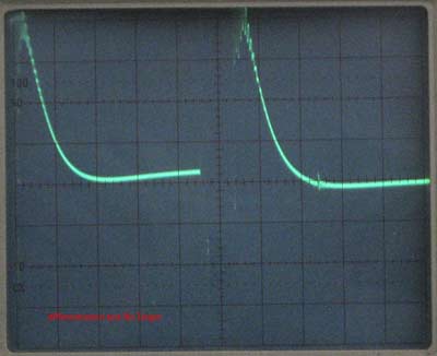

    Ooops, forgot to post the NO Target picture. So here it comes.
    Differentiating Test No Target
    And then #2. This coin looks like Nickel on the outside, but you can see that the signal to the left has gone positive, so there must be a FE core. Indeed, it does stick slightly to a magnet.
    Tinkerer

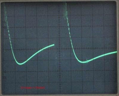

      Target # 3 is a copper coin, 1c from Trinidad Tobago. Looks like a straight forward copper coin.

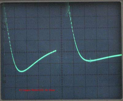

        Target # 4, an old Venezuelan 5c coin. It looks like Nickel on the outside, but it sticks to a magnet.
        You can also see the FE content on the left signal response.
        Tinkerer

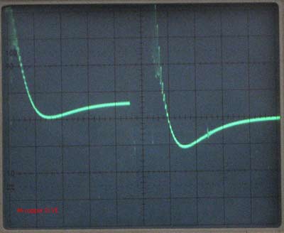

          The last one of this series.
          # 6 is a modern 5c from Venezuela. It looks like copper on the outside, but it sticks to a magnet. You can also note the FE content on the left signal trace.
          Tinkerer

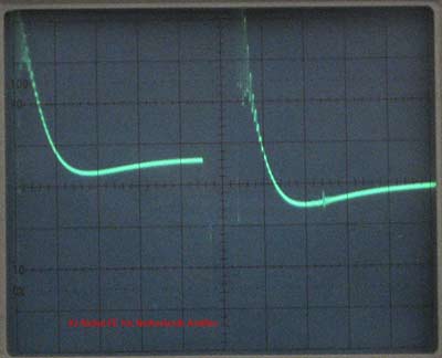

            Goofed up.
            Here is # 5 It is a 5c coin from Switzerland. I don't know what the alloy is, but probably it is copper and nickel.
            So that completes the series. You be the judge. Does the IB-PI tell the difference between the coins of similar size?
