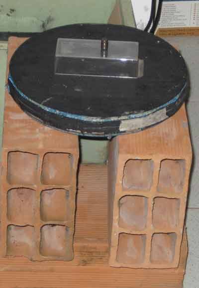

    The first pix shows the DD coil, sitting on some red clay bricks. On the coil is a transparent plastic box and on the box a steel lug.

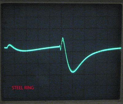

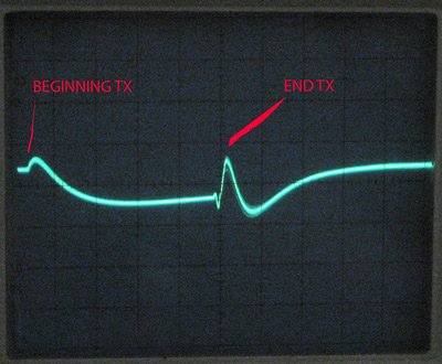

    The second pix shows the scope with the TX and RX and no target. The TX is about 90uS. The response appears during TX and after TX off. Observe how different the response is to the different targets.

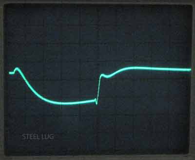

    The third pix shows the response of the steel lug.

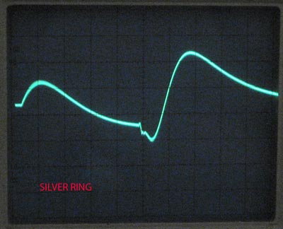

    The fourth pix shows the response of a 0.55gram silver ring.
    The fifth pix shows the response of the steel ring.

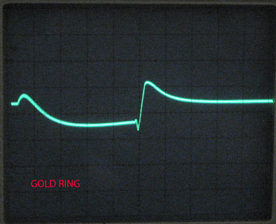

    The last pix shows the response of a 0.5gram gold ring.
    The silver and gold rings are nearly the same weight, but, since gold has a specific gravity of about 19 and silver has about 11, the size is different.
    The hight of the plastic box is about 30mm, so the targets are close to the coil to make the signal amplitude visible to the eye.

        #7 the last one is our steel lug again. It has a TC of more than 90uS and its response is negative, (saturating the preamp) while all the non ferrous targets gave a positive response.

              The scope shots show the TX pulse with a duration of about 90uS, of the TINKERERS_V1 with a DD coil.
              The coil is sitting on red clay bricks to simulate magnetic soil, therefore there is the response of the clay bricks as the basic "no target" picture.
              Any signal thereafter is the change produced by a target, while under the influence of the magnetic response of the clay bricks.
