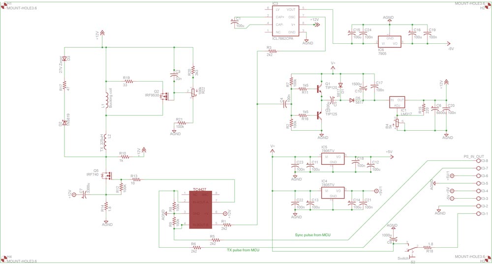

    Here is the TX&PS for the 'TWO TAU METHOD"
    Does it look a lot different from a traditional PI?
    But the signal response amplitude is about 10 times higher.
    And guess what, I can sample at 1uS after TX switch OFF.
    Definitely "NEW AND IMPROVED"

      NEW METHOD TX&PS
      OK here we go again. The TX&PS schematic.
      Tinkerer

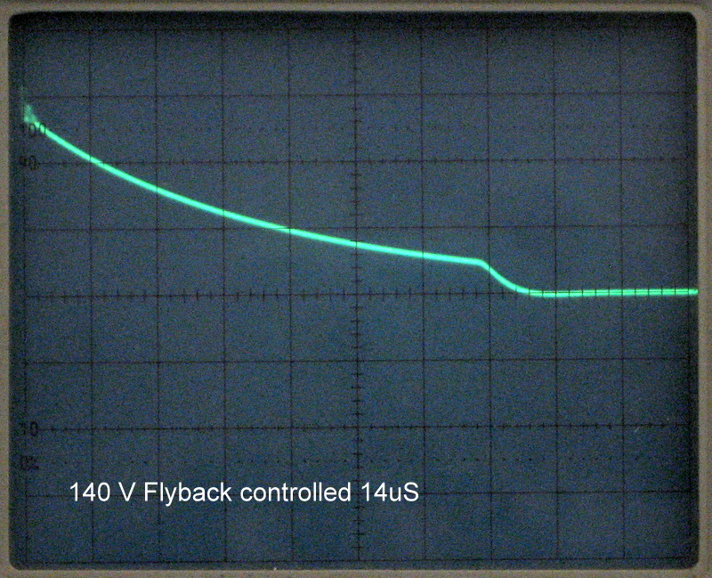

        Controlled Flyback in the "TWO TAU METHOD"
        In the schematic, we see D2, R17, D3. These components control the Flyback.
        Traditional PI tries to get the shortest possible Flyback decay. So the flyback is pushed as high as possible, usually all the way through the avalanche diode of the Mosfet. The energy is turned into heat. Gone up in smoke so to say.
        Often this is several mJoules of energy.
        The "TWO TAU METHOD" TAKES THIS ENERGY AND MAKES USE OF IT.
        The CRO picture shows the resulting Flyback. It peaks around 140V, slowly slopes to 27V and then decays the traditional way.
        What is the advantage? Look at the pictures at the following post.
        http://www.geotech1.com/forums/showthread.php?t=15441
        These sampling windows are taken during the controlled Flyback.
        Not only we have a very high signal amplitude, (the amplification is not much at all), but we also have FE discrimination as well as information about the TC of the target.
        Amazing what 3 passive components can do!!!!!!!!!!!!!!!!!!

                Aziz, thank you for the calculations. You also postulated the base for another good idea.
                Multiple Flyback Voltage Limitting Periods (more than two): I twist your words a bit and make it VARIABLE Flyback Voltage Limitting Periods
                The Zener D3 blocks the Flyback discharge until it reaches 27V. Then it opens until the voltage has fallen to 27 volts.
                R10 then discharges the remainder of the energy stored in the coil.
                I have tried to use a Mosfet avalanche diode of higher voltage instead the Zener. The Mosfet has a heatsink and is better equipped to handle the high power.
                However, the Mosfets that I tried had noisy avalanche diodes.
                But, if we use the Mosfet as a switched variable resistor, we can control it with a MCU or the FPGA and produce nearly infinitely variable Flyback voltage Limiting Periods.
                For this we need to chose a Mosfet that has the voltage handling capacity and low noise.
                We use soft switching to avoid high switching noise.
                What do you think of it?
                Tinkerer

                    The way i see it R17 is in parallel with R10 while the flyback is above 27v, R10 is`nt doing anything resulting in R17 and D3 getting hot with higher coil currents because there doing all the work.
                    Try connecting D2,D3 and R17 to -VB there by forming a voltage divider and spread the resistance a bit more evenly to share the load,also it may help to put a diode on the drain of the transmit fet.

                      TWO TAU METHOD
                      The decay of the coil current at switch off on the m/lab machines is linear.
                      But putting that aside the build up of coil current when the transmit starts can also be linear but at a slower rate so in effect you would have two frequencys resulting from the build up and decay of the coil current during one transmit.Modifying the relationship of the two would be a better alternative than changing the duration of the flyback alone.
                      Hmmm i should put this in a provisional patent.
                      It would be interesting to see if the reactive component of the ground could be subtracted out in the process while leaving the target signal intact.
                      Zed
                      Hi Zed,
                      thanks for the feedback.
                      Aziz and you are both right in that there is a thermal problem when the stored energy goes higher than a few mJoules.
                      The circuit is to show the principle. I can assure you that the response is beyond anything you can imagine.
                      Look at the posts at....http://www.geotech1.com/forums/showthread.php?t=15441
                      There you can see that this is not just an untested idea.
                      These tests were made with this circuit. Look at the signal amplitude (the gain factor is mentioned) and the discrimination. Have you ever seen anything like that with a traditional PI?
                      Now, to use a TX pulse of 10 Amps, this circuit would not function. Changes have to be made to account for the high power.
                      What is the function of R10?
                      It is the damping resistor. It is critical to the damping. More means oscillations. Less means a long decay. At 1k Ohm it is just right for the amount of mJouls it needs to discharge.
                      Ah, why does it go the the +12V? this way the power that is not dissipated in heat, charges the battery. Not really important.
                      Another reason is that, with the differential input of the preamp, I do not use the 12V rail as ground for the preamp.
                      Now, what are D2, D3, R17 for? This is what produces the second TX of the cycle.
                      The TWO TAU METHOD. 2 different TX in one cycle. 2 TX with different di/dt, therefore each TX optimally excites targets of different TC's.
                      One TX is negative going. It has a relative slow di/dt, or rate of change. The other TX is positive going, it has a much faster di/dt. A lot of power in few uSeconds. A fast or high rate of change.
                      But at the same time slow enough to produce deep going eddy currents in large targets.
                      As I mentioned above, just 3 little passive components give powerful results.
                      Please bring more questions. It gives me a reason to explain.

                          Yes i have seen the results of sampling during the flyback with my own experiments,see crow shots below,they have been posted before in other threads.Signals taken directly of the coil.
                          coil current constant after initial rise and then switch off,3 amps.
                          http://i220.photobucket.com/albums/d...ntwaveform.jpg
                          Target signal during transmit and during flyback,signal decays while coil current is constant.
                          http://i220.photobucket.com/albums/d...setocoil-1.jpg
                          The two scope shots are the result of two different experiments.
                          Zed
                              Zed
