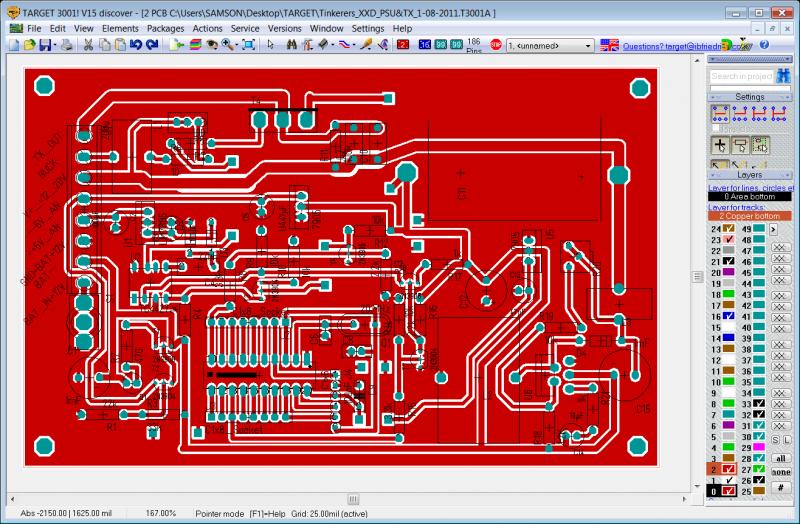

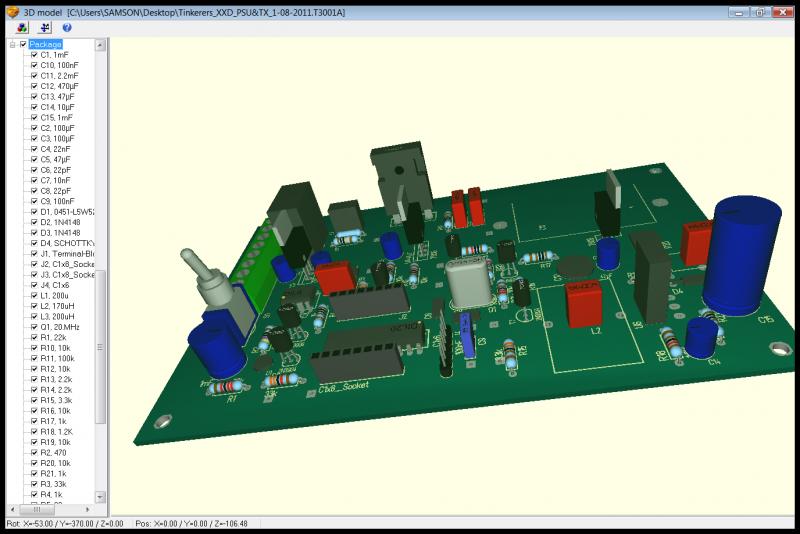

    TINKERER_XXD_DISCRIMINATING PCB
    I am still learning how to use this CAD software.
    Here is a screen shot of the PCB. Single sided.
    Tinkerer

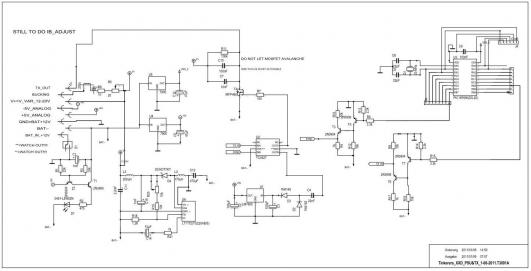

                Hi Tinkerer,
                there is no need for a mono coil design. The IB configuration can compensate the losses and has some superior benefits over a mono coil design.
                Good to see, you have removed all the resistors in the LC tank path. The 100k resistor does not contribute much to the losses.

                  Thanks for the feedback.
                  Your help with the LC tank has been very valuable. Your help is much appreciated.
                  I find the IB configuration combined with the differential amplifier does an excellent job. But people keep asking for a mono coil design.
                  The 100k resistor is more of a place holder. Maybe it will help to reduce some of the Mosfet switching noise. There are probably better Mosfets available than the one I use, but I don't know how to chose the parameters for low switching noise at 5A coil current.

                    Hi Tinkerer,
                    one of the benefit of using a differential front-end is the following:
                    You can quickly change the configuration into an anti-interference coil design, which will gain 20-30 dB more SNR.
                    Just try this:
                    Make an exact copy of the receive coil (same parameters, same geometry, same inductivity, same resistance, etc. but both "receive" coils operated without center-tap = two mono receive coils). Put the new coil 1 meter apart from the receive coil and feed it with the correct signal polarity to the other differential input (change winding orientation if necessary) . So any EMI picking from the receive coil is cancelled from the other coil.
                    You can also fine balance the IB coil configuration, if you move the other coil closer or farther from the receive coil. To get more depth, the EMI cancelling coil should be as far as possible of course.
                    I am not joking. Just try it. This will surprise you, if you can cancel most of the common mode EMI noise (inductively coupled EM noise).

                              The TINKERERS_XXD coil (500mm OD, about 300uH, is made of a TX coil of low DC resistance, anywhere below 500mOhm will do, including the cable. At present I am using 16 Turns of #14 AWG solid wire, in a tight bundle and 3 legs of #14 AWG multi strand wire, hand twisted, for the feed cable. The third leg is for the Bucking coil, 4 Turns 4x#19AWG magnet wire, laid on the RX coil.
                              This crude setup gives me the results mentioned above, even inside the house, with re-bars in the concrete walls, floor and ceiling and all sorts of equipment, large freezer, computer, fluorescent lights etc. running less than 10 feet from the coil.
                              Ah, the RX coil is 250mm ID, 22 turns of #26 AWG magnet wire, center tapped. The leeds, A, B and ground are #22AWG, solid, hand twisted.
                              Shielding is graphite composition home made paint.
                              So, yes, there is definitely room for improvement. Litz wire would reduce the partial response signal of the eddy currents generated in the solid wire of the coil.
