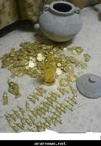

                              you will come Tinkerer
                              and about gold nuggets we didnt have it here as a large pieces
                              Studies have been conducted by jordanian Natural Resources Authority in the Southern of jordan thay find Visible gold In several samples of heavy metals reached 40 g / t, and also reached some of the samples to 5 g / t .
                              The most of peple in middle east interested in old coins That are sometimes buried of several meters .
                              I do not know if I can get help to get metal detector scheme detects deep meters or if you can give me advise in this regard.
