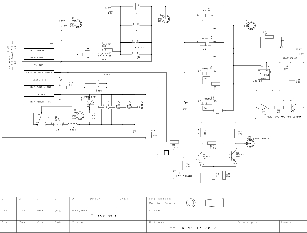

    Below is the TX schematic again, as a reminder how it looks.

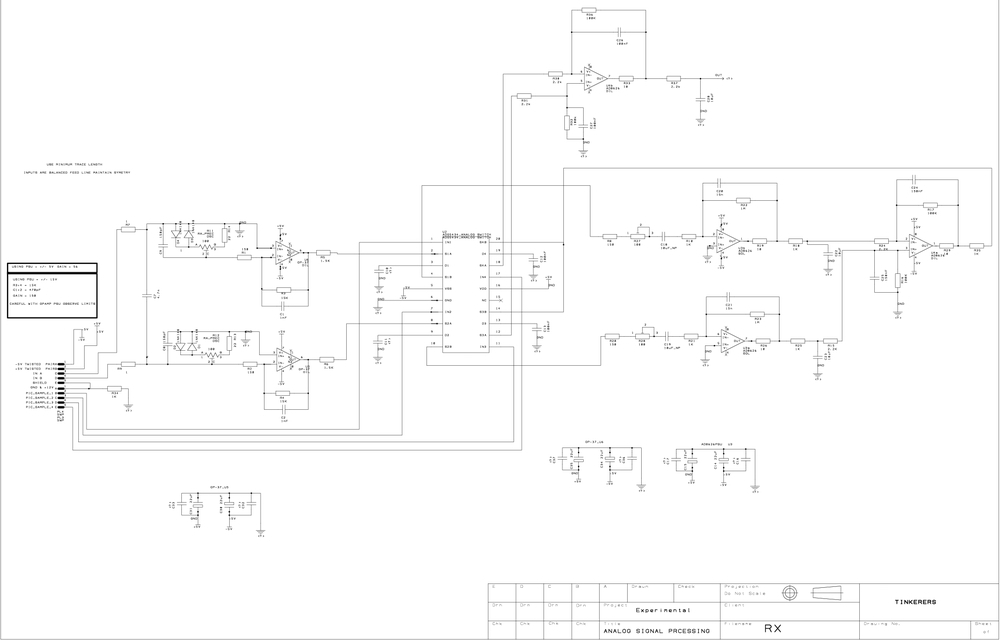

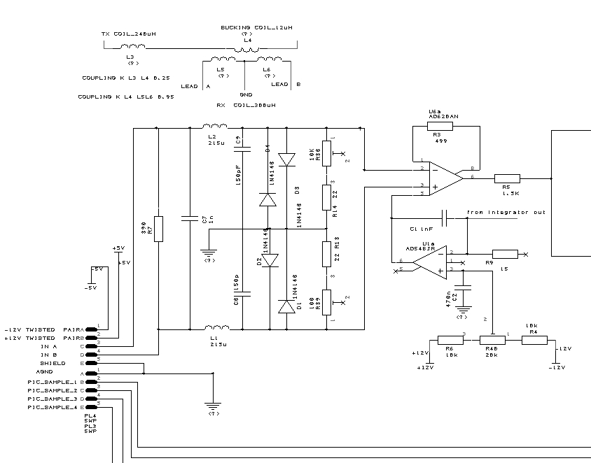

    Then we have an old analog schematic, as an example of what we could do and to give some points of reference.

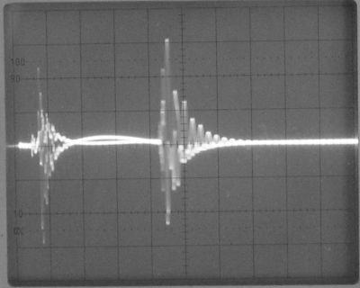

    The raw signal at the input

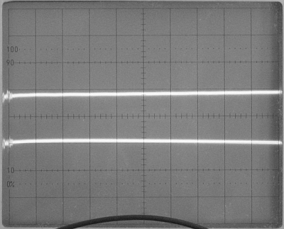

    And here comes the screen shot of the signal, as it comes to the input, raw. NO TARGET
    Hmm, a bit of a mess. Well, as I said, it is raw. And it is a very noisy environment. And there is all sorts of clutter, like 2 mains cables and a UPS touching the coil and the coil is sitting on the floor with a re-bar mesh just 3 inches below the coil. sorry, I have not much space and the coil measures 1m x 0.5m so we just have to take it as it comes.

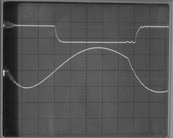

    The scope settings are 2V div. and 2us div. And where is the target supposed to turn up?

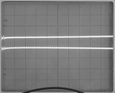

    OK, the second picture shows a target on the coil. Yes, something moved. We can see an offset between lead a and lead b. The RX coil is a center tapped coil, by the way.
    At least we know that the TX works and that the RX is capable of picking up a target.
    Now, what is the first step? You can look at the RX schematics above, how I did it last time. It worked quite fine.
    This time I want to do it better.
    Any suggestions?

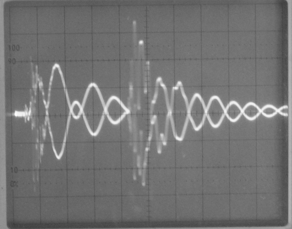

          Damping the RX

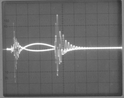

          The first thing to do is to damp the RX coils. As we see in the pictures below, this makes things look a bit better.

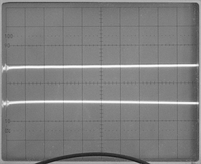

          First picture, The signal, with the damping resistor, NO target.
          The scope settings are still the same, 2V/div. and 2us/div.

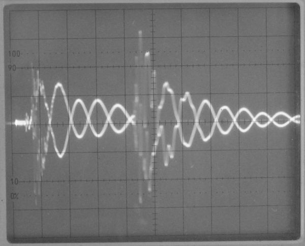

          Of course we need to make sure that we do not eliminate the target signal when tampering with the input, so the second picture shows the signal with a target. OK, the target is still there.
          But what is this other noise? Switching noise at switch ON and at switch OFF. We want to get rid of some of that noise before we amplify the signal, or it will saturate the opamp.
          So the next step is some passive filtering.
          Any suggestions? Good ideas??????????

              Yes, the signal of most IB-PI look a bit like that. The Flyback has been eliminated by the Bucking coil or the overlap of the 2 coils in the case of a DD coil assembly.
              However, as precise as the induction balance may be, there is always some residual left.
              If we look at the pictures above, we see some HF noise. If we were to amplify this signal as is, by the usual 1000 times, we would grossly saturate the opamp.
              Once we have saturation, the amplification is not linear anymore. The opamp also takes some time to come out of saturation. We end up with a very distorted remnant of the original signal.
              The usual method is to clamp the signal with 2 fast switching diodes. This truncated signal has lost most of the information it contained.
              So we want to do it differently.
              In my sample circuit, above there are diodes too. But the only function of these diodes is to protect the input from overload during the balancing procedure when building the coil, or if something goes wrong. The signal amplitude is kept below the conducting level of the diodes at all times.
              With the 1m x 0.5m coil, we will not be searching for very small targets. Therefore, we can low-pass filter the signal with a Fo of about 150k. This will greatly reduce the HF noise we see.
              Now, what is the best filter design for this purpose? This is where I hope to get some help.
              In my trials, I have found that the filter can drastically reduce my target signal, but I have not come to understand exactly why.
              In the above circuit, I use single opamps and limit the bandwidth with a feedback capacitor. the result is quite OK.
              With the new design I want to use an Instrumentation Amplifier. I can not add a feedback capacitor, therefore I want to filter the signal before the InA.
              Then there is also the choice of InA. I have some AD620's, but the the slew rate and the bandwidth is very low at 120kHz with the gain at 100. The gain of 100 is OK for this purpose, so we are not too far off.
              A bit better is the SSM2019, with 200kHz at G 100. This will do. But I am sure there are still better choices available.
              Any ideas????
              Suggestions????
              Below is the first part of the new circuit. The filter is far from good. Any help would be appreciated.
              I added the TX-BU-RX coil configuration to give an idea how the whole front-end looks like.
              Tinkerer
