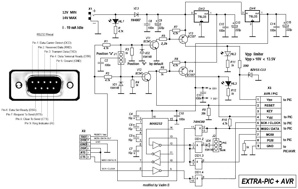

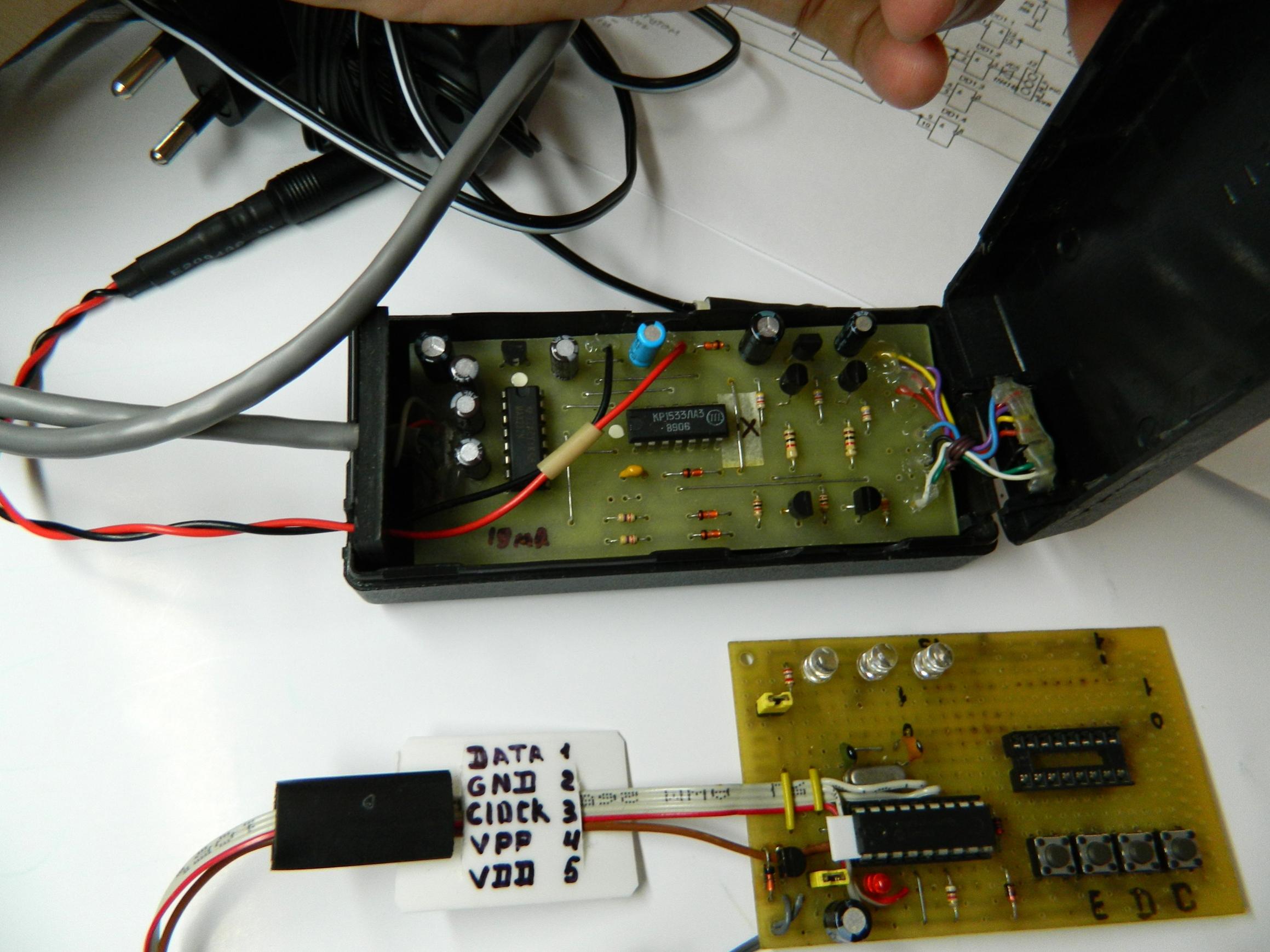

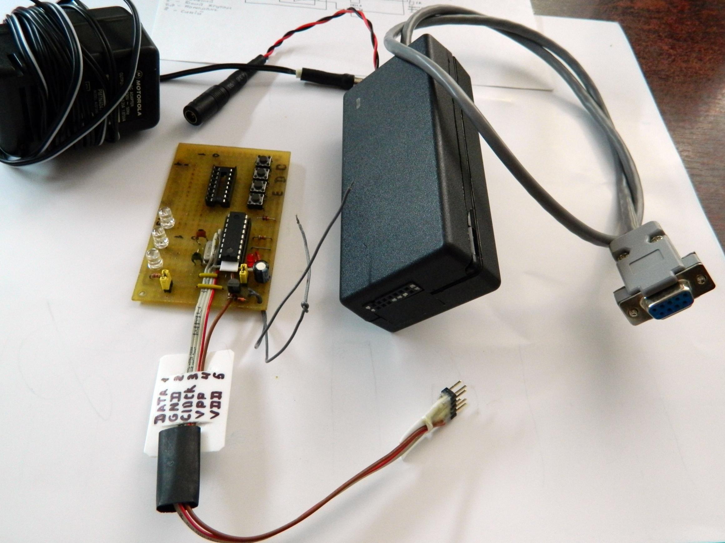

                Here is another solution - Extra PIC+AVR JDM programmer. I build this programmer last year and apply some modifications, work fine for me.
                This circuit designed in 2006, originated somewhere in deep eastern Europe.
                I recomend PICpgm software.
                Circuit Click image for larger version

                Foto Click image for larger version
ID:	361754 Click image for larger version
